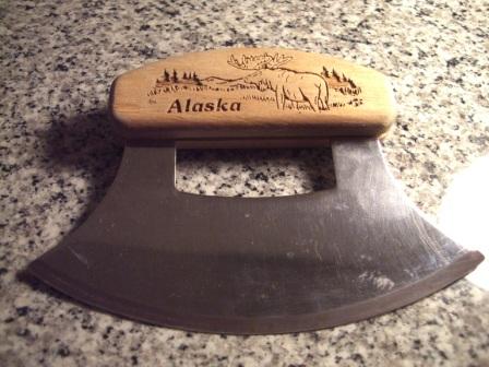

	Thanks for the reply Rayban. Until I started using this I was using a utility knife and a pair of the heavy duty shears. Mainly I have been using this for straight cuts, and the shears for any more intricate work. I still want a head knife, but this seems to be working well right now. I was just curious if anyone else used one.

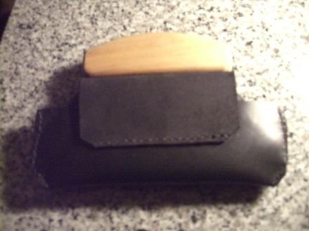

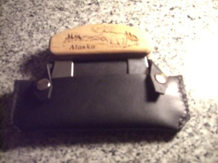

	I am still getting my collection of leatherworking tools to a respectable level, and have not purchased a head knife yet. After seeing one used last week, I really would like to get one, but funds are a little tight right now. I have an Ulu knife that someone gave me 15 years ago as after they visited Alaska. It has been being banged around in the knife drawer for all that time, and was dull as all get out. I spent about 45 minutes getting a good edge on it, and have really been impressed with it. First picture is the knife, other two are of a quick and dirty sheath I made for it today when I realized that combining a razor sharp knife, a roll of hides in the arms, and a clumsy man on stairs is just asking for trouble... So does anyone else use one of these for leatherwork? The blade was only beveled on one side, but I sharpened it from both. Any reason it would not be a good knife to use?

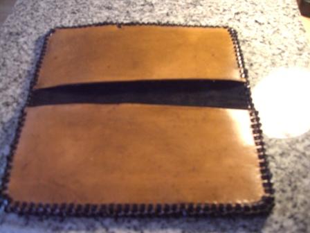

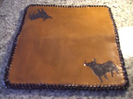

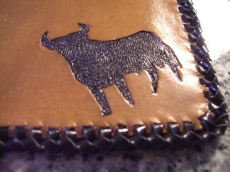

	This is for my wife. She asked for a very simple design of the "Bullboards" in Spain. I actually think it came out pretty well, but see lots of room for improvment. This was made from scaps from other projects. Firsts in this project: Pigskin lining, Double Cordovan lacing, striping as much of the dye as possible off, and re-dying because of streaks. I also had some challanges with getting backgrounder to fit into little spaces and coming out even, and holes breaking because they were punched too close to the edge of the leather.
