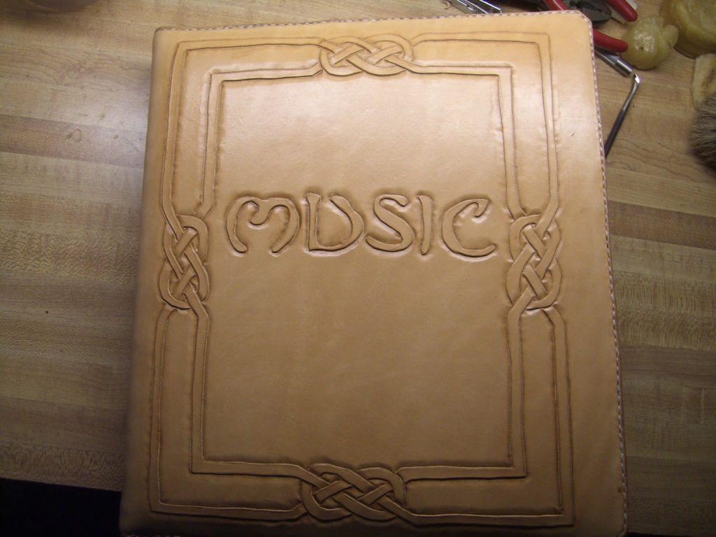

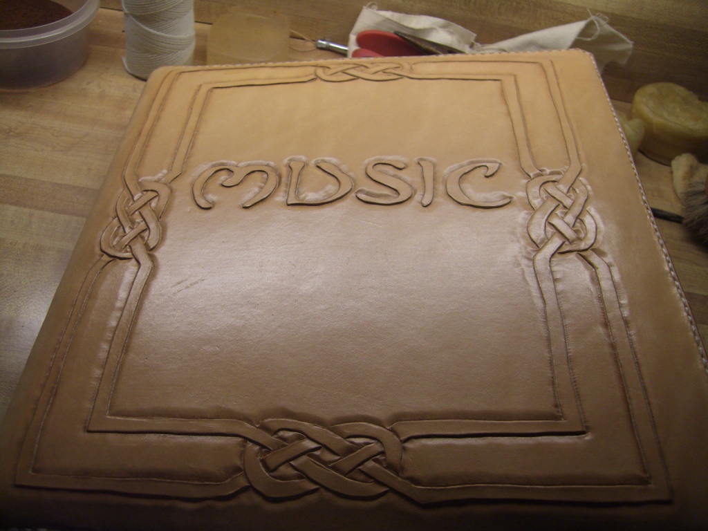

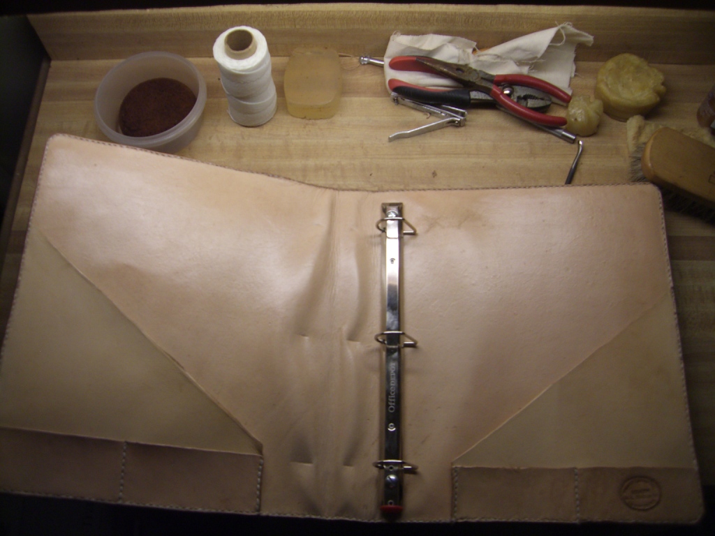

I hadn't seen the reply on this thread. This is an 8x5 three ring binder from Office Depot. I drilled out the rivets holding the rings to the binder, and glued foam backed cloth (like they use in automotive headliners) to the front. I glued the leather front and back to, and sewed the edges. The only down side, is that the binder is really stiff when you fold it over. It should loosen up with use though.

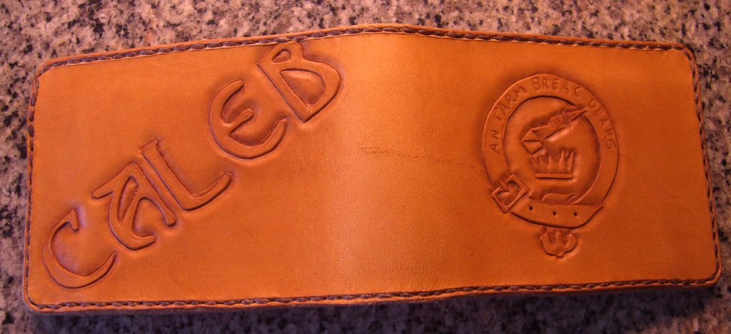

This is a gift for my nephew, who is just finding out about all the cool family history. The design for the wallet is mine. I tried something different on this piece, and mixed dye into the oil. This made the color consistant, and very easy to apply. The only down side with dying this way, is that different hides absorb oil differntly, so the guts for the wallet are not all the same color. Feedback welcome.

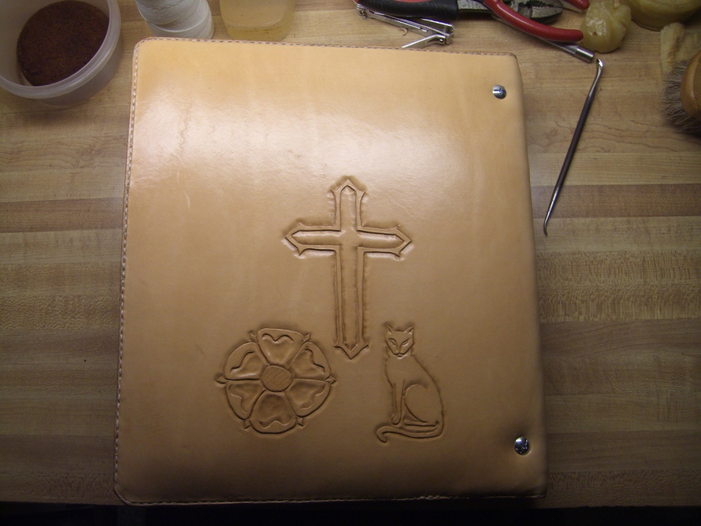

One of my coworkers liked my portfolio I use at work, and asked about making this. The celtic frame design is based on a design from a Leathercrafters and Saddlers Journal a few years back. Customer requested the items on the back, and I came up with the designs. I know that pricing is a sticky subject, but I think I am off on my pricing. I would be interested in PMs on what you would charge someone for something like this. Any thoughts or suggestions for improvement are also welcome.

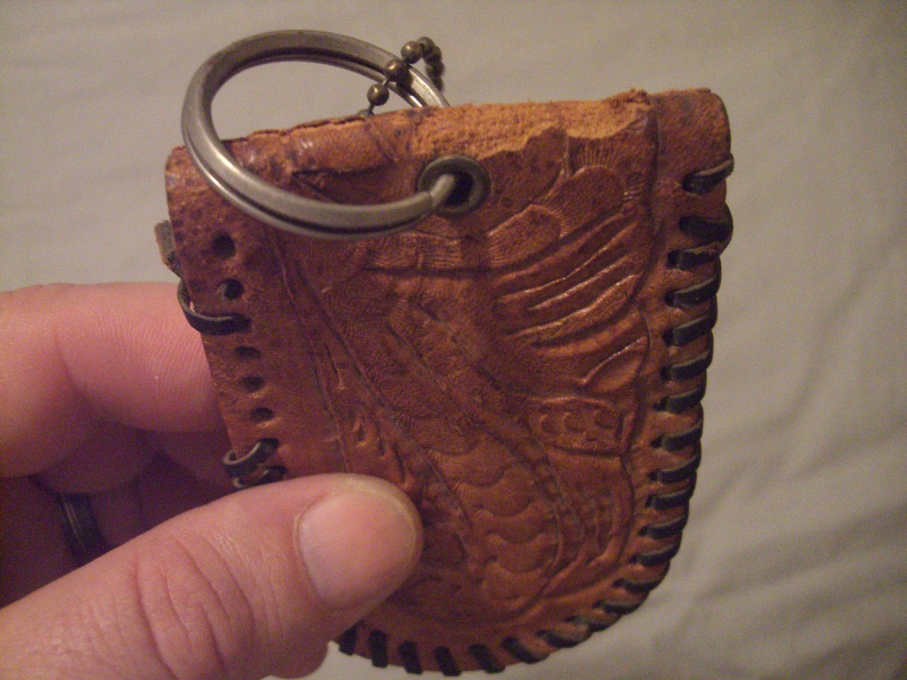

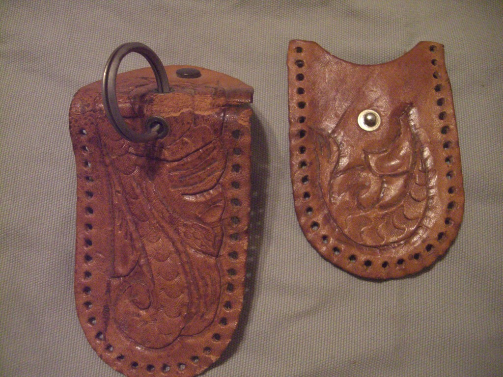

I took some pictures of it, and took the lacing out. The leather is in worse shape than I thought. The lacing just turned to dust when I pulled it. I was afraid to try and take the key ring out. Both pieces are currently in a ziplock that has been filled up with Lexol. I will check it again next week.

I was cleaning out a box this weekend, and I found a key chain thing I had made for my Grandfather as part of my Leatherworking merit badge about 25 years ago. It had hung in an outdoor shed in Phoenix, AZ for at least 20 years, so the leather is very dry, and the lacing is dryrotted. Right now, I am afraid to even open the snap because the leather is so dry. What conditioner should I use on this? I would like to re lace it, and keep it around.
