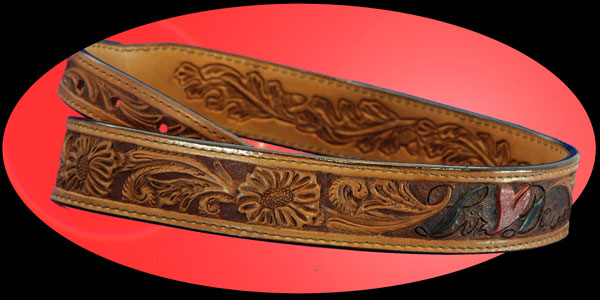

Valentines day belt
David Genadek replied to David Genadek's topic in Purses, Wallets, Belts and Miscellaneous Pocket Items
Thanks Tom, I'm not sure what a rod tube handle is but adding a bit of tooling to a lining always adds a touch of class but you have to watch the price too. I did carved grips for Goldwings a long time ago it was a bit of a challange to figure out how to sew a tube on a Campbell Bosworth machine but I did get it to work. David Genadek -
