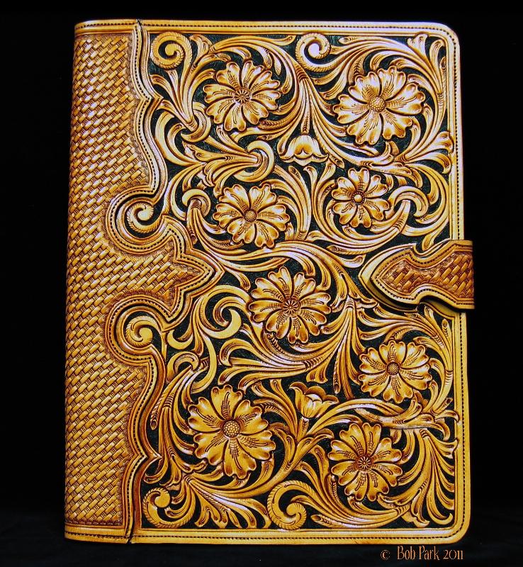

Just finished this full size pad folio. Made in three pieces from 6/7 HO with stiffeners in the leaves, The interior is made from 2/3 oz kip. All sewing is with 69 thread @ 11 stitches per inch. All critiques and comments are welcomed!

It's just beautiful Bob. I really like the the way you work the profile design of the spine and even the profile of the snap flap into the cover design. And there is a real sense of fun in the way your leaves and stems intertwine with each other. And the carving on the interior is exceptional. I also appreciate you telling us the weight of the leather, etc. Could you also share what you've done for the finish...dye color, antique color, finish? Your work is a real inspiration. Thanks for posting.

As always Bob, incredible work!! The flow of your flowers, leaves and stems are perfect. Love the "finger cut" scroll work inside. The attention to details you put into a piece is "first class"!!
I have a couple questions;
What materials are you using for your antique? I am sure a lot of color is burnishing in your tooling but the rest of the leather has a rich tone to it that is beatiful!
And second; Does having the stitches so close together (11 per inch) weaken the seam? It must be working for you or you would not do it. I have always read that if they are to close in leather that it will make the seam rip like perferated paper?
Your work is an inspiration and I have always admired it from when you started posting here on LW. You have always been very generious with sharing your techniques and we all appreciate the time you take to share.
Thanks for posting,
Rick J.
Thanks for posting,
Rick J.

I use Fiebings paste antique and I use NeatLac as a resist and a final finish. On the sewing what you were told is correct and so you have to keep that in mind. I prefer the look of the finer thread and closer spacing. In this case I am using a very light thread on a pretty small needle. Also there is no stress anywhere on any of the seams. You wouldn't sew a stirrup leather onto a fender this way though, LOL!
