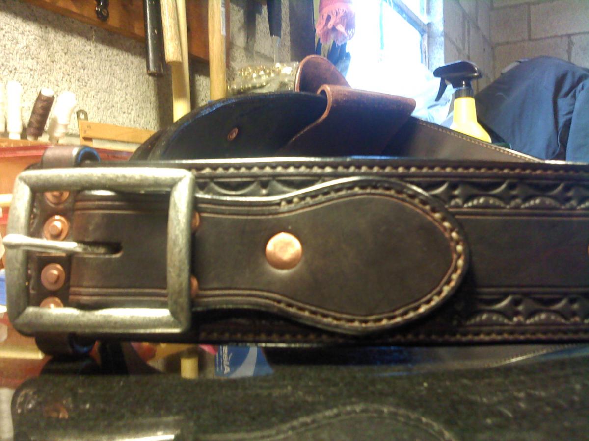

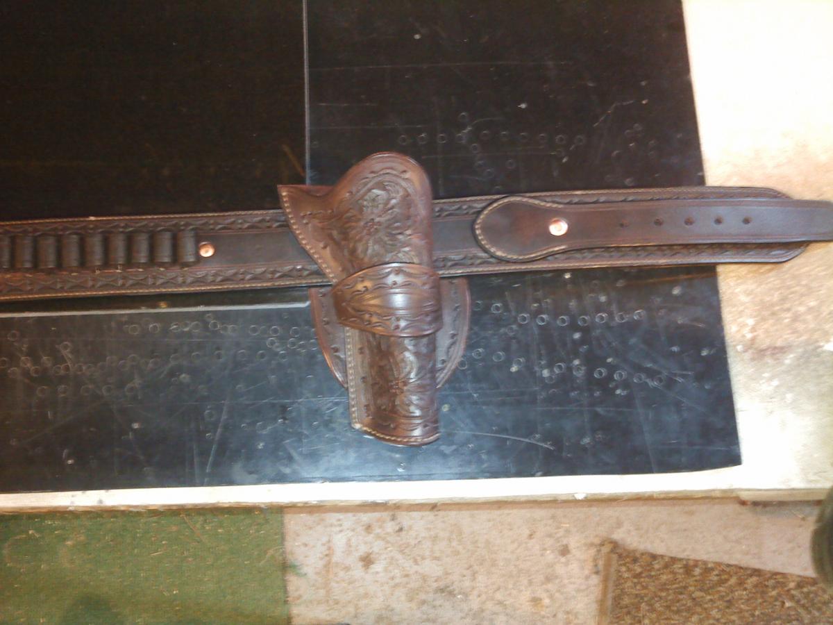

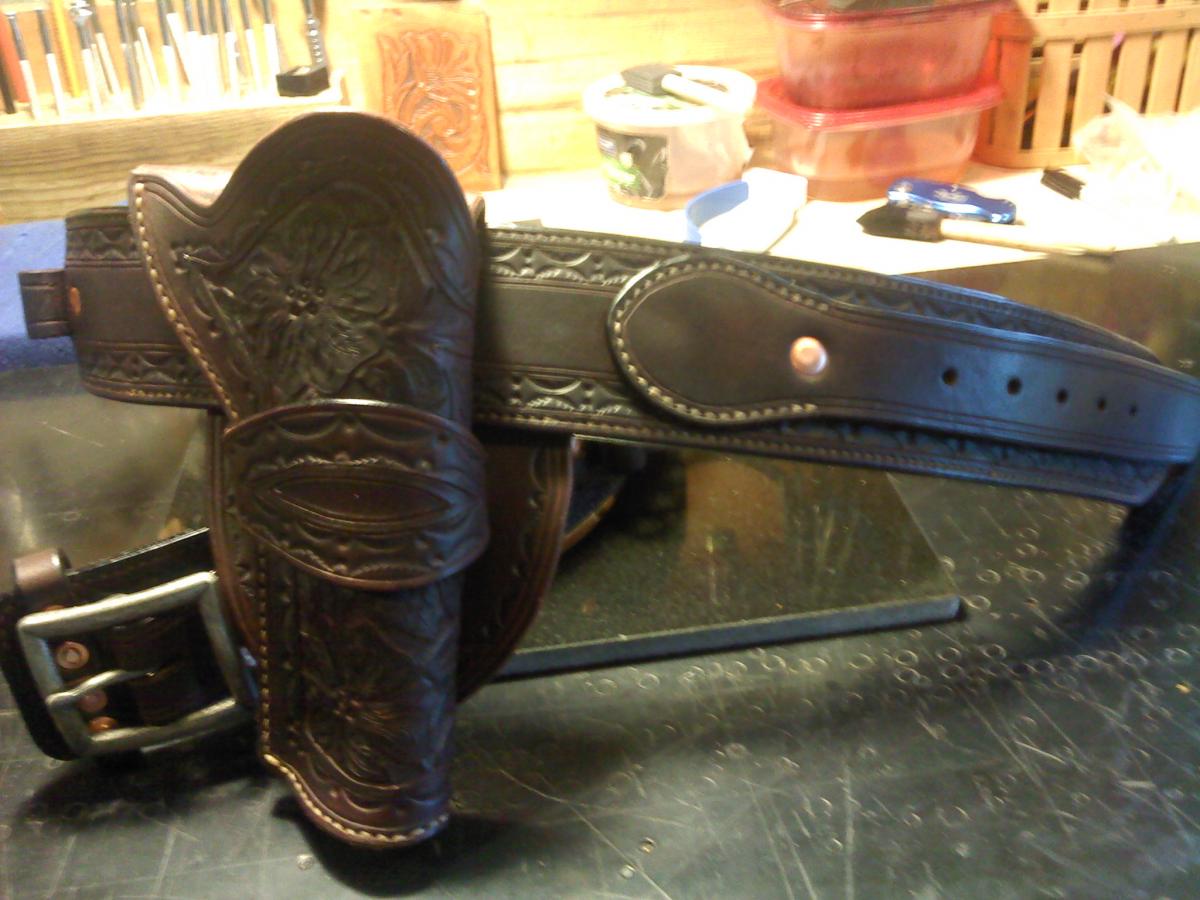

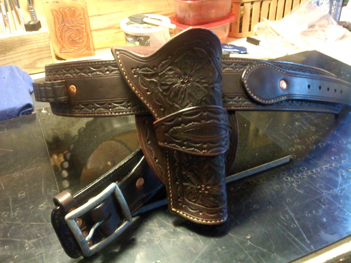

Members keplerts Posted June 17, 2013 Members Report Posted June 17, 2013 (edited) This is my first attempt at a gun holster and belt. I used the Hand of God pattern from Will Ghormley. The holster is 9-10oz leather and the belt is 9-10oz but I lined the back with 4-5oz. I know the pattern did not call for it to be lined but I thought I'd give it a try. The dye is mohogeny. Everything was hand sewn. I think the hardest part was sewing in the toe plug. The pics are not great but all I have is a low end cell phone to use. All your thoughts and pointers are greatly appreciated. Edited June 17, 2013 by keplerts Quote

Members Dwight Posted June 18, 2013 Members Report Posted June 18, 2013 (edited) I would think that Will would be proud of your iteration of his pattern. I only saw one place where I would have done any serious changing, . . . In the picture of the buckle, . . . the belt keeper that goes in back was fastened with 4 copper rivets. I always actually sew mine into the belt itself, because I only make lined belts. The top of the keeper is sewn in with my machine about an inch after I make that turn from end to main run on the belt, . . . and I machine sew all the way around to the other end of the keeper. The second end is hand sewn. The keeper is sewn in between the two layers of the belt. Not to sound overly critical, . . . just pointing out a way to make your final product look a bit cleaner. But all in all, . . . from what my 68 year old eyes could make out, . . . looks good. May God bless, Dwight Edited June 18, 2013 by Dwight Quote

Members keplerts Posted June 18, 2013 Author Members Report Posted June 18, 2013 Thanks everyone for the compliments. Greybeard..... The hand sewing around the edging to sew the lining in took me a little over three hours! Can't afford a machine right now but I do enjoy doing it by hand. I don't think I'll be lining any more by hand unless a "paying" customer wants one Dwight..... about the keeper.....that is a great suggestion! I would have used double capped rivets but the prong was too short after I put the lining on. Right now I did not put a finish/sealer on. What would you guys suggest I put on with out making it "glossy/shiny". Thanks again! Quote
