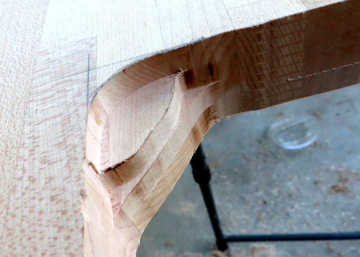

Members thesergeant Posted July 23, 2013 Author Members Report Posted July 23, 2013 (edited) Just wanted to thank everyone once more for their input. Thank you to all of those that steered me away from the IKEA 1" pine and encouraged me to go with a solid hardwood top, I'm really glad I listened to you all and went with it. I picked up my 25"x48"x1.5" maple top last week for $95 out of the door and got to work on it this weekend. Here are a few snap shots for those interested. I'm going to clean up the belt cutout today, route a soft rounded edge all the way around the top and polyurethane it this afternoon. I'm still undecided about the legs but I might weld the old legs back together and use that for the time being. I'll post pics when finished. Thanks again guys! Great community here. Edited July 23, 2013 by thesergeant Quote

Members shtoink Posted July 23, 2013 Members Report Posted July 23, 2013 I'll post pics when finished. I'm liking the way it all turned out. Really clean looking job with cutting out those tabs for supporting the machine while keeping it all flush with the table. This may be a bit on the crazy side, but what about lining the interior surface of the cutout for the sewing machine with a wool felt to act as "dust seal", so to speak. It's help take up any bit of slack with the machines position in the hole and keep bits of stuff (fluff, thread, needles, and so on) from making their way into the groove between the table and the deck of the sewing machine. It would mean that you'd need to take care when dropping the machine in the hole so as to not knock the felt loose, but it does seem feasible and potentially a decent idea. It would give you the opportunity to felt the tabs for protection of the underside of the machine, too. Quote
Trox Posted July 23, 2013 Report Posted July 23, 2013 Just wanted to thank everyone once more for their input. Thank you to all of those that steered me away from the IKEA 1" pine and encouraged me to go with a solid hardwood top, I'm really glad I listened to you all and went with it. I picked up my 25"x48"x1.5" maple top last week for $95 out of the door and got to work on it this weekend. Here are a few snap shots for those interested. I'm going to clean up the belt cutout today, route a soft rounded edge all the way around the top and polyurethane it this afternoon. I'm still undecided about the legs but I might weld the old legs back together and use that for the time being. I'll post pics when finished. Thanks again guys! Great community here. That more like it, very nice. Now you have an industrial quality table your machine deserves. Normally we use some rubber ears the machine bed rests on, to avoid vibrations and such. You can use some furniture knobs instead. A coat with green soap or paint will preserve and protect it. Nice job Tor Quote
Members thesergeant Posted July 23, 2013 Author Members Report Posted July 23, 2013 Thanks for the feedback guys I just finished taking the router to all the edges to put a smooth but subtle rounded edge on all the corners and cleaning up the belt cut out a little more. Going to give it a final sanding before I apply a couple coats of poly to it. Schtoink-- I like your idea about lining the inside with felt to act as a "dust catcher". Very clever. I'll give it a shot with some grey felt and some spray adhesive and see how it works out. Trox, Schtoink -- The original table had leather pads that the machine rested upon. I thought about reusing them but they were pretty thick (>1/4") and thought it was overkill. I'm going to use either some felt of some 1/8" closed cell foam on each of the tabs. I almost forgot about the hinges so I'm going to route those out real quick as well. I took photos of everything at each step so that a first timer could follow along if they wanted to try it for themselves. I'll post a link to that album when I'm completely finished with the project. Quote
