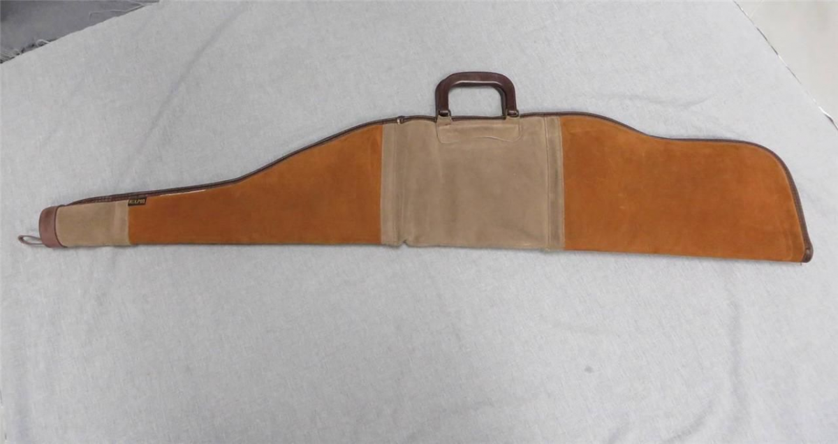

Members johnggrg Posted March 15, 2014 Members Report Posted March 15, 2014 I plan on making a rifle case and had a couple questions. What would be the perfect thickness of leather to use? Second would it be better to make it one piece or 3 pieces. I was thinking 3 piece. That way I wouldn't need a half hide to get the length. Any and all suggestions welcome. Also handle ideas needed. Please let me know. Thank you John Quote

Members Dwight Posted March 15, 2014 Members Report Posted March 15, 2014 Personally, . . . I can't understand the 3 piece part, . . . one piece is how I do them, . . . plus handles if desired. You can add pouches, mag carriers, handles, hanging straps, etc. But the basic rifle case is one piece of leather and either a button for an end opening one, . . . or a zipper for a side opening one. May God bless, Dwight Quote If you can breathe, . . . thank God. If you can read, . . . thank a teacher. If you are reading this in English, . . . thank a veteran. www.dwightsgunleather.com

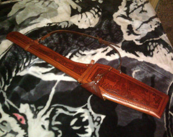

Members camano ridge Posted March 15, 2014 Members Report Posted March 15, 2014 (edited) When you say three piece are you thinking of joining three pieces together to make the rifle case. THe picture below looks like multiple pieces of leather joined together, actualy it is one piece of leather with the tan suede overlaid. You can make a two piece that is essentially a scabbard with a top that attaches as in picture two. Edited March 15, 2014 by camano ridge Quote https://www.facebook.com/CamanoRidgeCustomLeather?fref=ts
Members johnggrg Posted March 16, 2014 Author Members Report Posted March 16, 2014 Oh ok. I thought one like that was 3 pieces good to know didn't know that. Can't remember but I do think I have that book around here somewhere. But would be happy with any tips anyone who has made one can give. Always better to hear from people who have made one. Tips,things to avoid etc. I am making it for my scoped Mauser rifle. John Quote
