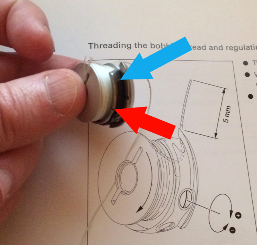

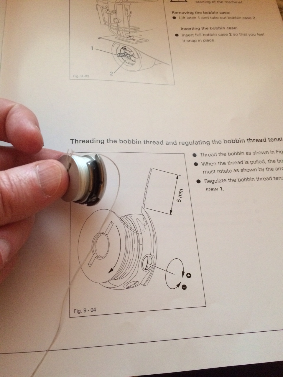

Members Bru Posted March 27, 2016 Members Report Posted March 27, 2016 1 hour ago, Uwe said: The Pfaff 335 Manual actually shows the threading and bobbin loading steps fairly well on pages 23-25. Maybe I'm just not seeing it. I can clearly see how to thread and load the bobbin, but placing the thread inside so that it can catch with the needle thread has been a big problem. For reference, here's the bobbin case next to a pic of the instructions. You can see that the case itself and the pic look nothing alike (in my eyes) which is why I'm confused. Quote
Uwe Posted March 27, 2016 Report Posted March 27, 2016 They really are the same. You need to pull the thread into the slot on the bobbin basket (red arrow) and then pull it to the top so the thread runs under and emerges at the tip of the black tension spring blade (blue arrow). Quote
Hockeymender Posted March 27, 2016 Report Posted March 27, 2016 (edited) Here are a couple photos that may help. The First shows the thread being pulled thru the slot in the bobbin case. The second shows the thread which has been pulled thru the slot pulled UNDER the bobbin tension spring. Install the bobbin case (be sure it "snaps" into place) and cycle the needle. Should pick up the bobbin thread. Edited March 27, 2016 by Hockeymender Quote
Members Bru Posted March 27, 2016 Members Report Posted March 27, 2016 @Uwe @Hockeymender - yes, that did the trick! I tried pulling the thread through the slot before, but I must not have also pulled it under the spring and outside the case when I snapped it into place. Thanks for the diagram and pics - and your patience. It seems so simple now but I just couldn't get it from the instructions. Now, unfortunately, I've got another problem. I can get about two stitches through a single layer of 2mm jenpro before the top thread snaps. I've adjusted the thread tension to it's absolute lowest pressure setting (a few more turns and the nut will fall off), but the thread tension still seems very strong. It's too the point where the needle will bend if I pull the thread with my fingers. Is the tension supposed to be this tight? I am also hearing a slight metal on metal click as the needle descends into the hole, so perhaps I've got a timing issue instead? Would you guys have any suggestions? Thanks again for all of your help. Sometimes I feel like I've bitten off more than I can chew with this machine. So much to learn!! Quote

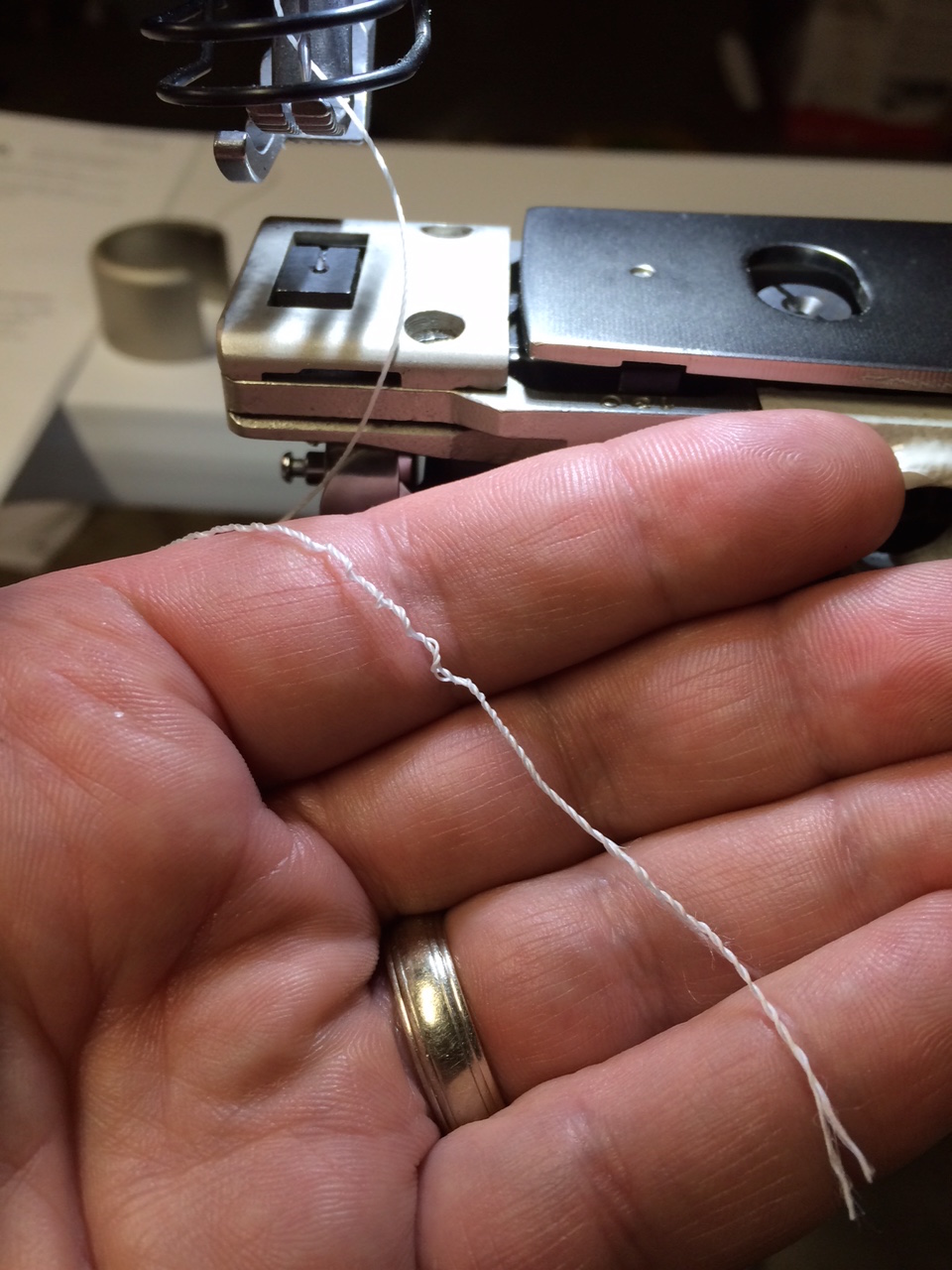

Members Bru Posted March 27, 2016 Members Report Posted March 27, 2016 (edited) This is typically what happens after 2 stitches when turning the wheel by hand & shutting the machine off - the thread starts to unravel and get balled up on the left hand side of the needle. I can't tell if the bobbin thread is unwinding, but it is definitely not getting caught up inside the case. In taking a look at the needle inside the case (with the bobbin out) as it descends down into the hole, everything is fine on the downstroke but it definitely hits metal on the upstroke (towards the "backside" of the machine). Edited March 27, 2016 by Bru Quote
Uwe Posted March 27, 2016 Report Posted March 27, 2016 You're gonna have to find out exactly what metal in the back the needle is hitting (or getting hit by) on the upstroke, because it definitely should not be hitting ANYTHING during the cycle. With the feet raised and the thread removed you should be able to turn the handwheel in a very smooth fashion without any binding or resistance (other than overcoming the spring pressure). There should be NO snapping/grinding/rubbing sounds, just buttery smoothness. Don't force it if you hit resistance. Jog the hand wheel back and forth gently and find out exactly where things touch that shouldn't touch. This may take a flashlight, neck craning, and strong reading glasses (in my case). Once you know what touches, then you can figure out WHY things touch and make an adjustment so they don't touch. When the feet are raised, you should be able to pull the thread through the eye of the needle with little force. I've had the upper thread accidentally wrap around a post/screw/spring or otherwise get hung up. Nothing will work right if the machine can't pull the upper thread when it needs to. It'll deflect the needle, chafe the thread, make the needle hit the feed dog or the hook, and all manner of bad things start happening, especially under motor power. When something bad happens under motor power things may slip, the safety clutch may pop, or other things may bend or otherwise go out of alignment. Quite often it's something simple like threading, seating or changing out the needle, inserting the bobbin properly, etc. If the machine in a totally screwed up state, you need to methodically go through the Pfaff 335 Service Manual and compare should-be settings with your machine's real world settings one by one, in sequence, until you find one that's not as it should be and fix it. Repeat until everything is adjusted as it should be and things move smoothly. Don't loosen screws unless you know what they're for. There's definitely a learning curve with these machines and it can be steep and frustrating. The industrial sewing machines are tough and fragile at the same time. Ultimately there's no way around learning a few basic adjustments yourself unless you want to take the machine to the mechanic at $90+/hr every time some little thing goes wrong. Quote

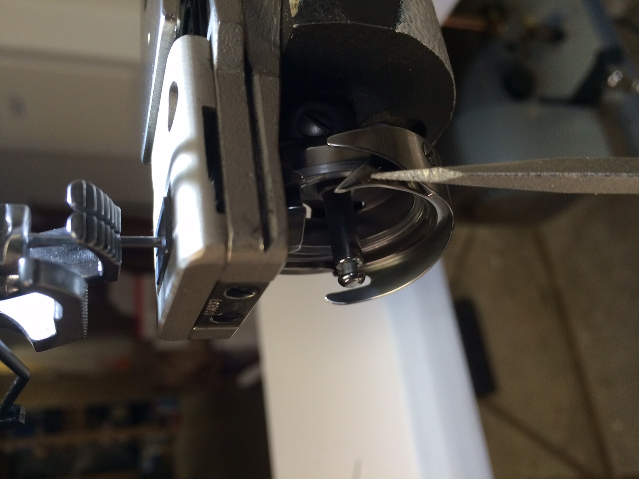

Members Bru Posted March 27, 2016 Members Report Posted March 27, 2016 Thanks Uwe. Upon further inspection, it looks as if a piece of the casing is actually hitting the needle and pushing it backwards as it rotates towards it in a counterclockwise direction (see pic - the blade of the screwdriver is touching the piece that is hitting the needle). Is this the hook? I looks as if this piece also pushes (what I think is) the feed dog slightly upwards as well. Quote
Members SARK9 Posted March 27, 2016 Members Report Posted March 27, 2016 The position of the swivel plate assembly looks a bit odd...it seems to show a large gap above the machine arm, like something may be bent, loose, not assembled correctly, or its getting interfered with from below. -DC Quote
Uwe Posted March 27, 2016 Report Posted March 27, 2016 (edited) That hook part should not be touching the needle or anything else, and the feed dog should NOT be moving up and down (unless you have a special, rare sub-class of the 335). My advice at this point would be to take it to a mechanic to be put back in working order (or take it back to the person who sold it to you). There's too many interconnected things wrong right now to trouble-shoot and talk you through fixing it remotely. It's extremely hard to learn on a machine that is way out of adjustment. You're also likely to cause even more damage as a novice to sewing machines. Once you get the machine back in good working order, have somebody show you the basics of using this machine. Take time to inspect how everything should work/feel/sound and read the user and the service manual front to back and compare the manual's diagrams and descriptions with your machine. THEN hook up the motor again. Edited March 27, 2016 by Uwe Quote
