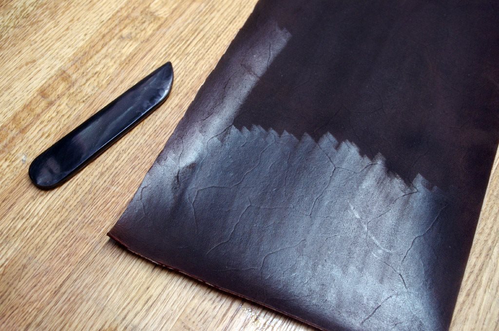

Members asbandr Posted September 7, 2014 Author Members Report Posted September 7, 2014 Sorry, I guess I should include a pic... Quote
Members Dwight Posted September 7, 2014 Members Report Posted September 7, 2014 Pitch the super sheen, . . . go to Resolene, . . . mix it 50/50 with water, . . . play with it enough and you can use it for a mirror practically. It is a far superior finish in just about every way. May God bless, Dwight Quote If you can breathe, . . . thank God. If you can read, . . . thank a teacher. If you are reading this in English, . . . thank a veteran. www.dwightsgunleather.com

Members whipstitchwallets Posted September 8, 2014 Members Report Posted September 8, 2014 are you buffing to a shine before you apply the finish? After the leather for my wallets dry for 24 hours I buff them with cotton rag untill they sparkle, nothing added at all. I actually apply mink oil to tone it down to a warm glow. I wonder if you're missing this step? Quote
Members Spinner Posted September 8, 2014 Members Report Posted September 8, 2014 ...After the leather for my wallets dry for 24 hours... This is likely the root of the problem Asbandr, most finishes will soak too far in and dilute if your dyes and oils haven't cured/dried well. Let the piece sit for 24 hours after dying and oiling, buff with a rag until it has a slight burnish to it and then apply the finish. The new Super Sheen is garbage but the old version of it (the changed formulas about 3 years ago) was awesome. Resolene, as mentioned is better. For either finish, use a soft cloth and apply a coat that has been cut 50/50 with water. Wait until the surface looks dry (it isn't yet) and apply a second coat. This is the penetrating coat that will close up the pores. Wait a few hours/overnight and apply another thin coat or two. Just like furniture finishes, each time you let it dry overnight it seals the pores a bit more allowing the finish to build. The build up of layers is what will give you the shine, and will last longer than one fast thick coat. Quote Chris Three Mutts Customs Leather - http://www.threemuttscustoms.com
