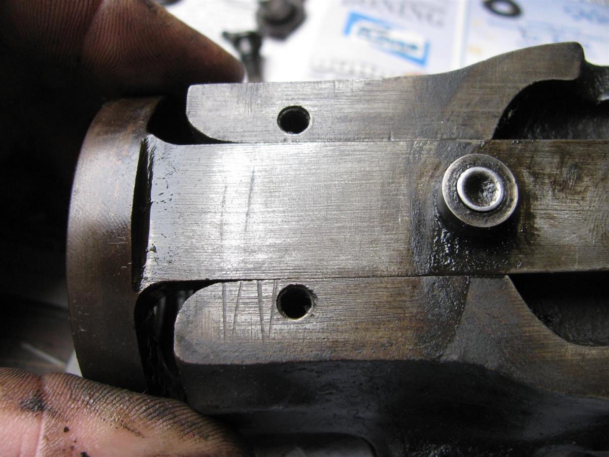

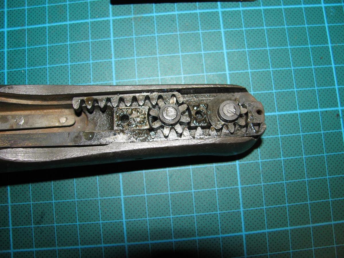

Members Constabulary Posted December 25, 2014 Author Members Report Posted December 25, 2014 Ripped everything apart and checked the wear of the parts. I´m really surprised that the revolving head and the feeding motion ring "thing" still fit very tight and the rollers all look nice. I really have expected much more wear on this "boat anchor" considering how it looked from the outside. I get ~ 7 - 6.5 SPI out of it before cleaning - not very good but could be worst. The bell crank lever thing is quite worn but seems it is the same as in my 29K71 so I will order one. The inside of the motion ring thing does not look worn so I will keep the old one for now and will see how it performs with the new bell crank lever. Next step - parts cleaning - new paint job - order some parts... Merry Christmas Quote

Members Constabulary Posted December 26, 2014 Author Members Report Posted December 26, 2014 @Kidbee Yes, I know it and it is quite impressive what he did but the bell crank lever is just 13.50 GBP at College Sewing and It really seems to be the same as in the 29K71 so for that money I don`t start trial and error with sheet brass. I decided to rip the 29K71 head apart later today and take a closer look at the lever and compare it with the one from 29K1. I think that could be helpful for other folks who want to restore a 29K in the future. The parts # are different but you never know.... Later... Quote

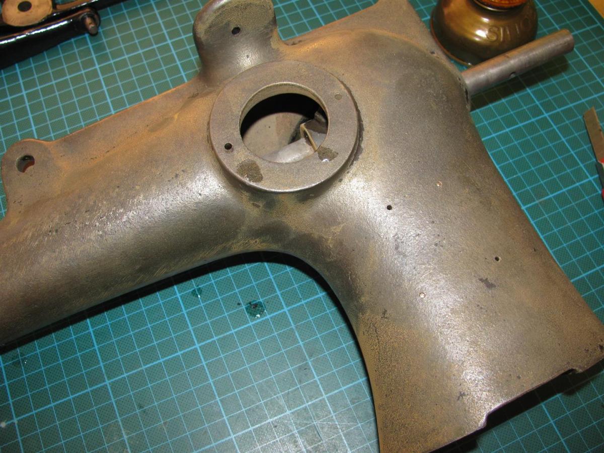

Members Constabulary Posted December 28, 2014 Author Members Report Posted December 28, 2014 (edited) in an other thread I found a nice idea for derusting - electrolysis! Don´t want to make a lot of words - here is the thread the idea came from: http://leatherworker.net/forum/index.php?showtopic=60600#entry391099 And there are a lot of videos on youtube I had top and bottom housing in the electrolysis bath for about 20hrs. The rust is gone and as a side effect it even has removed the paint or it rather crinkled the paint and I was able to remove it with a wire brush w/o much effort. The bottom parts of the housing still is in the electrolysis bath. Only problem (well not really a problem) is that is immediately starts to build some surface rust but thats no big issue and quite normal. Some pictures: Edited December 28, 2014 by Constabulary Quote

Members Constabulary Posted December 29, 2014 Author Members Report Posted December 29, 2014 I just tried the bell crank lever from my 29K71 in the 29K1 and it DOES NOT work - yet! The BCL fits technically but it has to be modified otherwise it is rubbing on the revolving handle and does not feed properly. So I will try to install more 29K71 parts and see what exactly is going on... To be continued..... Quote
Members Constabulary Posted December 29, 2014 Author Members Report Posted December 29, 2014 okay.... I now have installed the revolving handle, the motion ring and the bell crank lever of my 29K71 in the 29K1. All 3 parts fit w/o problem - at least in my case - not sure if this will work on all 29K short arm machines. I now get 6SPI max. out of it WHEN I have almost zero tension on the blade spring but that means that I have not much foot lift and I can sew maybe 3-4mm thick. When I put more tension on the blade spring I have a higher foot lift but the stitches are shorter. So it could be that just a new + modified bell crank lever can do the job. I will order one and will modify it. So in case it works - fine - if not then this project is dead, I don´t want to invest too much money in it. Quote
Members Constabulary Posted January 9, 2015 Author Members Report Posted January 9, 2015 some pictures of the bottom housing. When I polished the name plate I found a different nomenclature on the backside of the tag - pretty interesting (but not overwhelming). I just have ordered the bell crank lever for the 29K71 and will see what I can do with it... Quote
