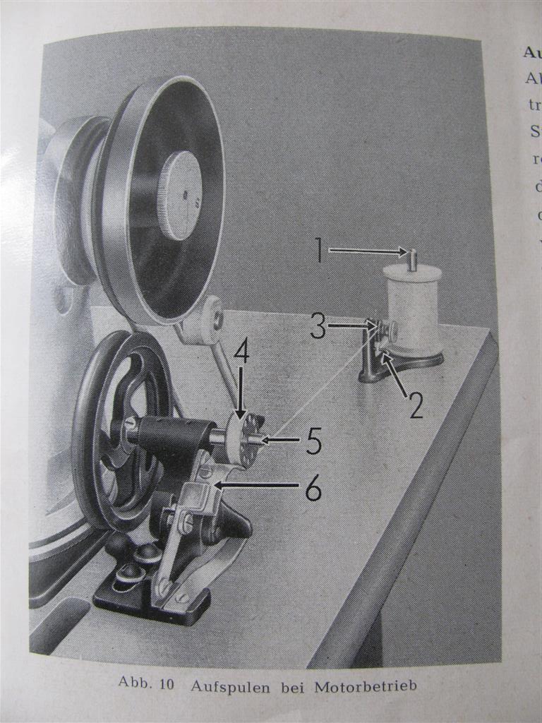

I have no idea what the stem is but I have this: (see attached photo) I guess I can make up something with some washers and spare tensioning spring from the machine....great idea...why didn't I think of that??
How would I thread it though?? Through the tensioning disk...loop it behind the spring and then down through the little loop at the bottom and onto the bobbin?

That parts belongs to the 2-piece bobbin winder - see picture.
if you don´t have the main part I may have one if you are interested... will look for it later today.
