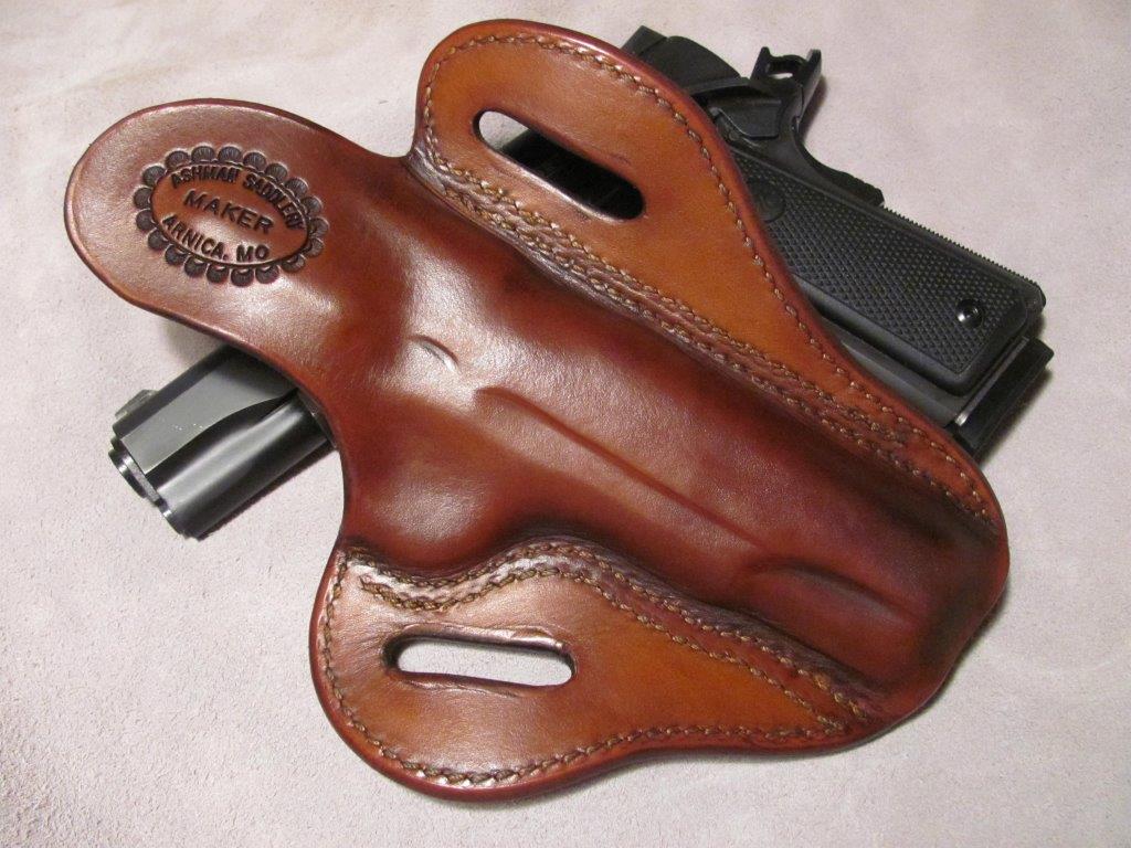

8 oz HO. Dip dyed in Fiebings saddle tan cut about 50% with alcohol then rubbed down wih medium brown antique and topped with 50/50 M&G/water.
post-19070-0-89117500-1428083303_thumb.jpost-19070-0-48369800-1428083318_thumb.jpost-19070-0-81629200-1428083417_thumb.j
I'd joke with you Josh because you made it wrong handed (as opposed to right handed) but that would be the only thing I found that would make me not want it.
Looks really good, . . . but then again, . . . 1911's and saddle tan are a couple of my favorites anyway.
You certainly have much more patience than I do, . . . that tooling is about 3 times my attention span, . . . and it looks really good to me.

Very nice. Innovative stitching also. Gotta keep that in mind.
Josh you are a true artist. Diddo on the stitching too. Thank you for posting

Looks awesome! I'm a little biased as that's my EDC platform... there's just something about a 1911 in a leather holster that I can't get away from.
Thanks folks! I like that stitch pattern too but I can't take credit for it. I think I lifted the idea from Colthammerless or maybe it was BHPshooter. I imagine there are lots of folks out there that do it, it does work out pretty well.

Mr. Stohlman would be glad to see people still using those old designs. I've seen it done a number of ways, but you've made that design look good AGAIN.

Thanks JLS! I really appreciate that! I had to tweak it a little to fit a pancake style holster instead of the clamshell shown in his book but it sure made for a good starting place. That border is now one of my favorites, it has a retro look, almost like it's from the 50's. Go figure :cowboy:.
IMO if anybody doesn't have Stohlman's book on making holsters it really is a fine investment. It doesn't matter if you're not looking to build his exact patterns there is still a lot you can learn from them.
