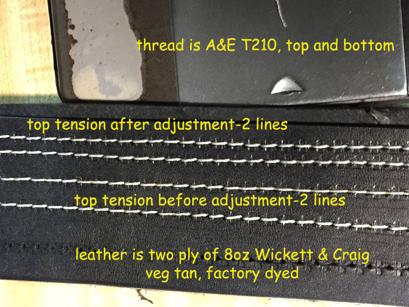

Members gottaknow Posted April 26, 2015 Author Members Report Posted April 26, 2015 I put the 467 in a table today and did some initial test sewing. The table I had was for a consew 327 double needle with an old 70's Amco clutch motor, 220 3ph., 3400 rpm or some such nonsense. Needless to say, there were some control issues, but those old motors are work horses. The motor had no problems with 16 oz. of dyed veg tan, but for proper testing, I'll probably throw a speed reducer on it. The thread breaking issue is resolved. I was using the provided T210 thread for the needle and bobbin, but I believe the bobbin thread should be a smaller size. I've got some T138 I'll try. It handled the T210, but I'm not happy with how tight I had to run the top tension. That is a big benefit of using lighter thread in the bobbin. You can reduce the top tension which makes for an overall better sewing experience. I've attached some pics showing various tensions as I adjusted. I still have a very dry top end of this machine, and that will be next. Oh, as for the missing parts the tech mentioned, the only thing I've found so far is the bobbin winder tension assembly is gone except for the post. Easy enough to make a new one. I used the bobbin winder that was mounted to my stand. Regards, Eric Quote

Uwe Posted April 27, 2015 Report Posted April 27, 2015 Most mortals would have looked at your adjusted stitch sample and said "my work is done here." Thanks for going the extra mile. I just went to inspect the cast-off point on my Consew 225 basket now that I know what it's supposed to do, lol. It's a little sad that apparently nobody has written a comprehensive "this is how it works and this is why this detail or adjustment is important" treatise on this decades-old technology. If there is such a thing, I'd love to know about it. Most service manuals just say stuff like "loosen these screws and align these marks", but they generally don't say exactly why or how things are connected beyond the obvious. I'm glad you're chipping away at the tradition of revenue-protecting secrecy amongst many sewing machine techs and share your expertise with us. Quote Uwe (pronounced "OOH-vuh" ) Links: Videos
Members gottaknow Posted April 27, 2015 Author Members Report Posted April 27, 2015 Thanks for the kind words Uwe. To be honest with you, the average mechanic in a repair shop would never get into the detail that I do. The main reason is that in a repair shop, you can have a guy that's pretty good with timing, tension, and general repairs. They can work on a few machines during their day, making sure the machine will sew as fast as the guy or gal who's going to be using it. In most cases, that's not very fast. However, in a factory where the operators are paid by how fast they sew, their machines need to be set near perfect. We have operators sewing as fast as they can, 40 hours a week. I have to make sure that each machine is capable of doing that. Without getting into the depth and detail that I do, I would be considered a poor mechanic. That's about it in a nutshell. I know mechanics that have worked in a sales and repair shop for as long as I've worked in factories. Their jobs and mine are very different. We can both be successful, but in different ways. I do have issue with folks that call themselves mechanics and then charge a fee for things they can't figure out. People spend good money on their machines. To have a tech say it can't be fixed, then write you a bill just irks me to no end. Especially in the case of this 467. Ok, I'll get off my soapbox. Regards, Eric Quote
