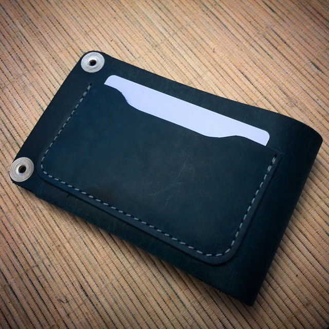

Playing around with some ideas...one piece of leather , 2 card pockets ... one on the inside and one on the outside for most used card...bills fit nicely without the need to fold them. I might go with 2 stacked pockets on the inside. For this one I used 4-5oz chrome tanned , stitched with #138 on a Cowboy CB4500
Any comments are more then welcome.
Thank you !

Very nice. One thing you might want to try; The back of the snap detracts a little from the appearance, you can use the button on both sides with the male on one and the female on the other, then both snap pieces look finished on the outside of the wallet. The posts are the same for the male and female snaps so they are interchangable. I would use the domed cap on both sides.

Thanks Chief...I am gonna give it a shot for sure. I made few wallets where I actually went the other way around using the flat back of the snap on both sides ...I just needed that low profile sandwiched in-between two plys of leather
Well Legion your wallet is way cool. I really like it. And CHIEF I didn't know that about the interchangeable posts so thank you. Will try that where the snap has to show. Cheryl

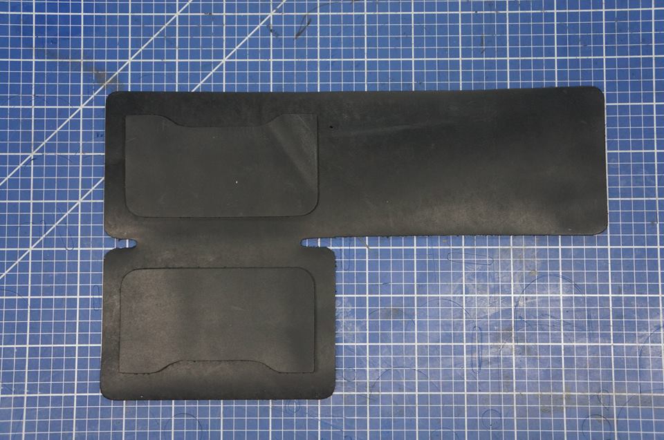

For those of you interested here is wallet unfolded
post-21349-0-20774700-1431108028_thumb.j
thanks
