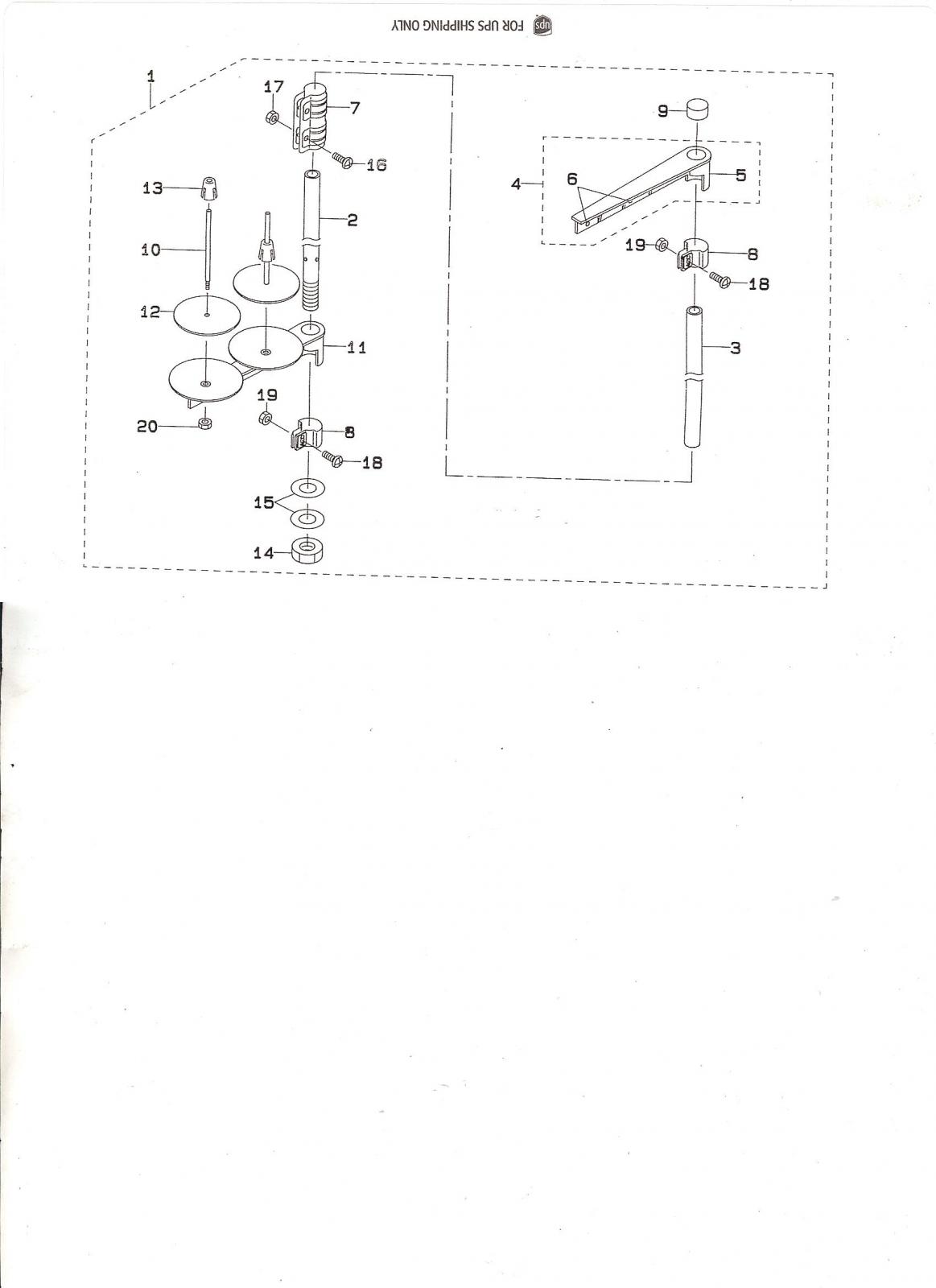

Moderator Wizcrafts Posted November 12, 2015 Moderator Report Posted November 12, 2015 (edited) The missing part is the bobbin winder tension assembly. I just bought one on eBay for $10.00. Edited November 12, 2015 by Wizcrafts Quote Posted IMHO, by Wiz My current crop of sewing machines: Cowboy CB4500, Singer 107w3, Singer 139w109, Singer 168G101, Singer 29k71, Singer 31-15, Singer 111w103, Singer 211G156, Adler 30-7 on power stand, Fortuna power skiver and a Pfaff 4 thread 2 needle serger.
Moderator Art Posted November 12, 2015 Moderator Report Posted November 12, 2015 You can buy the whole contraption for $8 or $9 here. Might as well get some bobbins and a bobbin case or two if needed. Art Quote For heaven's sakes pilgrim, make yourself a strop!
