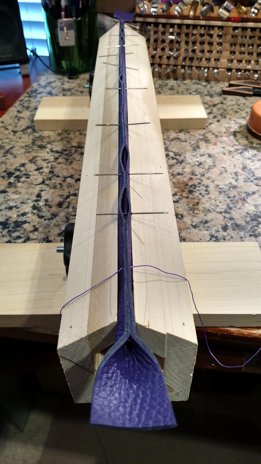

King's X Posted October 23, 2015 Report Posted October 23, 2015 Very nice and I am sure it helps you a lot. I made a combo one for purse handles and belts. The first one is for sewing and edging. The second one came after I learned a bit about the first one that I did not like. Enjoy! Quote
