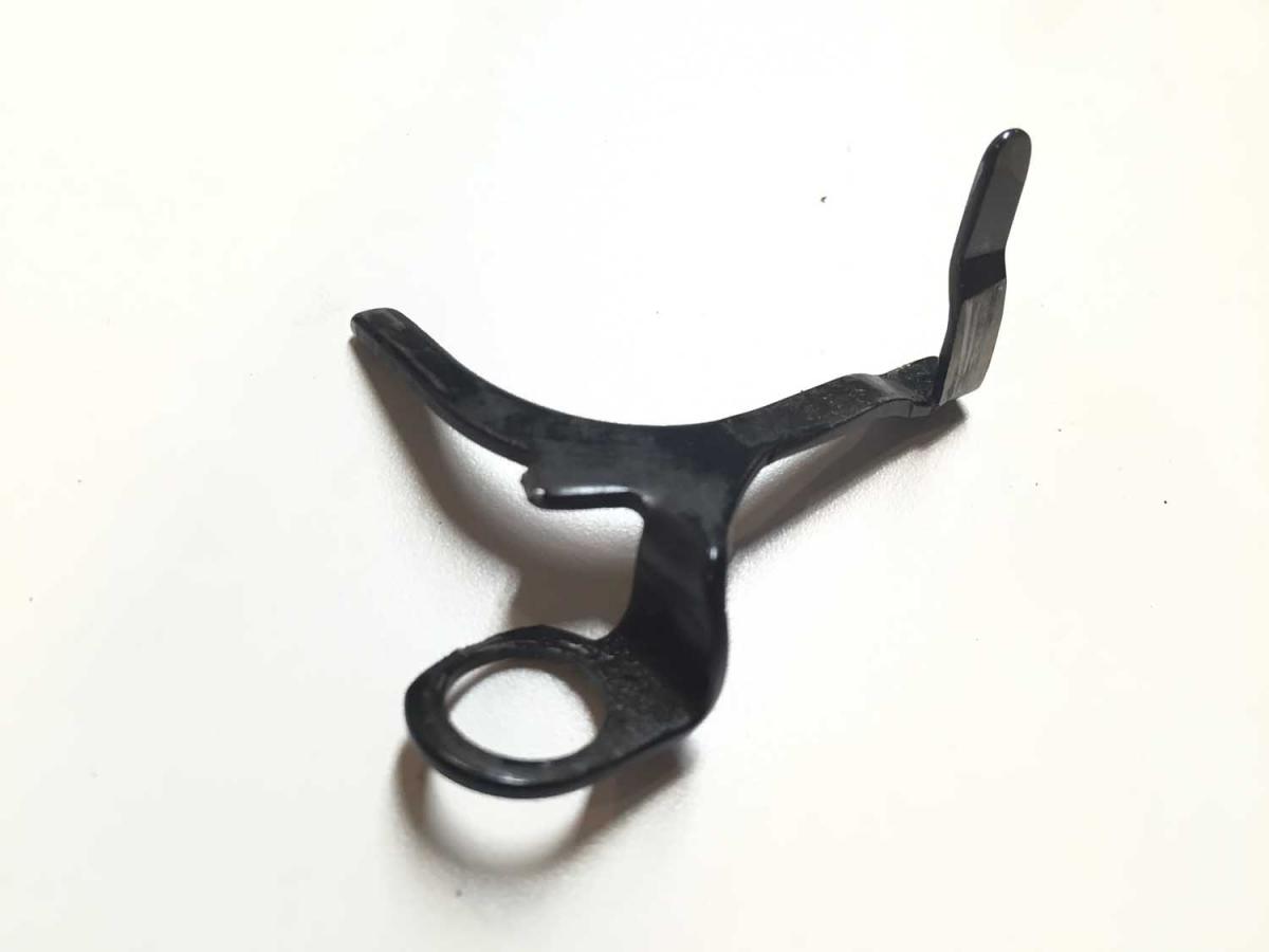

Some progress and a little detour. I installed the machine in a new tabletop, installed the new thread tension unit today and added a servo motor. A normal person would have started to sew, but my foot lift tension release was not working properly and next thing you know:
post-56402-0-23208800-1454030990_thumb.j
But I did confirm that one suspect part was indeed broken:
post-56402-0-27401100-1454031057_thumb.j
The little finger that sticks up to align things had broken off.

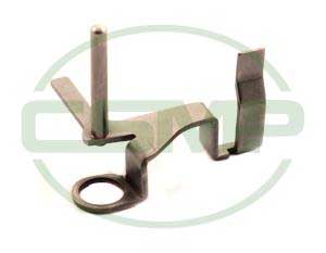

This is what the part is supposed to look like:
post-56402-0-84375000-1454033459_thumb.j
The new part is on order and I hope it arrives before I forget how to put things back together.

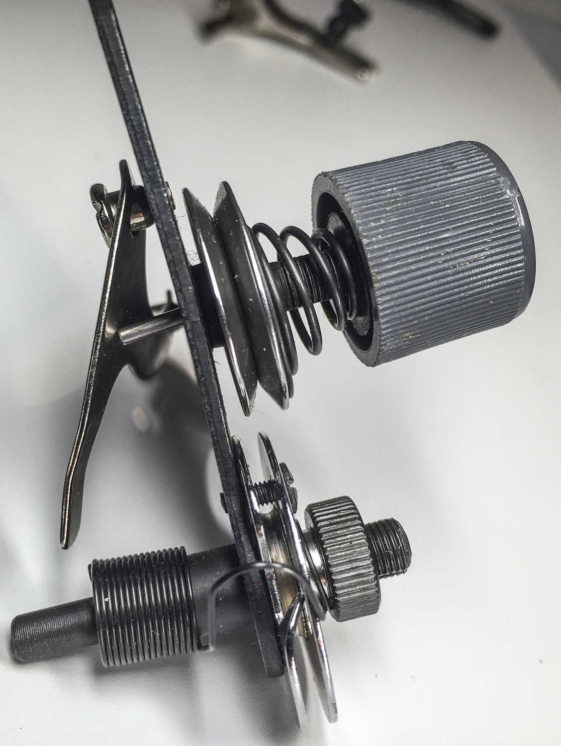

Here are a few shots of the two different replacement thread tension units I had ordered. The one with the grey plastic knob on the right is a little better than the one on the left, but not because of the bigger knob:
post-56402-0-33257800-1454031869_thumb.j

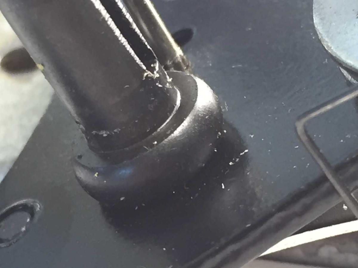

What irritated me about the first one received was the significant offset between the two sets of discs. Ideally the two disc sets would align to let the thread go from one to the other smoothly. This design had a really big ball of sorts to attach the tension disc post to the plate. It pushes the tension discs away from the base plate and makes for a large offset. On the original tension units the discs are basically right against the plate (but it was totally broken, so it did me no good).

The second unit I got was a little better in that respect:

It looks like that ball is just a rubber o-ring and someone at the factory got the wrong one. A thinner o-ring of the same diameter would fix it.

@TinkerTailor: it sure looks like a rubber O-ring but it's actually metal and part of the threaded post. Not sure if it's a manufacturing or a design issue. I suppose I could just use a dremel and grind down the bulging ring:
