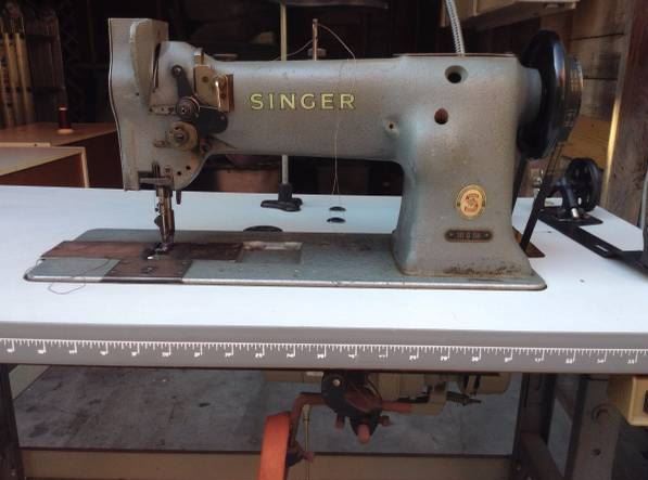

Members v8v8 Posted March 17, 2016 Author Members Report Posted March 17, 2016 Thanks Uwe! And here's a picture: Quote
Members Constabulary Posted March 17, 2016 Members Report Posted March 17, 2016 (edited) sure, oil has nothing to do with the machine it self but I have seen a 111G116 once and I had the the impression that you cannot adjust the stitch length at this particular model. If I remember correctly it had no dial for indicating the stitch length and just one plunger in the flat bed for reengaging the safety clutch but non for the stitch length. The one I have seen also had different presser feet and no "standard" needle plate so be careful with this model!!! Also the hook is not on the right side, it is placed on the left side (usually no big issue). Have you already bought the machine? Edited March 17, 2016 by Constabulary Quote
Members dikman Posted March 17, 2016 Members Report Posted March 17, 2016 Info on the G model seems a bit rare, I could only find the 111W116 (I was curious what it was). Quote
Uwe Posted March 17, 2016 Report Posted March 17, 2016 We'll need to see some more close-up pictures, especially of the underside, too. The photo does show a stitch length viewing hole that is not in the 111W116 manuals or reference photos. I believe the intention for this machine is (or at least my advice was) to get a very cheap test machine to learn and practice maintenance tasks with before he buys a precious keeper. Quote

Members shoepatcher Posted March 18, 2016 Members Report Posted March 18, 2016 V8V8, I have a Singer 111G117. It is a 111W153 with a trimmer on it. Your machine is missing the trim knife mechanism which came in different gauges from 1/8" to 1/2" plus. The trimmer moved in conjunction with the feed dog. Great machine. Mine can trim 10 layers of Cordura at one time. It is not a fixed stitch length. You can change the SPI. It uses a different needle system. Not 135x17 but rather 126x11 which is a longer needle. The difference between the 111W116 and 111w117 is that the 117 had automatic bobbin tensioner. This one obviously has been gutted to make it into just a walking foot machine. The trimmer parts are no longer available from Singer and I have never found any generic ones. Consew makes a machine that might work for parts. Not sure on the model. 226VF or something like that. Hope that helps. glenn Quote
Members brmax Posted March 18, 2016 Members Report Posted March 18, 2016 (edited) Looks like a great find there on the 116, Interesting information also Glen Now I'm curious with the needle system options, that's a benefit I need to study a bit. So the base looks to have good options for attachments and the like, having the slide covers and as a double needle base. Keep us posted and photos are to cool! Nice new table top, did you work that up already or did you buy it that way. If bought that way your a lucky dog. good day there Floyd Edited March 18, 2016 by brmax Quote
Members gottaknow Posted March 18, 2016 Members Report Posted March 18, 2016 The 116 subclass are pretty nifty. My supplier list parts for the cutter and says they're available. Not sure it would be worth the investment. Regard, Eric Quote
Members dikman Posted March 19, 2016 Members Report Posted March 19, 2016 Looks very similar to my 111WSV77 (which as far as I can tell is the same as a 111W153), only differences I can see are mine's black (!) and yours has an extra sliding plate in front of the needle. Quote
Members v8v8 Posted March 19, 2016 Author Members Report Posted March 19, 2016 Thanks Glenn, That's some good information. V8V8, I have a Singer 111G117. It is a 111W153 with a trimmer on it. Your machine is missing the trim knife mechanism which came in different gauges from 1/8" to 1/2" plus. The trimmer moved in conjunction with the feed dog. Great machine. Mine can trim 10 layers of Cordura at one time. It is not a fixed stitch length. You can change the SPI. It uses a different needle system. Not 135x17 but rather 126x11 which is a longer needle. The difference between the 111W116 and 111w117 is that the 117 had automatic bobbin tensioner. This one obviously has been gutted to make it into just a walking foot machine. The trimmer parts are no longer available from Singer and I have never found any generic ones. Consew makes a machine that might work for parts. Not sure on the model. 226VF or something like that. Hope that helps. glenn It came with the table and a clutch motor. I was surprised as well at the good condition of the table. The motor works but I'll probably be looking into getting a servo. Looks like a great find there on the 116, Interesting information also Glen Now I'm curious with the needle system options, that's a benefit I need to study a bit. So the base looks to have good options for attachments and the like, having the slide covers and as a double needle base. Keep us posted and photos are to cool! Nice new table top, did you work that up already or did you buy it that way. If bought that way your a lucky dog. good day there Floyd Quote

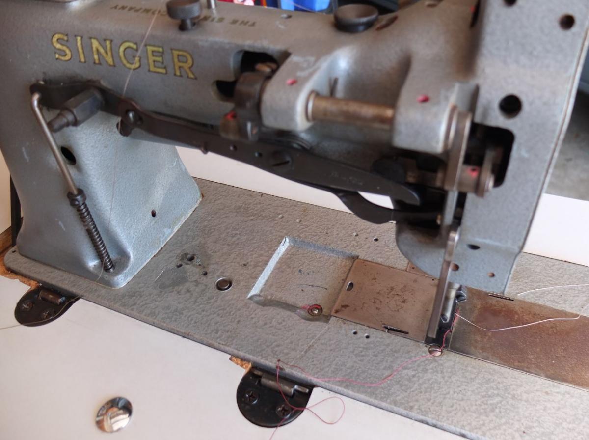

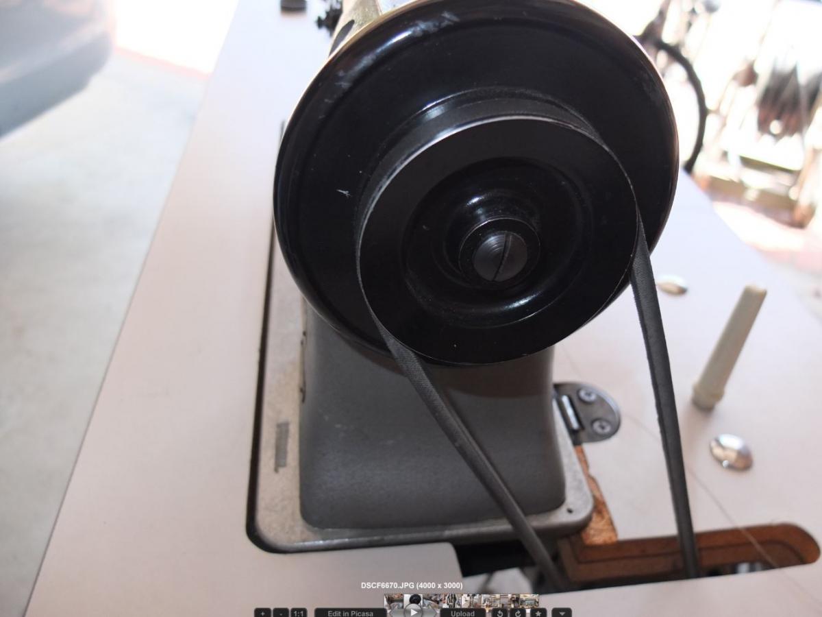

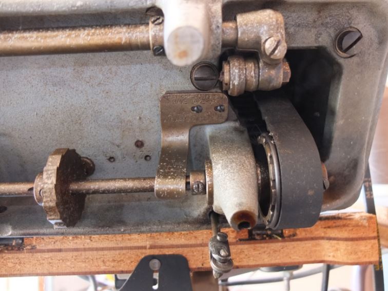

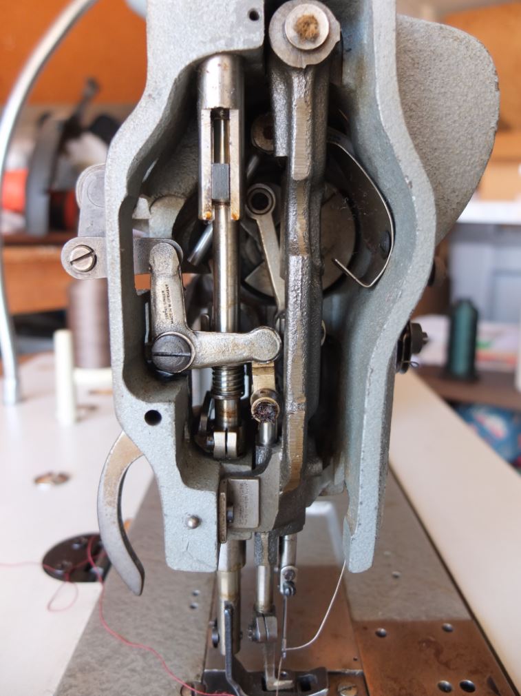

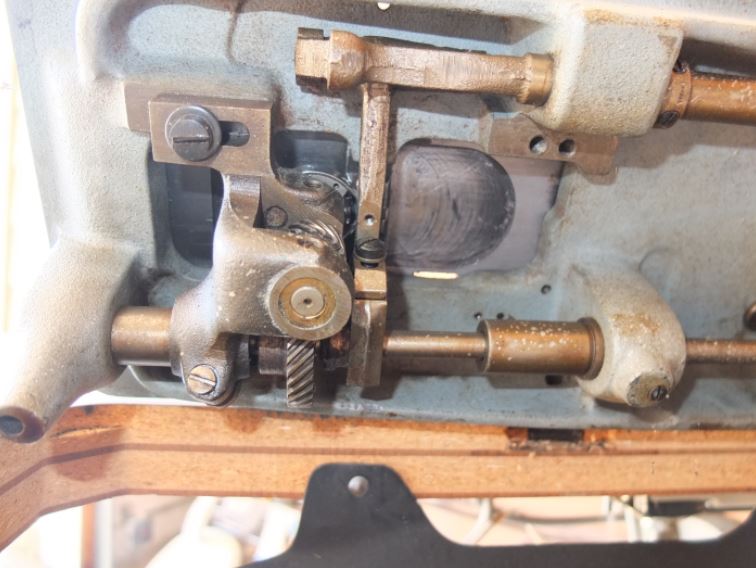

Members v8v8 Posted March 20, 2016 Author Members Report Posted March 20, 2016 The net is seriously lacking in pictures of the 111G116 so here's my contribution: Quote
Members Constabulary Posted March 20, 2016 Members Report Posted March 20, 2016 (edited) Seems to be in relatively good condition but I assume the flat bed has been repainted but that's nothing unusual. looks pretty much like the one I once have seen. Trimmer seems to be removed but I don´t see a stitch length adjuster mechanism. When you open the lid on the top right do you see a dial with numbers? Edited March 20, 2016 by Constabulary Quote
Members brmax Posted March 20, 2016 Members Report Posted March 20, 2016 From my view the machine looks great and little usage, possibly can use a needle bar thread guide or I'm not seeing the thread through the hole. Great find for sure, and thanks for the photos Floyd Quote
Members SARK9 Posted March 20, 2016 Members Report Posted March 20, 2016 Constab: >> [...] I don´t see a stitch length adjuster mechanism. When you open the lid on the top right do you see a dial with numbers?<< I've not actually owned a "real" Singer 111, but I don't see anything like what I'd recognize as a *feed eccentric* assembly anywhere on the underside view, either, unless it totally miniaturized. -DC Quote
Members dikman Posted March 20, 2016 Members Report Posted March 20, 2016 I was just looking at the outer foot and realised that the screw clamp is at 90 degrees to that on my 111 (which is the same as my 211). Quote
