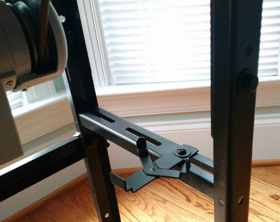

Members danicarby Posted August 2, 2016 Members Report Posted August 2, 2016 I recently just finished restoring a Singer 31-15 and there's a bracket on the table legs close to the knee lever... Does anyone know what it is for? Also, can anyone tell me what this machine was specifically designed for? Thank you for the help!! -Dani You can see before/after pictures and what I did to make it perfectly functional on my blog: http://theprojectlady.blogspot.com/2016/07/industrial-singer-31-15-sewing-machine_7.html Quote
CowboyBob Posted August 2, 2016 Report Posted August 2, 2016 Singer had an oil can that would set there. Quote Bob Kovar Toledo Industrial Sewing Machine Sales Ltd. 3631 Marine Rd Toledo,Ohio 43609 1-866-362-7397

Members Gregg From Keystone Sewing Posted August 2, 2016 Members Report Posted August 2, 2016 Thanks Bob, I learned something new around here today. I asked the mechanic here, he said also that it was for the metal oil cans Singer used to put out, he also knew what that was for. Quote Industrial sewing and cutting, parts sales and service, family owned since 1977, Philadelphia, Pennsylvania USA, 215/922.6900 info@keysew.com www.keysew.com

Members graywolf Posted August 4, 2016 Members Report Posted August 4, 2016 Oil can probably looked like this one: Quote
