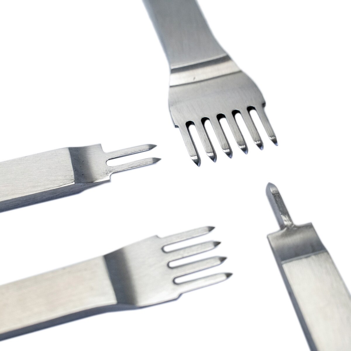

I suggest you check out the new irons that Springfield Leather Company is selling.  For the money, they are among the best I've seen.  The teeth are very smooth and they come out of the leather very easily.  The holes they create are fairly small in comparison to some other irons out there.  Smaller tends to be better, in my opinion, so long as they have enough angle to make your stitches reflect the angle.  If you re doing wallets and such, the 3.0mm and 0.6mm thread would be a nice combo.
https://www.springfieldleather.com/Craftmaster-3mm-Diamond-Point-Stitching-Chisel
3DPSC.Set.02.jpg?resizeid=22&resizeh=1200&resizew=1200
The chisels make a diamond-shaped hole.  I showed the holes in another thread.
Looks like some old irons I bought from Aliexpress (A lot cheaper) and they do the job.

It isn't often that the actual product looks better than the advertising photos, but I feel that is the case with the new irons SLC is stocking.  I have no doubt that they aren't "new" in reality, but they are new to SLC.  They are highly polished and they pull nicely from the leather.  I tested them on two layers of 4 oz. and they came back out with little friction.
I'm not suggesting that these compare in quality to Crimson Hides, Kevin Lee or KS Blade.  What I am saying is that they are very nice and cost a fraction of the price.  Time will tell if they hold up.  I am beginning a larger project soon and that will test them.
This is some scrap with some stitching lines for comparison.  Also, notice the small (relatively) holes made by the SLC 3.0 irons.
