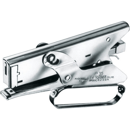

1 hour ago, Bert03241 said:
what R paper staples?
Regular staples, like you use with a stapler in an office.  If I've got a tricky assembly, like with a gusset that's hard to hold in place before sewing, I often use a stapler to staple the assembly just outside of where I will stitch.  That way everything stays perfectly in place while I stitch and then I use a staple remover to remove them, or if far enough away from my stitch line I just use scissors to reduce the seam allowance, thus cutting them off.
Plier-Type Staplers PB323 | TENAQUIP
