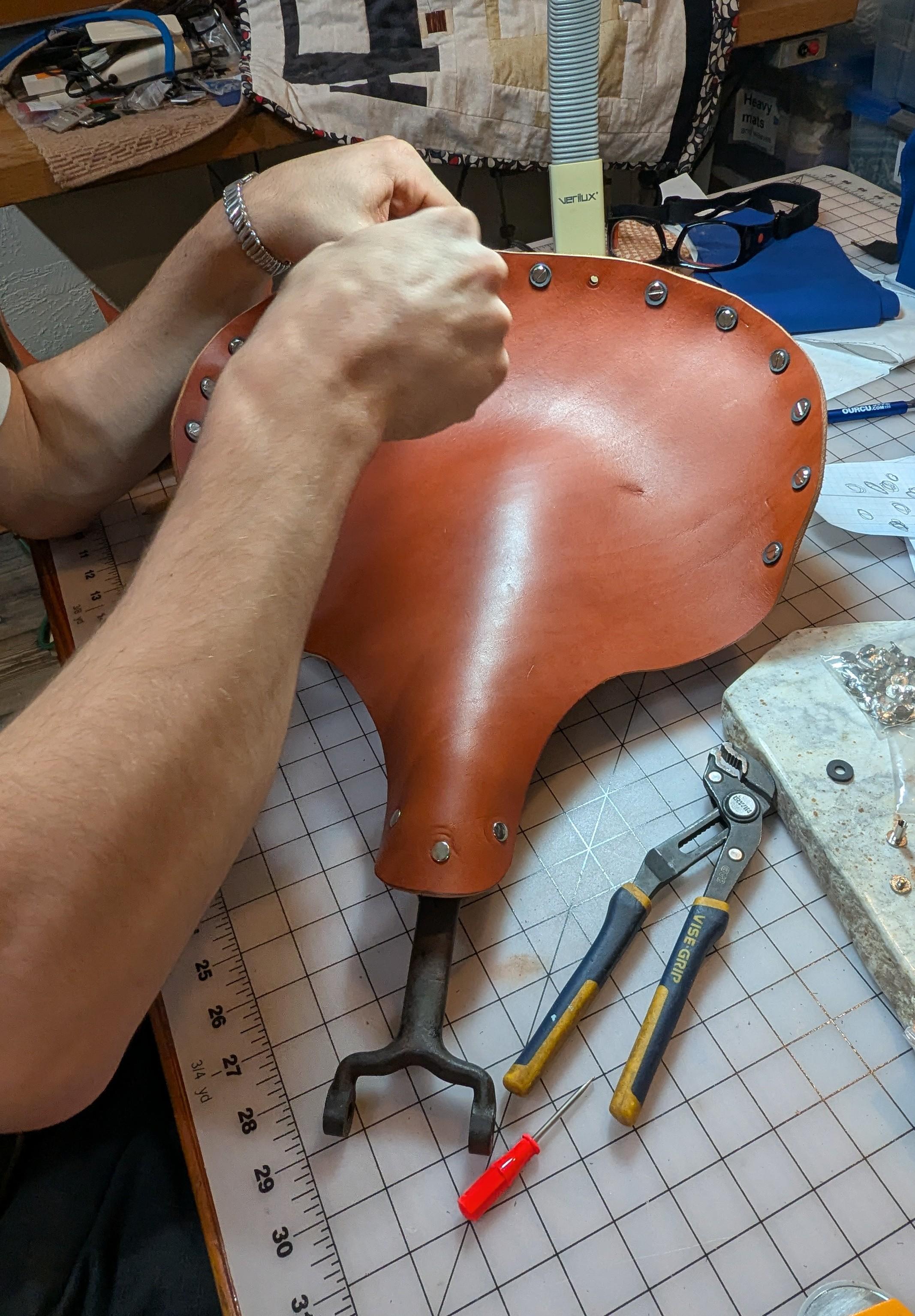

Irishleather replied to Irishleather's topic in Motorcycles and Biker Gear
Thanks! 6-strand linen! OK, this might be a test of his patience. Here is the frame and the first layer experiment. Found better rivets today, so those will be changed out. -

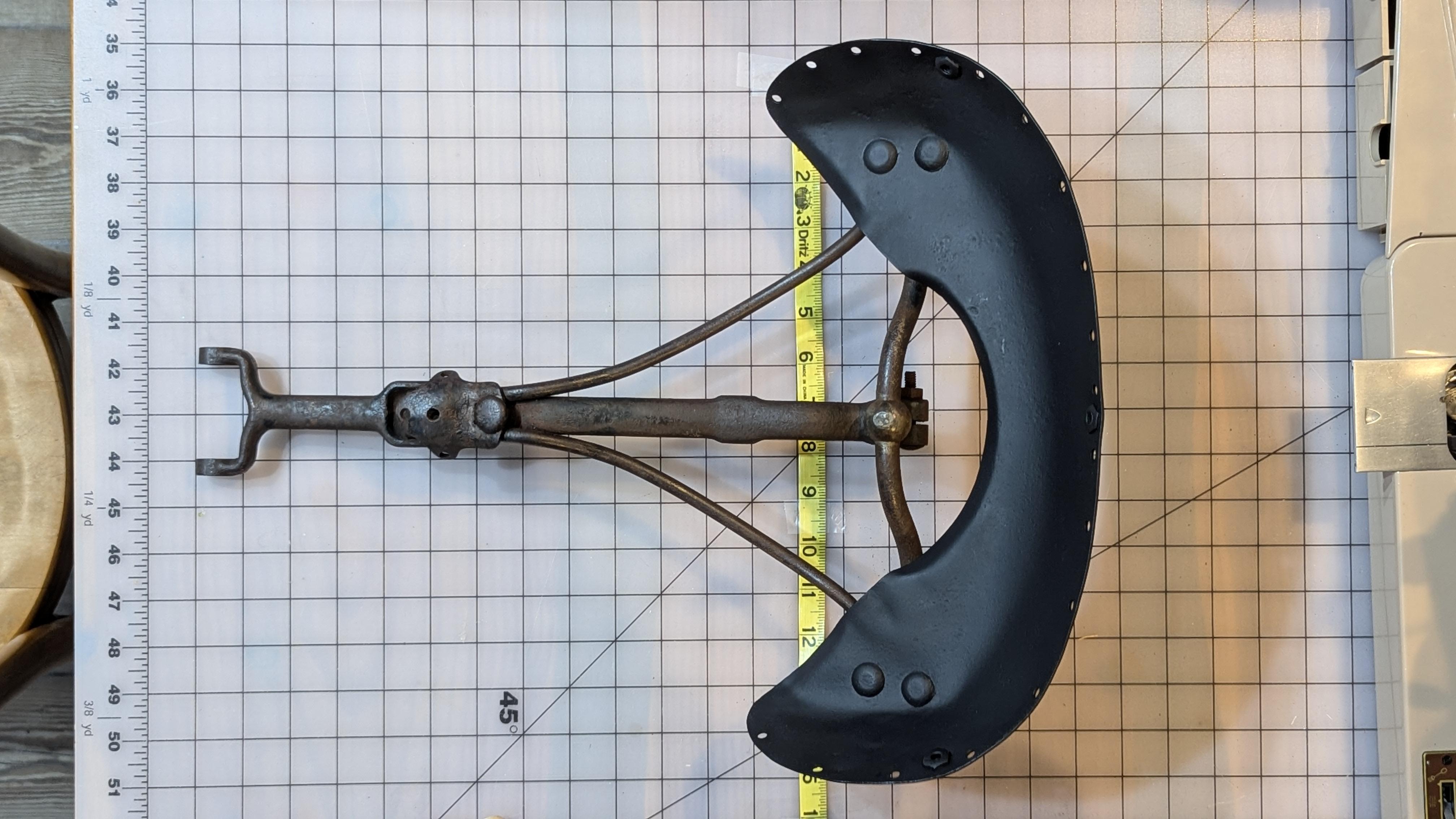

I am helping my grandson build his Harley long-nose seat. At this point, he will be stitching by hand, two layers of veg-tanned leather with pre-drilled holes. I'm ready to order the thread. I'm thinking waxed four-ply linen .8 to 1mm? But I'm not finding it where I can get it sooner than next year. And not sure if that thread is the best in this situation. Any thoughts?
