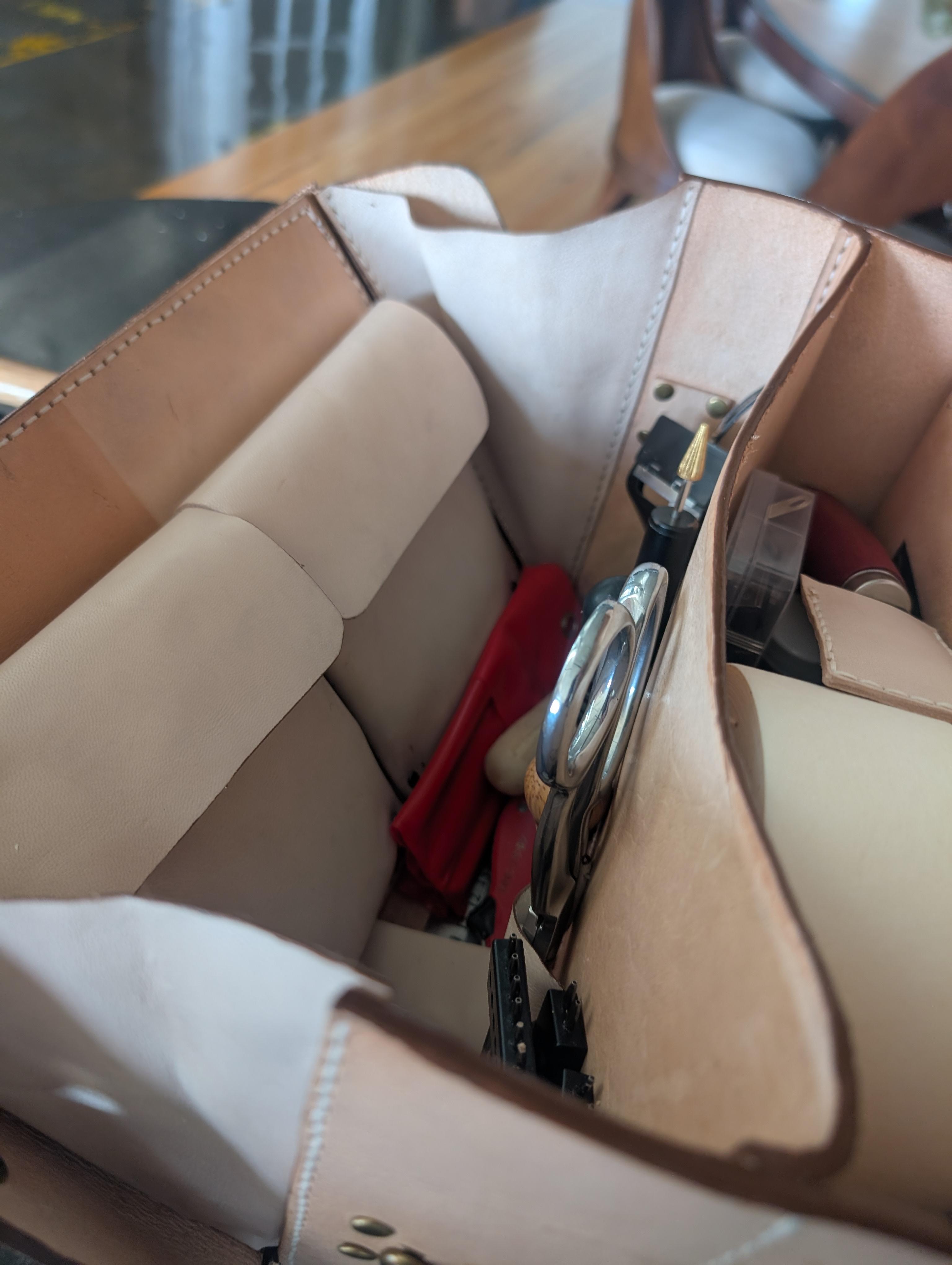

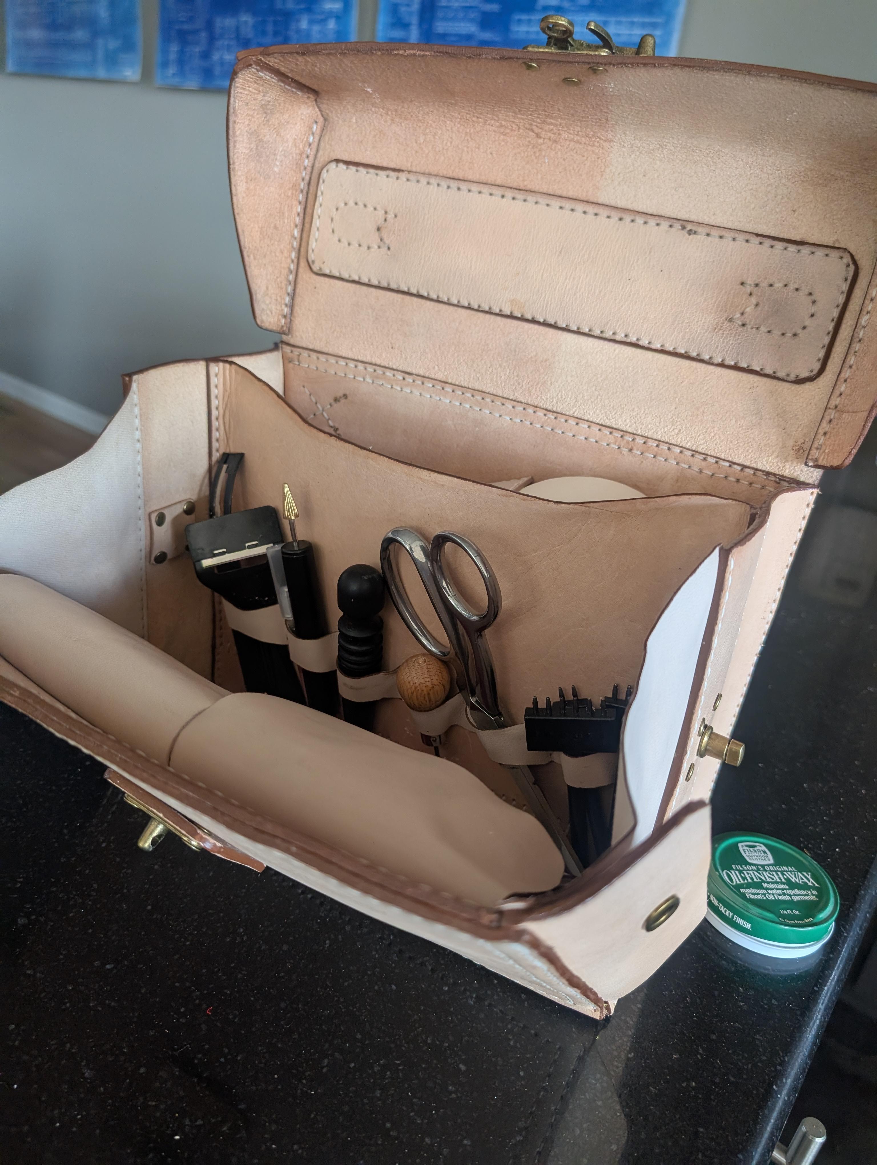

The pattern called for 7-8 oz veg tan. I bought the thickest I could find at Hobby Lobby called tooling leather; I'm guessing 3/16ths (4.5mm?) inch thick..maybe 12-14 oz? Much thicker than what Tony (Diesel Punk) used in the YouTube video. I thought a tool bag needed to be thick and tough and at this point had not been to a real leathercraft shop where other options are available. I used a 1, 2, 4, and 6 hole punch for the holes. It took probably five hits on average to get the 6 hole punch through. I'd say I'm above average in hammering strength. I wore noise canceling headphones throughout or I might have had hearing damage. 1.5 mm holes and 1mm white waxed thread off Amazon. The edge are painted with brown ArtMinds edge paint. I bought a little roller tool off Amazon and it got a little sloppy...the roller head keeps falling off. I used a fine beveler. I was hoping for better results overall. Most of the edges are not even and my stitch lines are not straight in several areas. The leather didn't bend as nicely as I hoped where the side and the front/bottom/back come together. Cleaning up the leather from my dirty hands caused some creases/wrinkling on the surface. The handle is the worst for part for bringing two edges together. The leather edges were pulled inward instead of making a nice square edge. The stitches were too close to the edge to sand and make it even...I would have sanded the thread. I didn't have an awl to start, but bought one and found it really helped with lining up the holes for stitching. I broke probably 10 needles. The kept snapping at the eye. Eventually I started using needle nose pliers to pull the needs through as my hands ached from the work. If I followed instructions of 7-8 oz, stitching probably would have been easier and the edges might have matched up better. I ordered some hardware from Amazon, but my wife said it was cheap stuff and encouraged me to return it. I went to Tandy Leather Shop in Livonia MI and found the clasps I used. I'm happy with the quality of the clasps from Tandy. I had to make some modifications to use this hardware. The rivet above the swing clasp was a hole for the original Diesel Punk plan. I just put that in to fill the hole...I don't think anyone would think it's to cover up a change in plans mid project. I'm going to clean the bag a little more than apply some Filson's Original Oil/Finish/Wax to protect it from staining. I'll test the product on some scraps before I apply it to the bag. I'm currently using the tool bag to hold me leather tool.
Very nicey indeedy But . . . . we like more information, eg what weight or thickness of leather did you use? What thread? Stitching chisels or awl ? I see you didn't dye it but there is something on the edges, what?

Everything Fred said - and the bag looks good.

Please post your photos directly on here. Over time, for various reasons photos hosted on other sites go away making the posting here empty Would that be dieselpunk.ro? His patterns are well liked You get used to it A good plan

I used a pattern from a Romania leather guy off of YouTube. I think he's probably pretty well known. My hands hurt afterward, but I learned a lot and am excited to start my next project. I want to make large leather goods like this...maybe a duffle bag, hand bags, or a backpack next. I don't want to be a seller of my projects. I hope to become good enough where I can gift these items. I included a link to two pictures of my tool bag. Tool Bag
