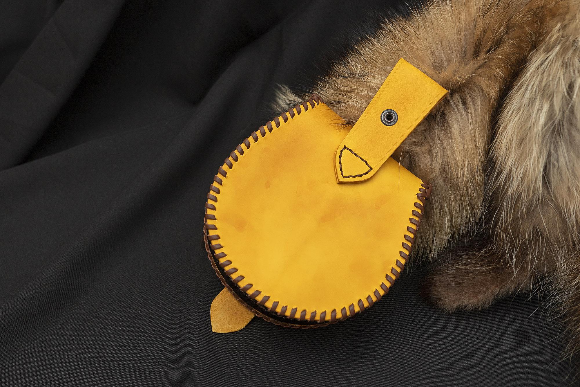

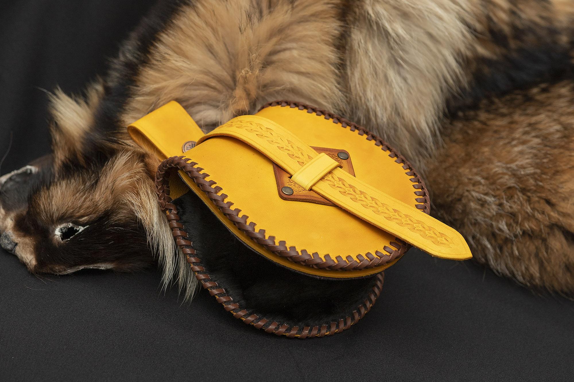

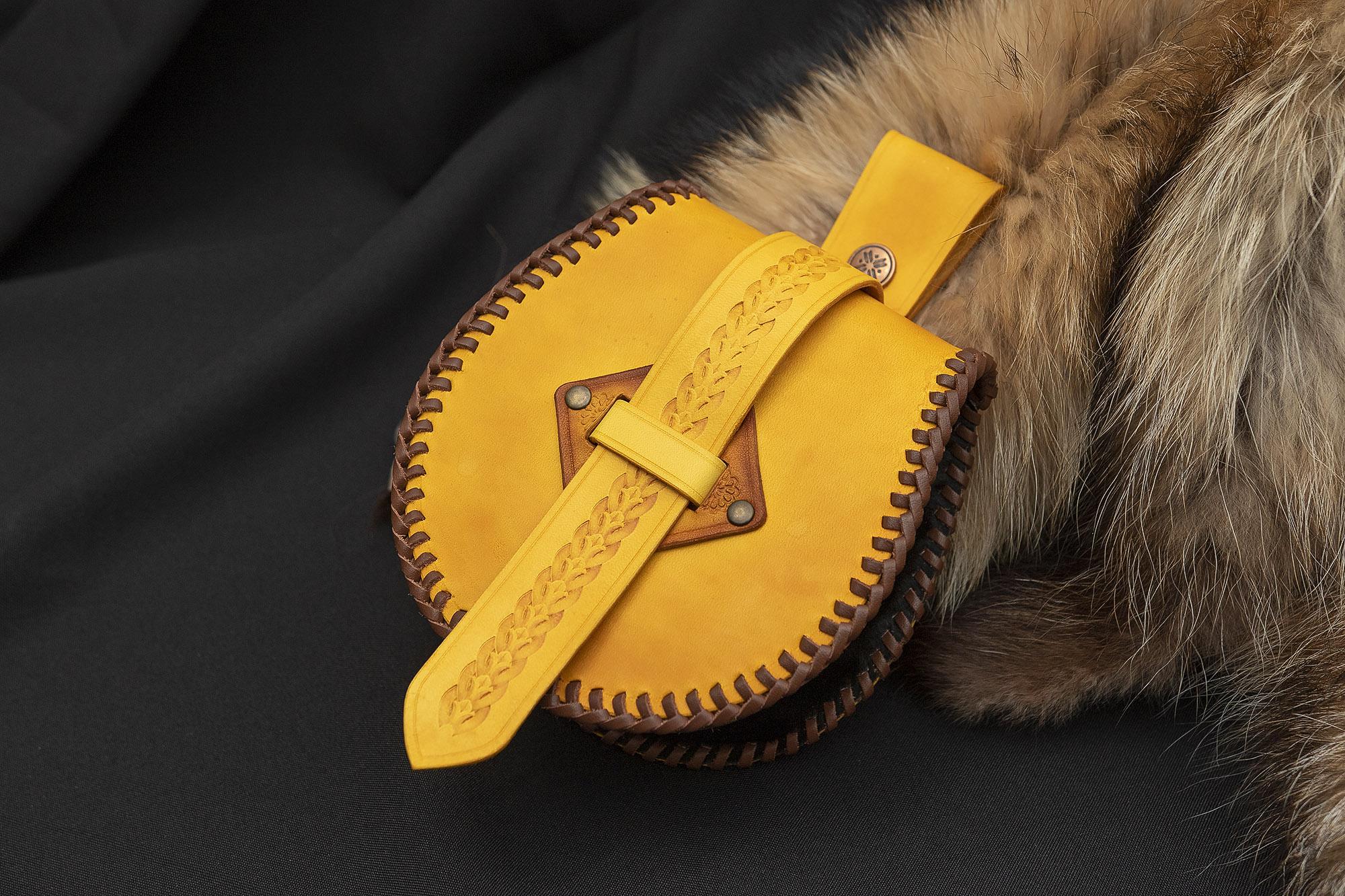

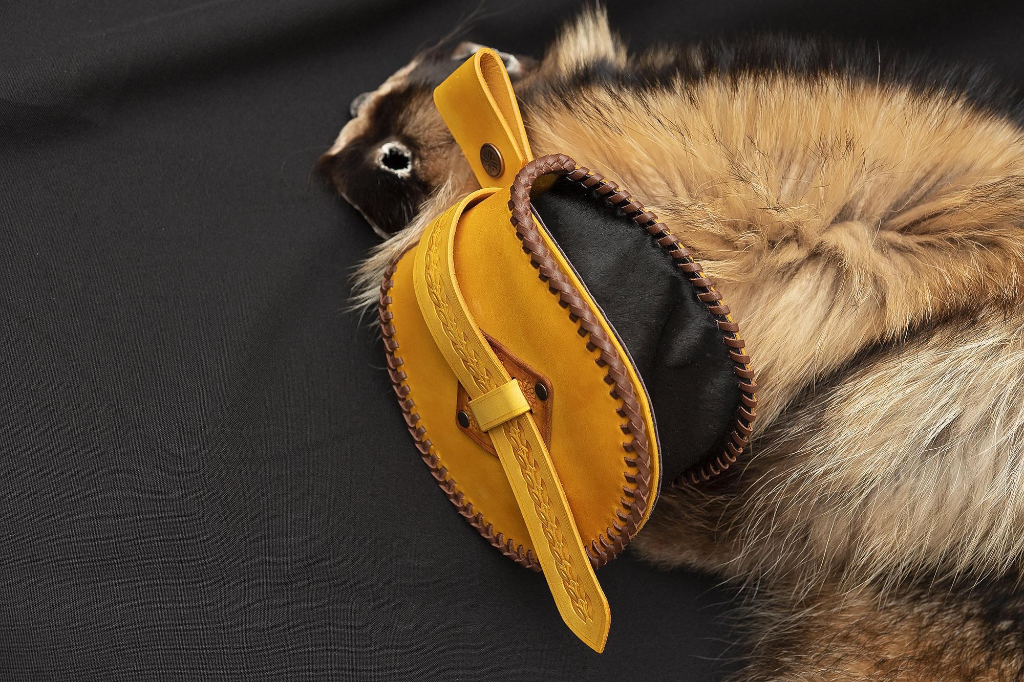

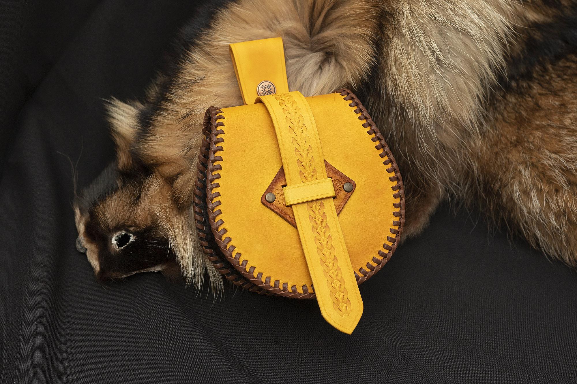

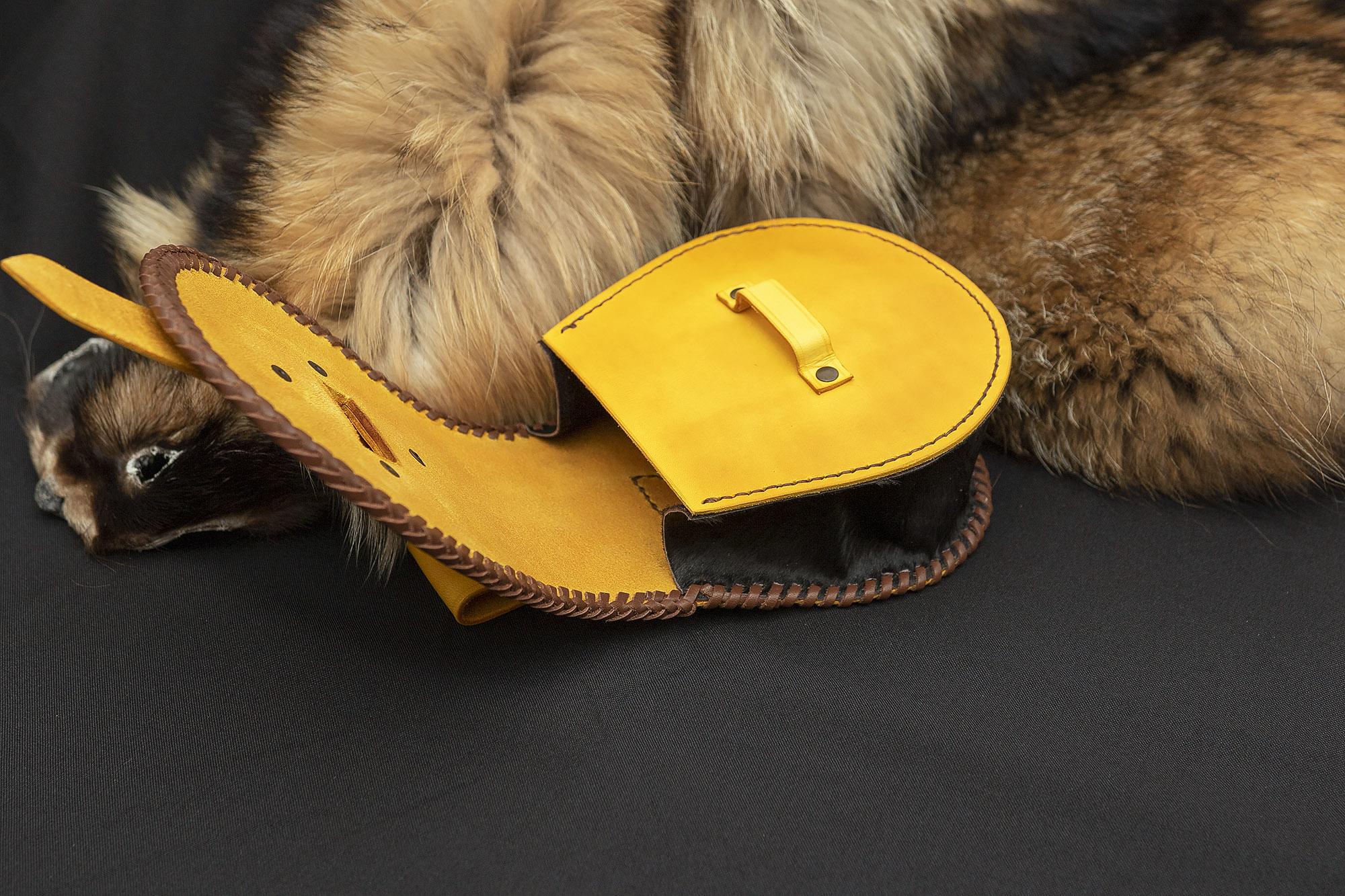

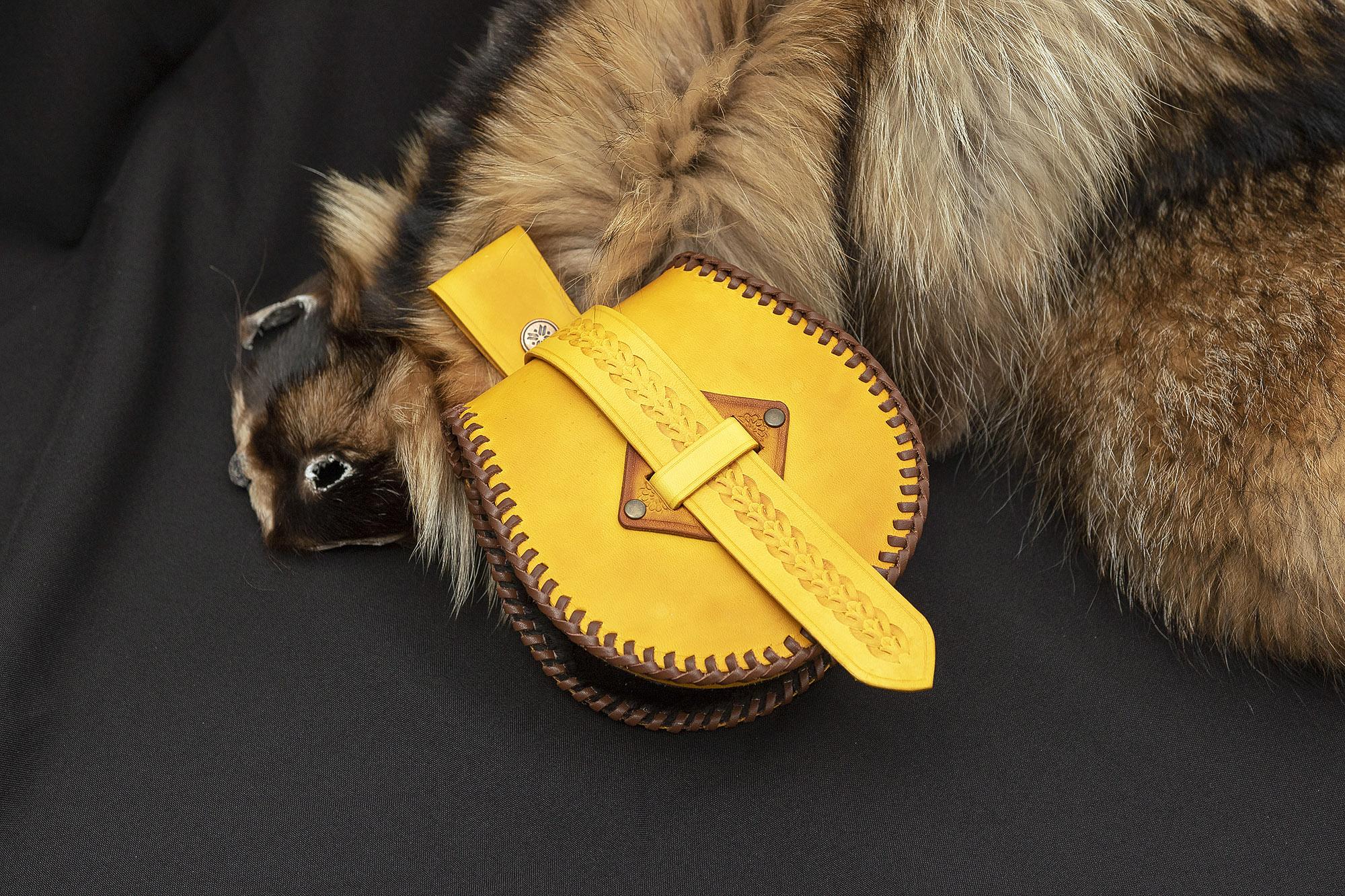

Finished lately one smaller belt pouch. Now I try design bigger pouch, where I can put A5 size drawing block with some pencils. I used cool cow hide with fur on side piece. And here are tracking video too:
