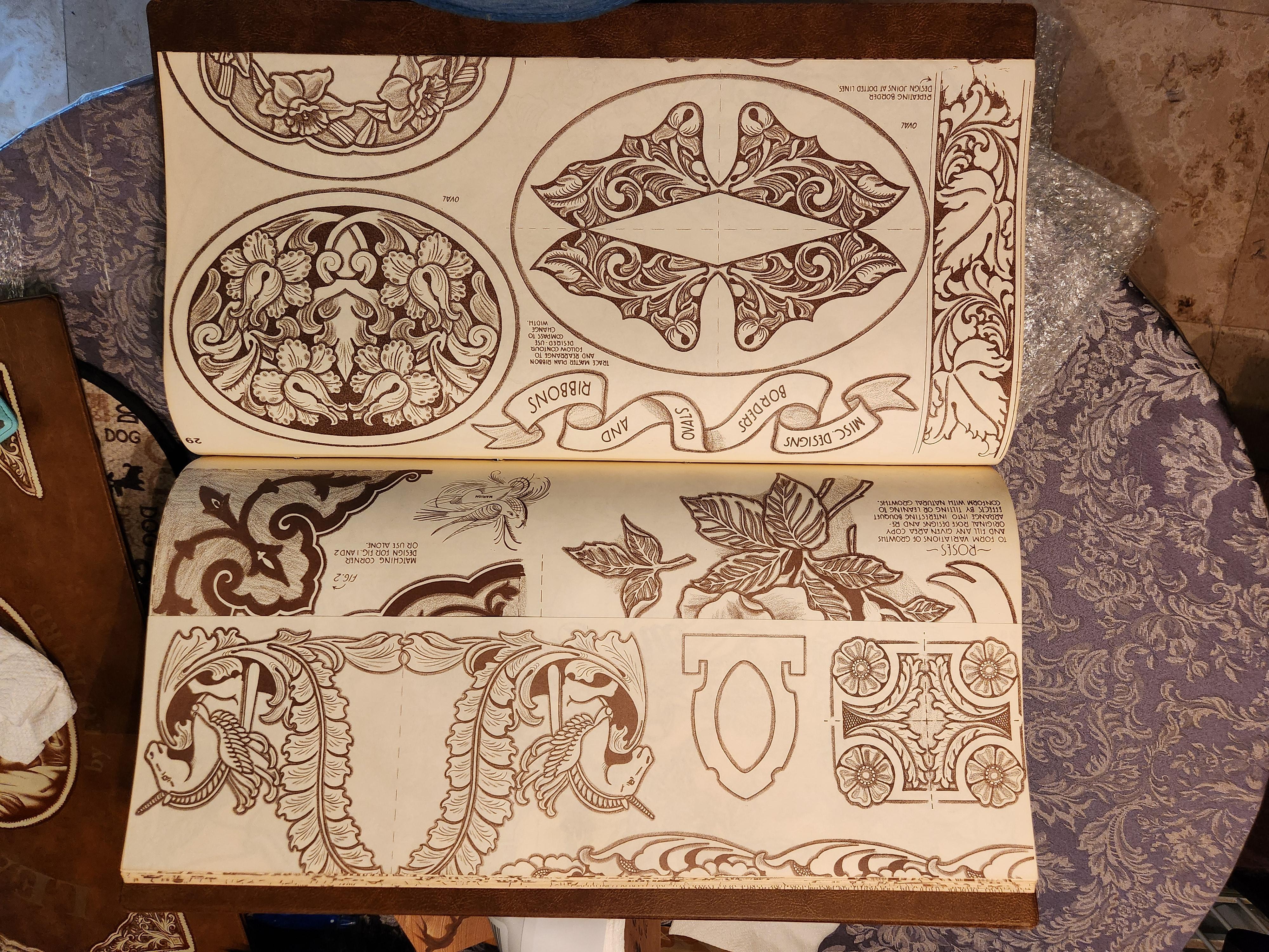

I have a very good copy of the large Design Artistry book by F.O. Baird. All pages are in excellent condition. There are a couple of hardly noticeable scratches on the front. The book has pages that can be removed to be used as patterns. Will ship to US only. $300 plus shipping to be calculated at sale.
