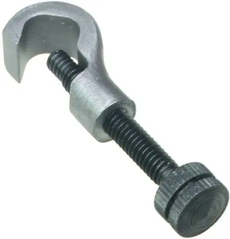

I have few pfaffs in the range of 142 to 1245 and I always adjust needle bar height regarding to the hook. - get the needle bar into the lowest position - advance so the needle bar rises to the necessary height regarding the model (between 1.6 - 2.5 mm)* * first I was doing this with making a black mark on the needle bar, later I bough the clamps for that - in this position the top of the needle hole must be 1 mm bellow the hook point see pages 9-10 here in the attached manual. Whenever I had serious problems I followed the manual from the beginning to the end and it always helped. p.s. manuals sold on the internet are usual exactly the same as the free one. Pfaff 1245 Adjustment 89_09.pdf
