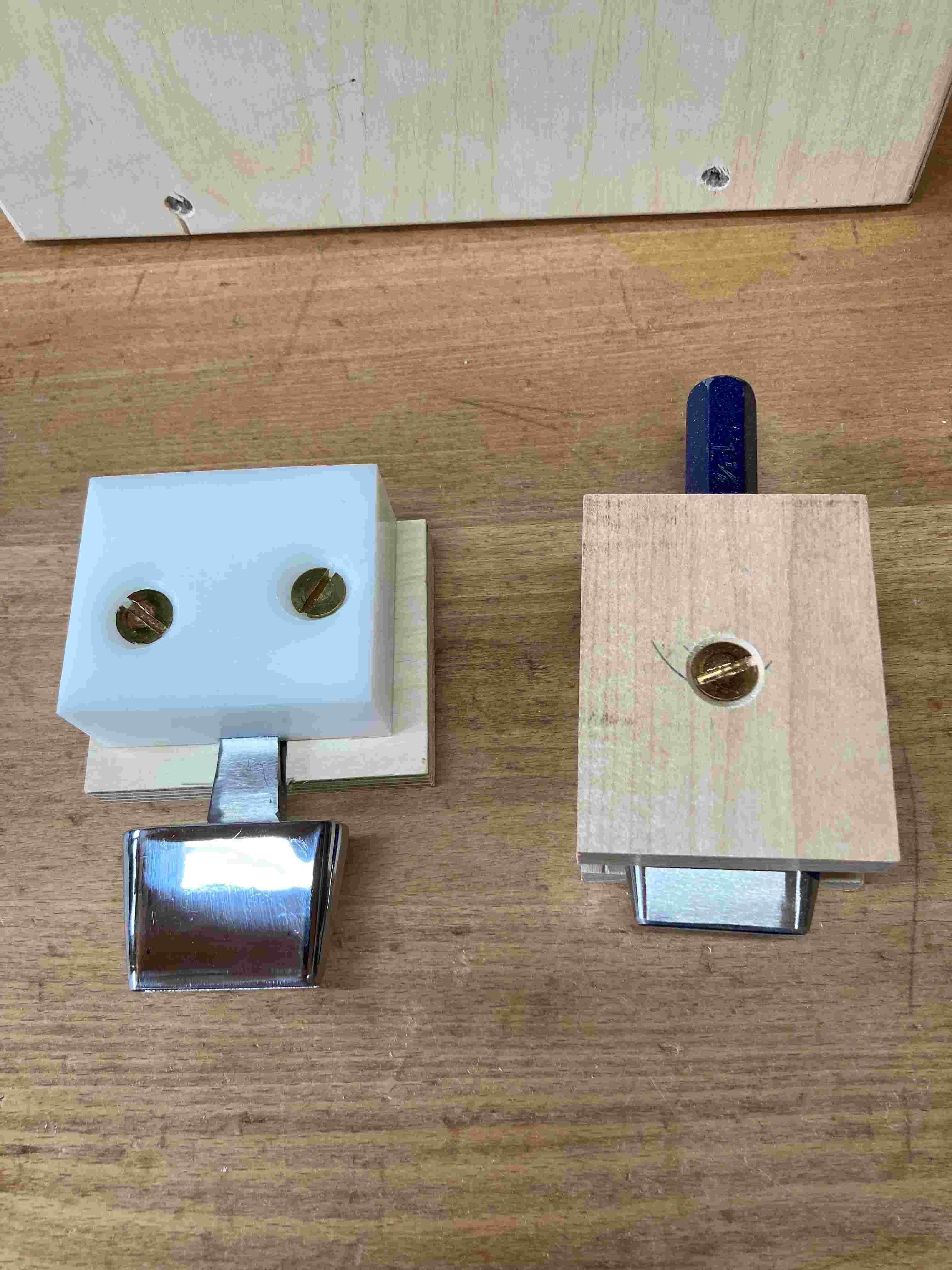

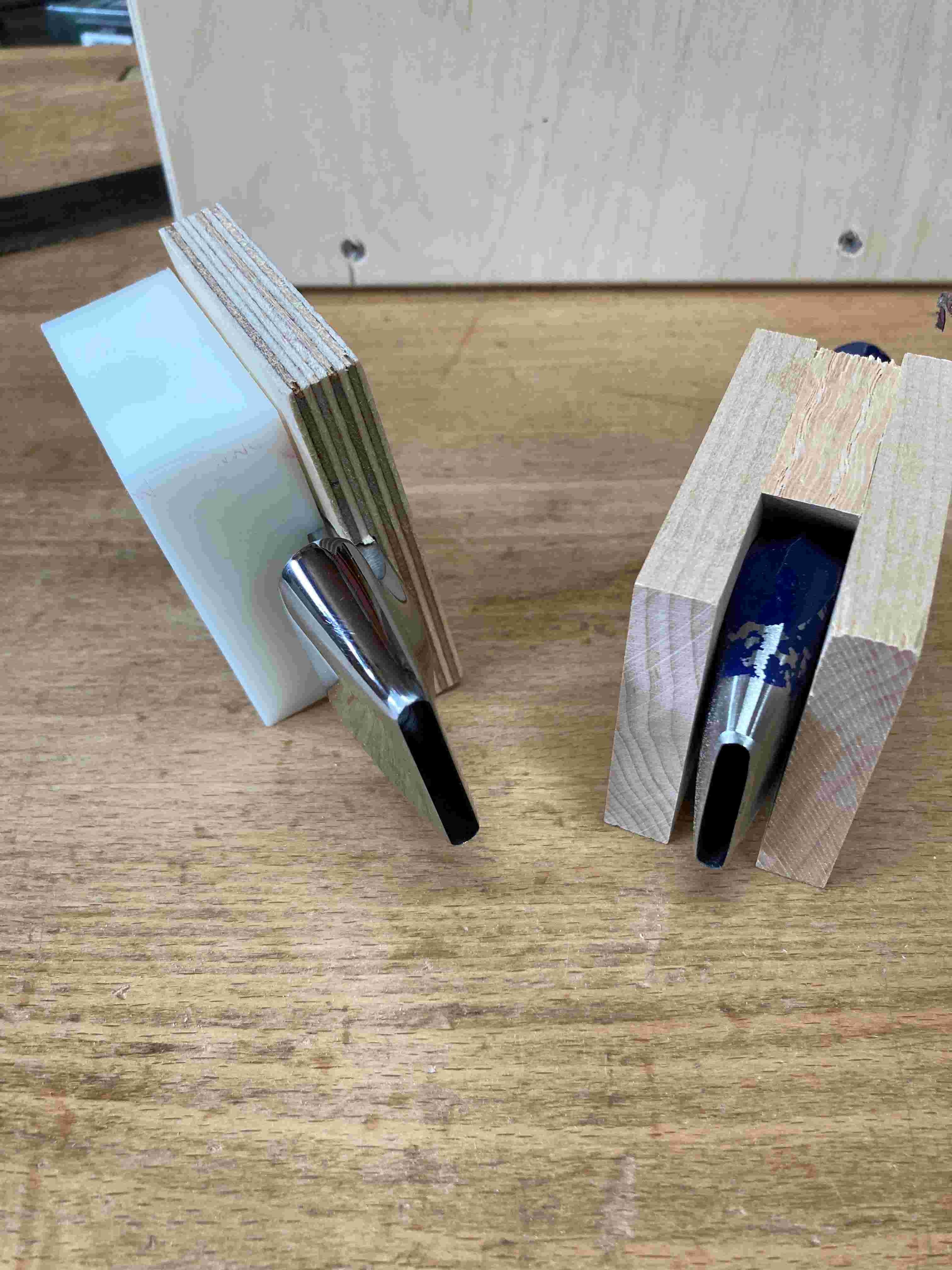

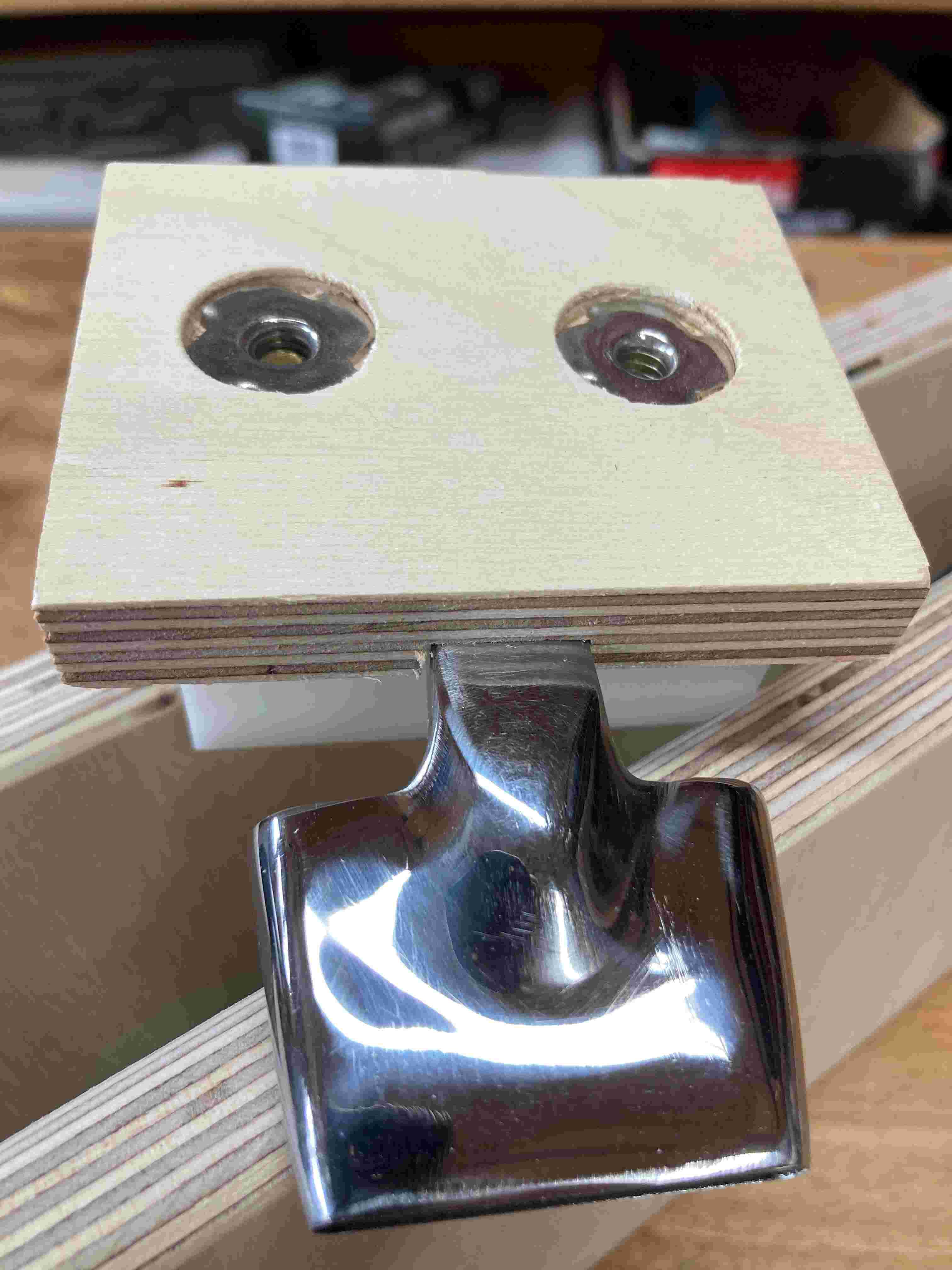

I wanted to precisely punch centered oblong holes in 1 1/2" belt blanks for attaching the buckle. This jig allows me to it easily. The punches are sandwiched between blocks and screwed together. The blocks were sized to snuggly fit into the 1 1/2" wide box that the belt blank slides into. They were also cut to allow the punch to be centered in the jig. The blocks are easily removed whenever I need to use the punch without the jig. They are held together with flathead screws and Tee nuts.
