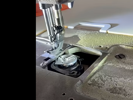

Singer 211 U166A walking foot problem
AlZilla replied to NowhereMan01's topic in Leather Sewing Machines
If what @CowboyBob told us about the 111W machines holds true, at this point of the needle stroke (all the way down) the point of the hook should be on an imaginary line between the center of the bobbin and the needle plate screw closest to the operator. This one is late or early, depending. In case the viewer can't tell, the point of this hook is right next to the bobbin latch on the opposite side. -
friquant replied to NowhereMan01's topic in Leather Sewing Machines
Closer, and much slower. 😉 With the machine moving at an even speed (a snail's pace) and never moving in reverse. And with the phone on its side (landscape) instead of up and down. Here is an example of close, slow videos from today: https://leatherworker.net/forum/topic/131845-pfaff-345-issues/ I agree with ALZilla. From your latest video, the hook is about 150 degrees ahead of where it should be. (Love those timing marks, so visible!) It would be ideal if you could master the art of tripping the safety clutch and then resetting it. Because there is no point in setting the hook timing unless the safety clutch has been re-engaged. While you're making friends with the safety clutch you could also adjust it so that it trips with less torque. That way you won't end up with the belt skipping time again the next time the hook gets bound up. "A" for persistence 🏆 -
Nice job on the videos! Adequately slow, in focus, and that second was such a CLOSEUP!!! 🤩 As the others have indicated, the hook timing needs to be retarded. In the first video, see the loop of thread that gets dragged around the bobbin the first time the hook grabs it? That loop is what gets pulled tight to form the next stitch, and the loop needs to be in front of the hook point in order to do so. Otherwise the hook will grab that loop on the hook's second time around and the machine will bind. To fix, you retard the hook timing until that loop is safely 5-10mm ahead of the hook point when the hook comes around the second time. (Or you can set the hook timing according to factory specs---that will probably accomplish the same goal.) 😀
