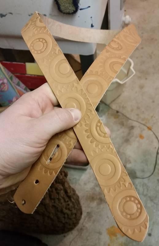

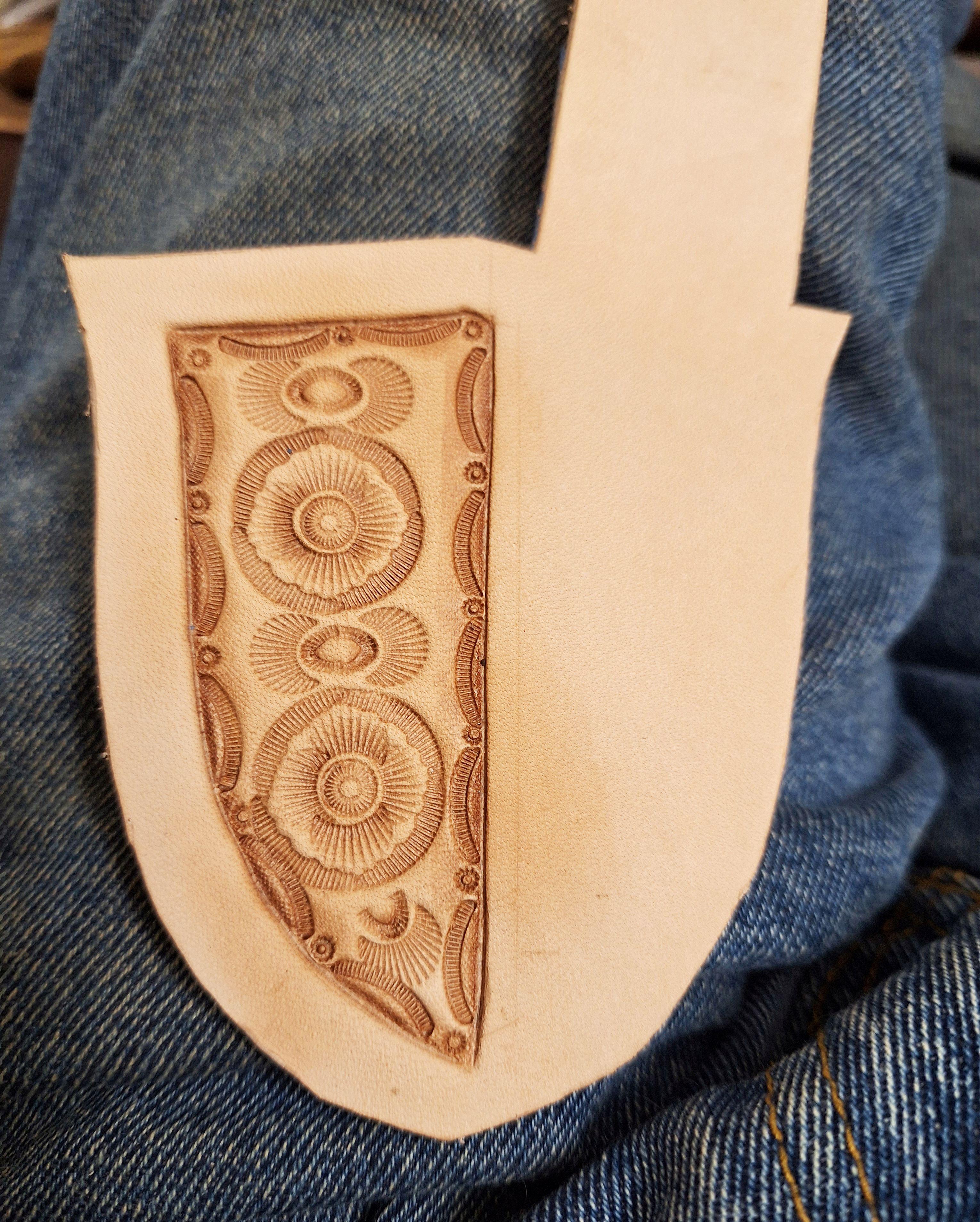

  2. I haven't done a lot of Sheridan style, but I did read the book, lol. Found it on ebay about 6 months back. The book says start with your circles and lay them out, then add the flowers inside, they take up most of the circle. then add the leaves and stumps and such using the circles as reference for your flow of the pattern. What I see in the book is very little negative space between the circles. Sheridan is a very busy looking type of pattern with everything close, touching and overlapping. So you need to enlarge your circles and flowers to fill up that negative space, then your problem will disappear. If it were me, I would make my flowers larger, relocate them so they fill the area a bit more randomly, they are three rows all in a straight line so kind of boring layout. Cut some circles out of paper and use them to lay out your pattern first, move them around to get a good, interesting pattern, then go for the flowers, and then lay in your leaves and such. Hope that helps a bit.

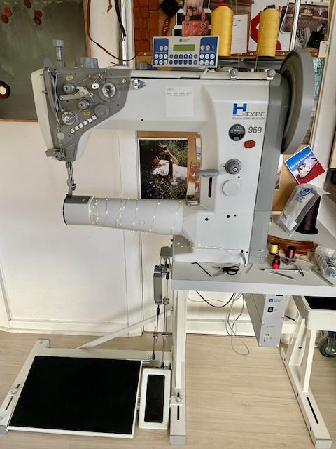

  3. So long story short. I make and repair bags. mostly Louis Vuitton. Contacted a Adler reseller. Said I had a Pfaff 335, and she could not keep up with thicker threads. 20 (TEX 135) and needed an upgrade. So they sold me this beast of a machine. They assured me it was the right fit. first problem I ran into, other then the machine only came with R needles. is that its not possible to get a 140 LR needle for the damn thing. and that is my go to needle for 20 thread. I dont mind overkill. but what other problems might I run into down the line? Sewing with bigger threads it not a problem oc.

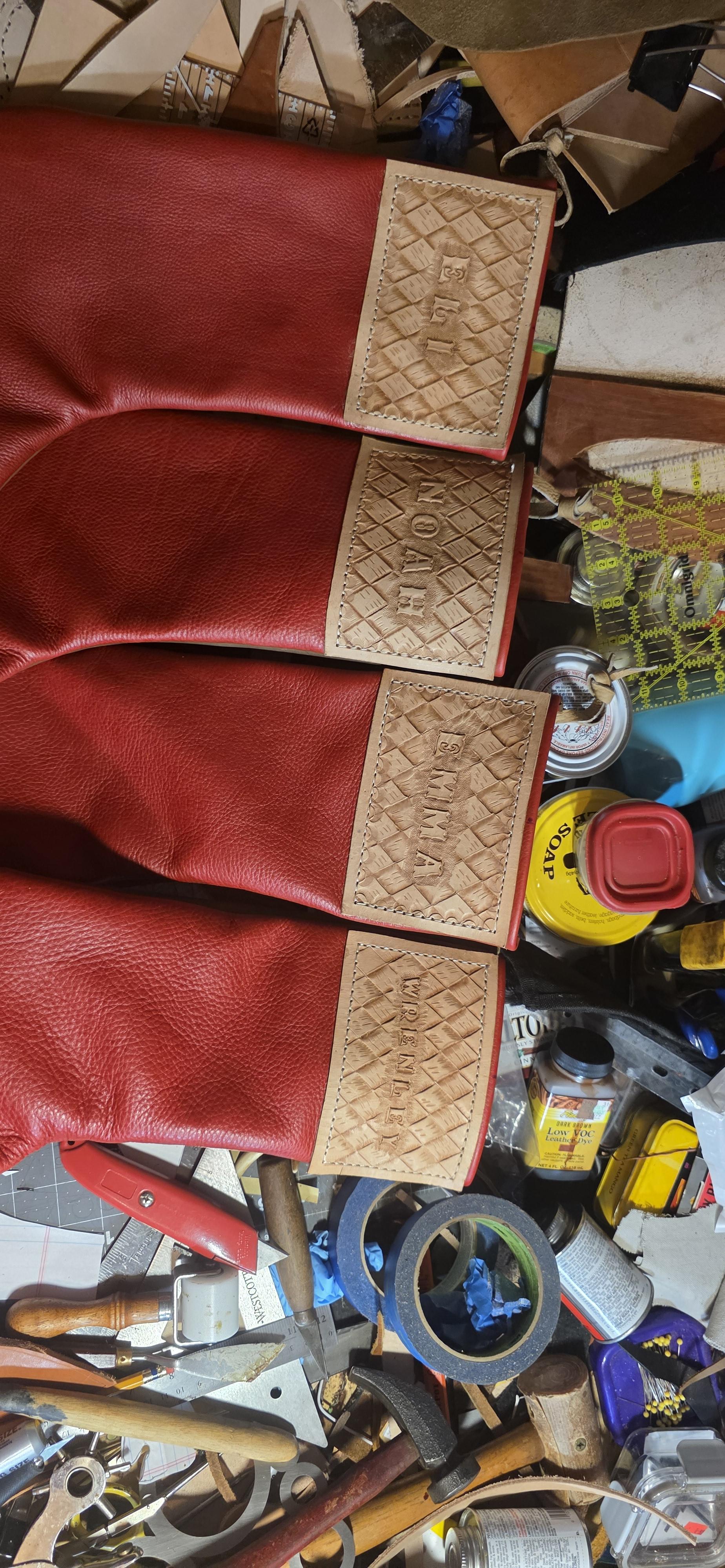

  5. Those are lookin good!!! ! Merry Christmas

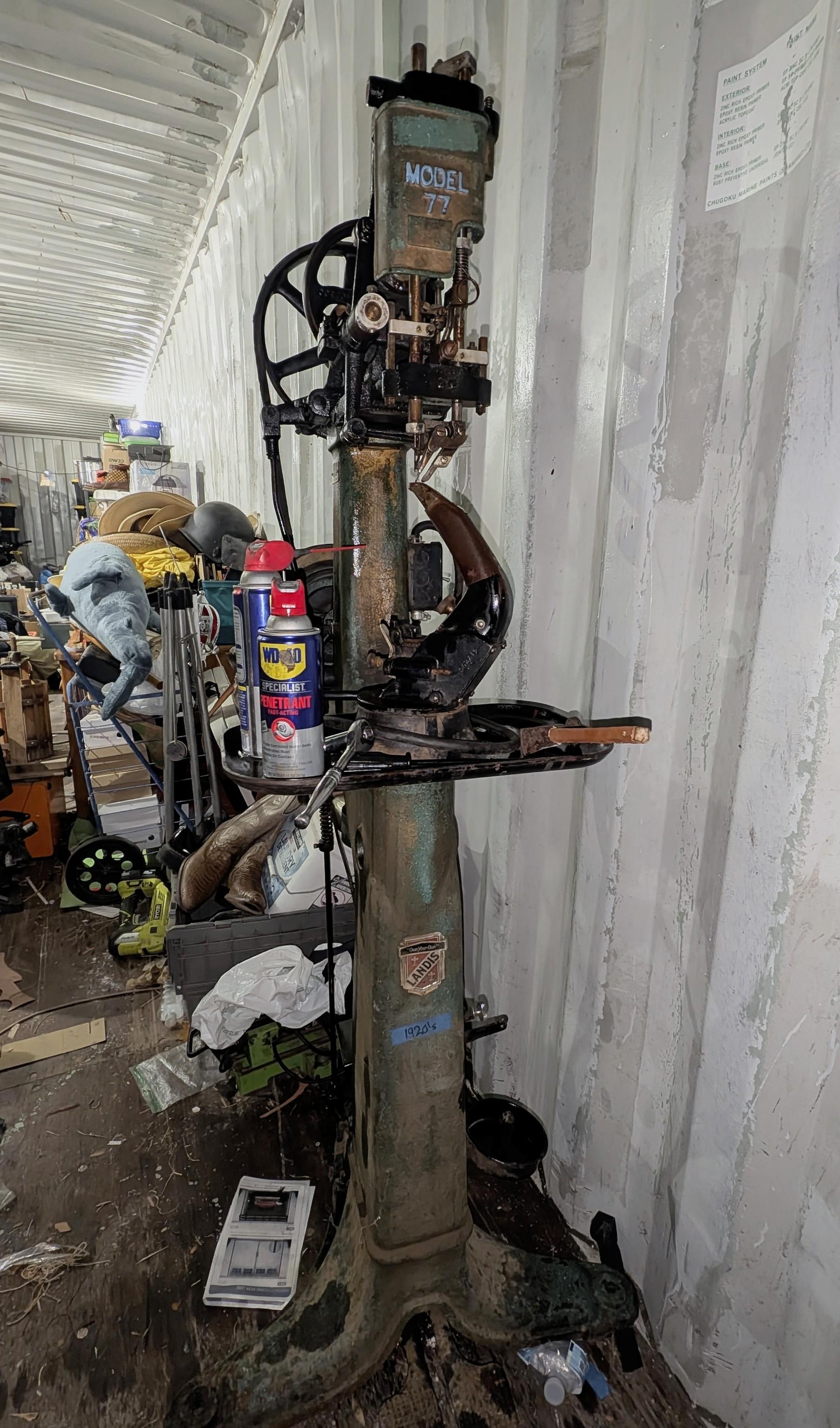

  9. I do infact want to get into cobbler's work I am also leaning cordwaining. I knew what the machine was when I saw it. I couldn't believe my eyes (don't know why someone would throw it away) I was just wondering if a machine like this could be used for anything else.

  11. The Machine is called a Blake stitcher or McKay stitcher . It is used for sewing the soles on a shoe from the inside . In my opinion its is an inferior way of making a shoe compared to a goodyear welt . It is however quicker than goodyear because it eliminates some material and and shortens the process . The Italians love them and some of the chinese shoes are made using the process. As for other uses i cant think of any but don't let that stop you buying it . At the very least it is a cool looking machine and will clean up nice . Get them to throw in the cobblers hammer sitting on it as part of the deal . If it was in Australia i would pick it up as a repair machine and share it with 3 other cobblers i know . Between 4 of us i can't see it being used more than once a fortnight .

  17. Made a few things for Christmas..

  21. I went to the city dump to throw away some trash and I came home with this Beauty. It's all locked up but I think I can free it up. I am learning how to make shoes but I also make other things. So I was wondering. If I can get this machine going, what else can they be used for?

  24. I had a roll of 12V warm white LEDs from superbrightleds.com that were left over from under cabinet lights in the kitchen. I just cut off 6 inches & connected to a 12v power supply I had in the parts bin. Amazon has six inch sections of LED strip also. If I was purchasing new I would probably get daylight instead of the warm white.
