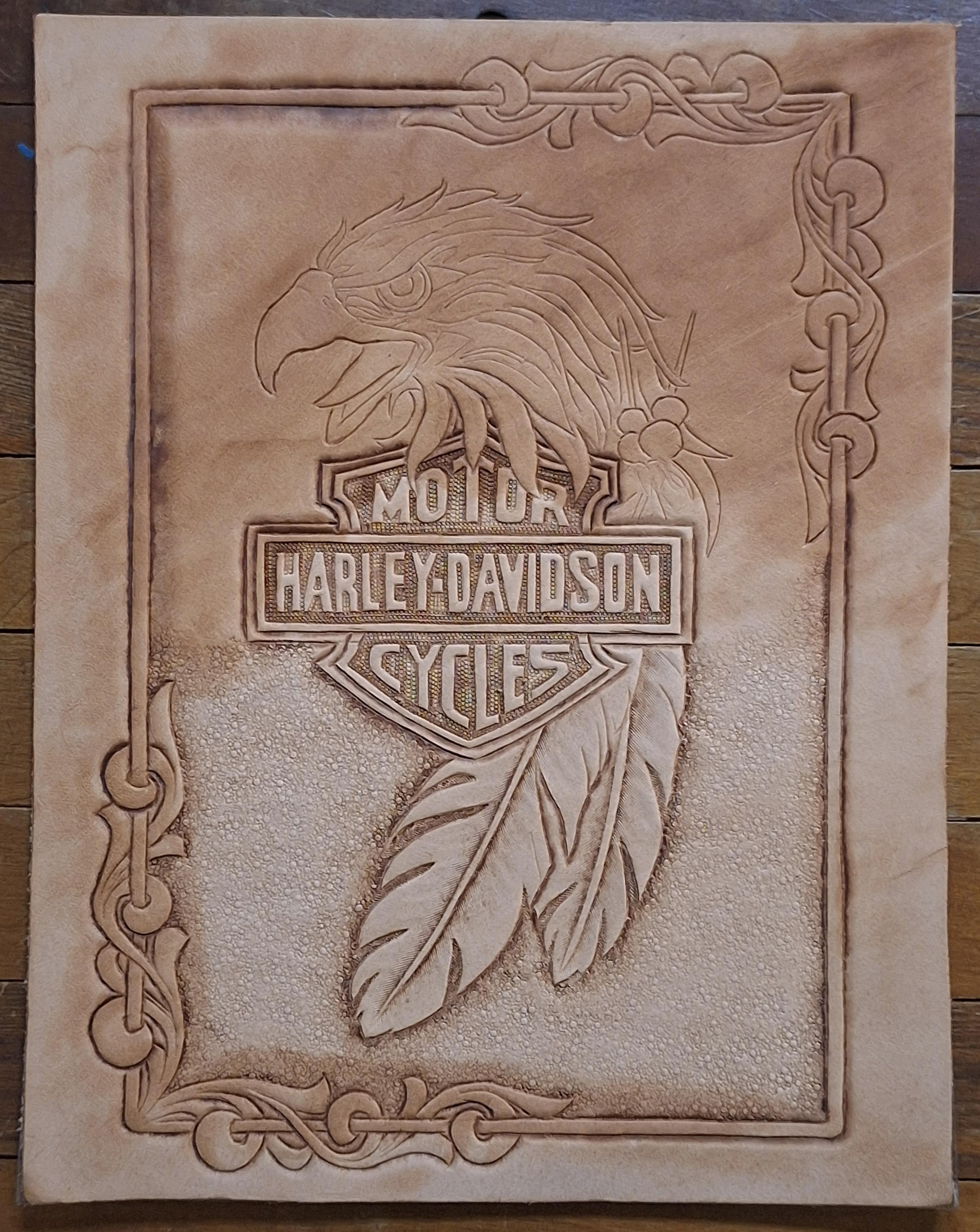

As big a part as Harley Davidson played in my fathers and my life, this is the first piece of that life. it is 8 x 11 inches and it will most likelyy be painted. No hurry on this one taking time and enjoying the memories.
