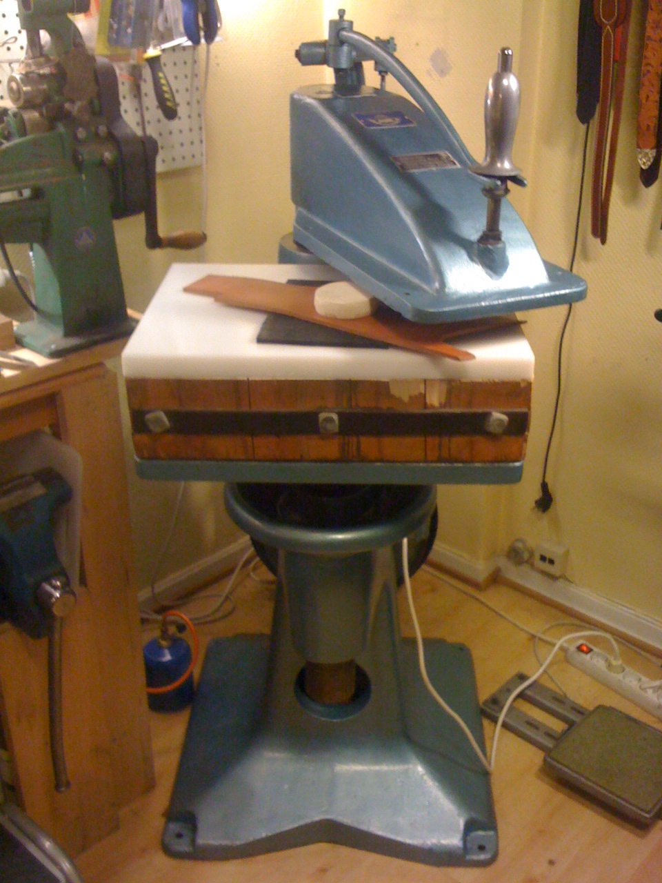

Thank you Tom, If anybody can do it, you can. Its a simple construction. The secret lays in the big heavy flywheels motion, that exchanges in to a short movement of the press head, true a crank that moves the big column up and down. The (bicycle) crank works as a gear/exchange arm. A small stud with a spring loaded return comes out and lock the big flywheel to the main shaft when you activates it. Its kind of an reversed bicycle mechanism. Here you see the development history of their machines, http://www.schoen-sandt.com/company/about-us/development-of-cutting-machines.html I have seen people still uses the first kind of press; the 1867 screw press. They rapidly spin the big wheel to make it more powerful, Its mostly used for embossing. You still find it in Asia and Africa, I have seen they put more weight on the wheel and extend its diameter to make it more powerful. I wonder where all these old mechanical and electro mechanical presses are today, they are maybe been turned in to nails. Its about impossible to break their sturdy construction. Its possible some hidden around in basement and barns somewhere, all you got to do is looking. I know this one works very well.

Hi all, now the machine is up and running. I have given it a clean up and a fresh layer of Hammerite paint, rebuilt the motor to a single phase. To ensure the motor got the same power as on 3 phase, it now has two big capacitors 2 times 50 µF. I have a friend who rebuild electrical motors, he brought new life in to this machine. This is not a hydraulic but a electro mechanical machine, it has a short and powerful blow. Sandt started to make hydraulic presses around 1950, this is a 53 model and probably the last of its kind (from Sandt). I have planed the wooden clicker board and supplied a 1 inch poly board on top of it. I have used it with knifes and Bunkhouse embossing plates and it works very well. I am looking for European sources for embossing plates and clicking dies, all tips will be much appreciated. Thanks Tor
