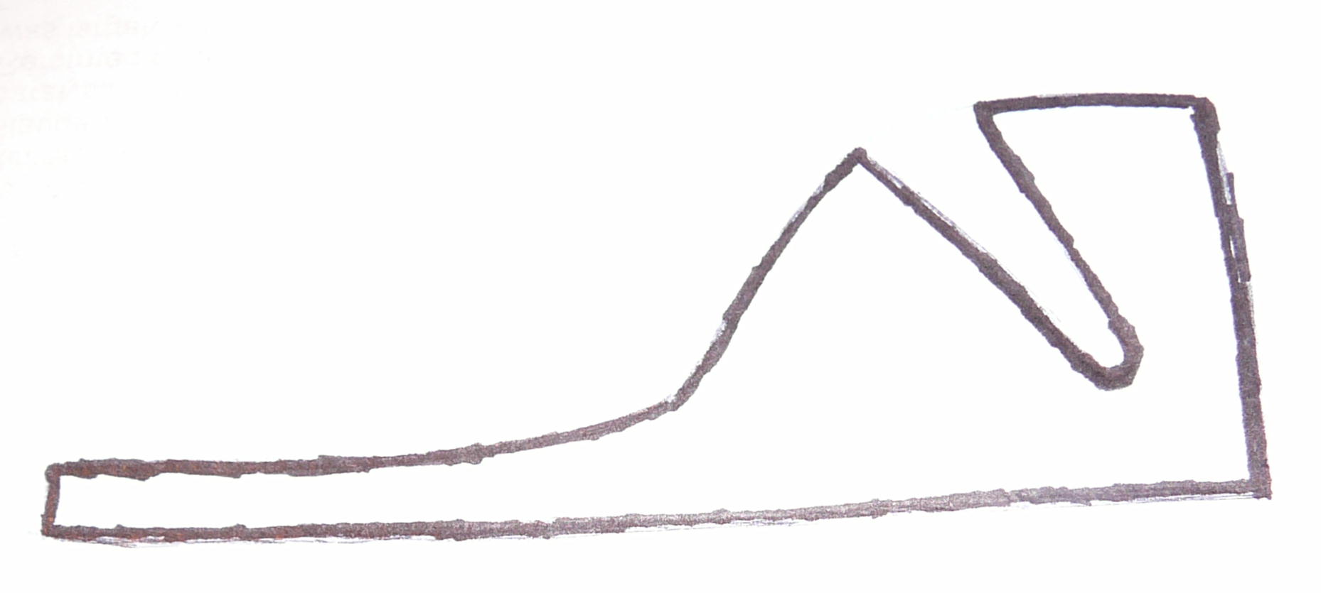

Here's a quick, very rought sketch of the "belt hanger" --- about 1/4 inch of the small end sits on the edge of a table, and the weight of the belt pulls the outer end up and keeps it from falling. All depending on the angle of the notch and the weight of the belt. -

When I was a kid "back in the dark ages", we used to whittle those out of the wooden ends of cigar boxes (how long ago was that? lol). Only name I ever remember hearing them called was a "whimmy diddle", or somethng like that. We used to make them about 4 or 5 inches long and about 1.5 or 2 inches high, curving down to about 1/4 inch high at the end that sits on the table. The notch sloped from the top towards the bottom outside end, at about a 60 degree angle, if I remember right. Probably need to do some experimenting - a good bit depends on the width and weight of the belt, and you have to play with it a bit to get the weight of the belt balanced on each side (nearly impossible with a buckle attached, unless its very light weight). It should be flat on the bottom to help with balance. If I can help more, please PM me. -
