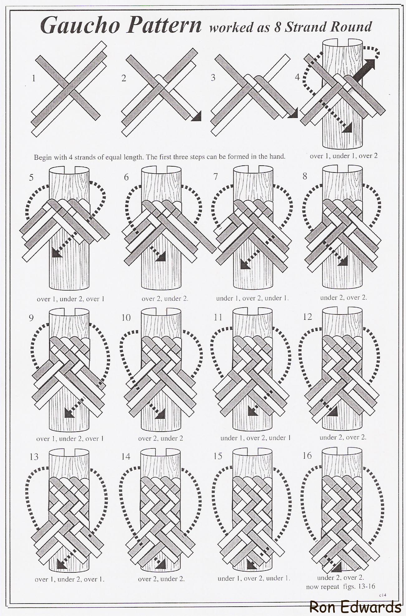

  10. On step 4, the very last one is where the over 2, under 2 kicks off. Steps 5-8 are the setup process for the over 2, under 2. Steps 9-12 are the building parts to get the repetitive over 2, under 2 going. Once you get to step 16 just repeat steps 13 - 16 till you get the length you desire and tie off, or end the braid by back braiding every other end that is going to your right leaving the other end just hanging there. Once the back braid is completed then you can take the loose ends and pull them tight and cut off to hide. It gets easier as you do it more.

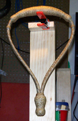

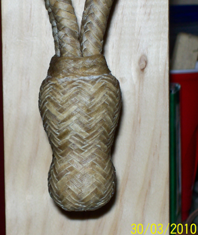

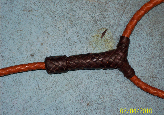

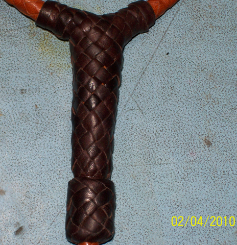

  16. I kind of doubt that the "T" is anything new. I'm pretty sure that someone else before me did that. However, I have not been able to find any references to such a splice in any of my books. But there are a lot of possibilities with making different patterns possible. I know that I have made a single strand T shaped casa knot. But for the purpose, I needed something a bit longer and more flexible in design and forgiving with mistakes. LOL... Before I closed that " T " off I explored just a few of the patterns that I could do with such a braid as that. I had the herringbone and the gaucho patterns achieved just to see if the patterns could be done with that many strands, or that count of strands. But I had to consider the time that it would take to do the different patterns and decided to just do the basket weave and then close it off with a multi-stranded button knot. I am going to create a T from some scrap wood dowels and start exploring the patterns that I can get with such a braid at different lace counts and note them in my journal with photos. Thanks to all for you kind comments. Brian...
  17. Thank you all... I forgot to mention that the material used is kangaroo hide. That project is one that had my weee off hours consumed and if those hours would have been a cheap wood for a wood burner to keep me warm, I would've ran out of that wood long before the cold. LOL... I fun with this one. I made my notes for it so I can duplicate it. I would like to see a few orders come in after that one gets displayed by my boss and his wife. This one was a fun one to make for sure. A little time consuming but worth it. Thing I discovered is that " T " on the handle would be considered a premium addition to the leash, " $$$$ " if ya know what I mean. LOL... I think that my braiding mentor will be glad to see this piece of work. I will have to send a few photos to him today. Thanks to all for your kind comments. Duke; I have been braiding for quite some time now. But to encourage you to continue with braiding I will tell you this, I was on the 4 strand round braids for a year before I moved on to any other braid. As an artist, I required from myself the best possible braids I could do, which meant to me that the 4 strand round braids had to be almost mastered. Brian...
  18. This one here is one that I have been consumed by for the past 2 weeks. Braid: 8 strand Gaucho braid, worked as an 8 strand round braid. Handle: Done in two segments. I spliced the handle to the leash itself. The brown T you see, is what I have deemed in my own vocabulary The Split T Splice Braid of a total 16 strands. At the clip you will see where I brought the flat braid over the top and combined the back and front of the flat braid to make a round braid to start the Gaucho Braiding process. The button knot is a 2 pass type 1 PK. Hope you all like it. Brian...
  19. KnotHead
    A Bosal
