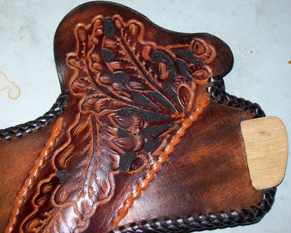

You're welcome. But the authors are the ones who deserve it more than Ido. Especially my friend Bud who made those tutorials. He's now passedaway. But lives on through his instructions. He also was a hide pounderas well as a good braider. He also, turned all of his own marlin spikesand fids as well as sending me a bunch of tools like that. I have asample piece of his hide pounding in the form of a leather holster madefor a 9mm. I have attached a few images of that holster he made. I plan on using it some day. ehehehehe... Freedom aint free...
