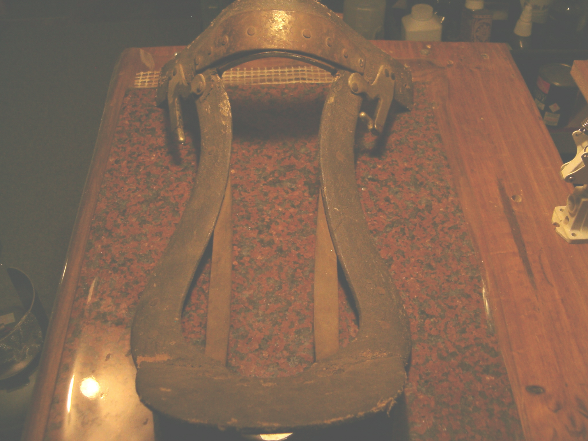

Last pic. Here I have placed the bellies back onto the cantle. The saddler then tacks them in place. If you can see lots of little dots, this is where the old tacks used to be. When you say you have 2" of movement then something is adrift. It could be a broken tree or it could be just the bellies have come loose. Place one hand on the cantle and the other hand behind the cantle. Move the hand on top back and forth and you are more than likely getting the movement you describe. If you feel that nothing is moving away from the hand that you placed behind the cantle, then more than likely the bellies have come adrift. If everything appears to be moving then the tree is busted. When you say you also have side ways flexion. I am leaning toward a broken tree and the saddle is done. Barra

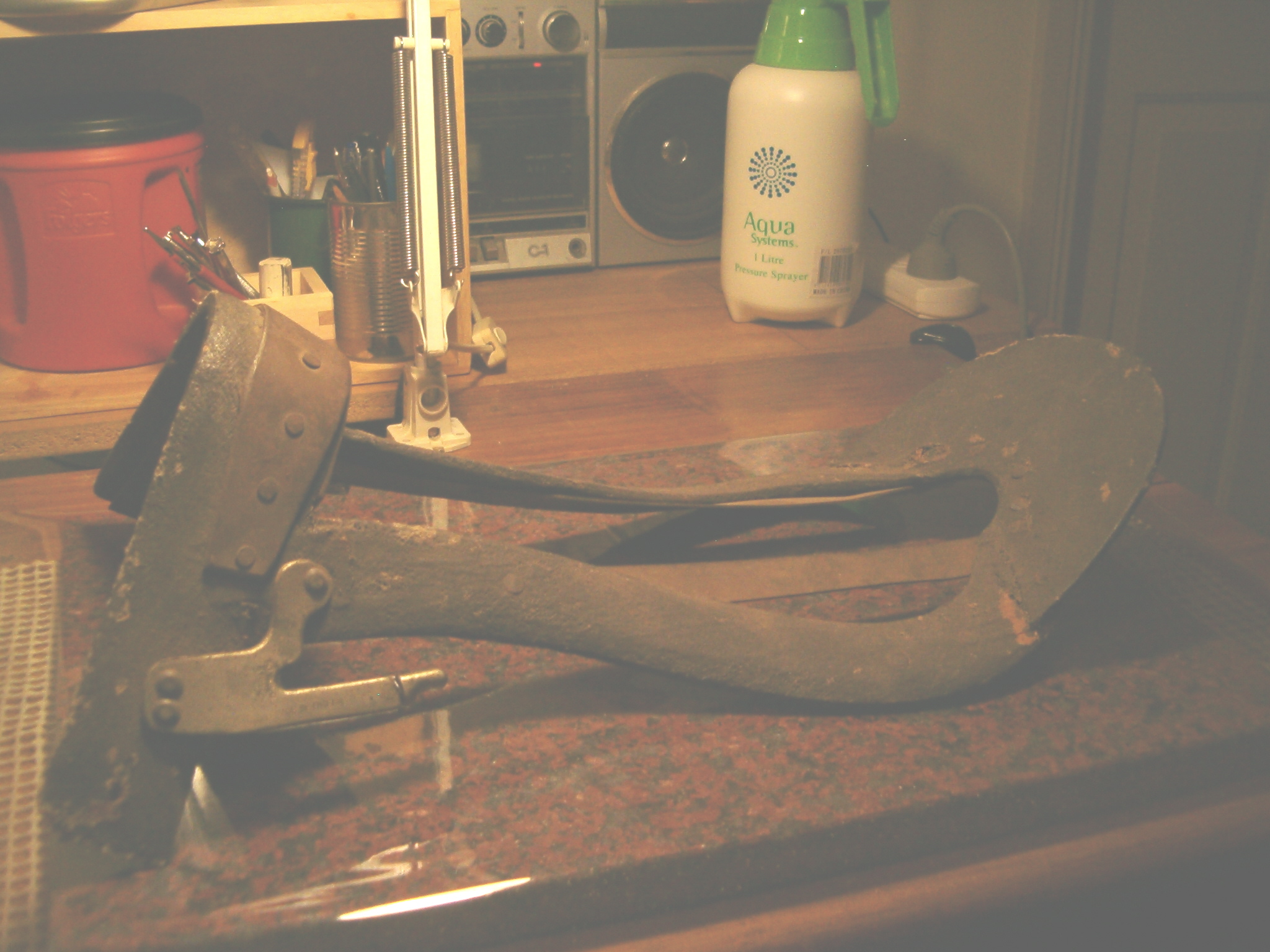

Next. I just saw your reply. When I say Asian indicators I mean normal tell tale signs it was made in Asia (or the sub continent in India/pakistan) which most Australian style saddles on the US market are. OK, these pics. Can you see the cantle on the English tree?. It is a fixed and integral part of the tree. The desired shape of the cantle in both and English and Australian saddle is then built up by the saddler out of leather. These are called the bellies. On the Australian saddles these are far more prominant. On the Australian saddle pic you should be able to see what I suppose appears to be the cantle but is in fact the old bellies. Look just behind this and you should be able to just see what is really the cantle. I just placed the bellies here for illustration purposes. One more pic to come. Barra
Bare with me. My camera flash won't play the game so these pics were taken under a lamp. The pic on the left is an old Australian stock saddle tree and the one on the right is an English spring tree. Both are similar in many respects. Note there are no spring steel bands on the Aussie tree. More to follow. Barra
