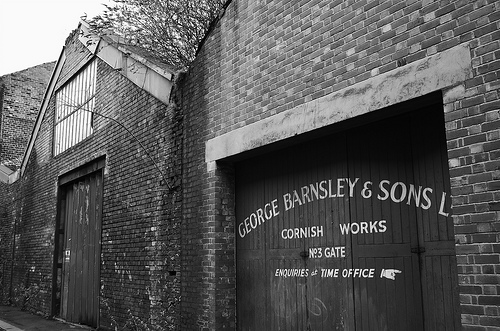

  3. I just google mapped Cornish works Sheffield. Co-Incidentally it is just around the corner from Dixon St. Barra
  4. Ray. I can show you where it was made. Barra

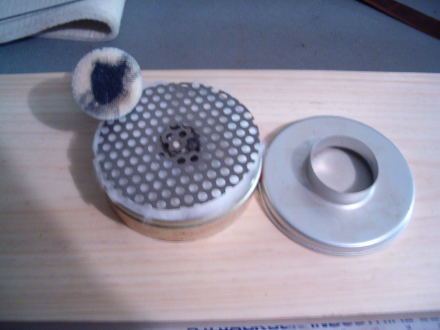

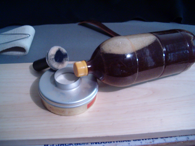

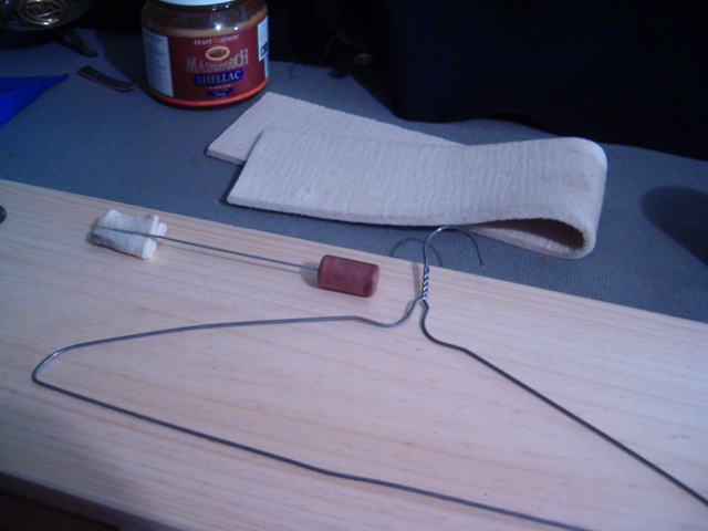

  11. Here are a couple of methods I use to stain edges. Pic 1. I use 1/4" engineers felt and a wire coat hanger. From the one coat hanger I get 2 daubers. I fold the felt and wrap the wire around the felt and then either flatten the wire with a hammer or in a vice. On the other end I shove on a cork to both cover up the jaggered wire I have cut with side cutters and it also forms a handle because the wire on it's own is a bit hard to get a grip. Pic 2. This is a stencilling pad. The tin is full of absorbant gauze. On top of this is that wire triffet looking thing. This has a spring on the bottom of it. The lid has a layer of felt under where the hole is. The dauber has a handle and on the base end is a material a bit like synthetic shearling. By dabbing the dauber into the hole in the lid, you are pushing on the spring loaded wire triffet, which pumps the dye/stain onto the shearling of the dauber. Pic 3. Pour the stain into the hole in the lid. When done the hole has a cap so the stain does not evaporate. Pic 4. The home made coat hanger dauber method. My stains are in salsa jars that have a plastic coating inside the lid. If the lid was metal you would eventually get rust in your stain. Dip the dauber in stain and wipe off the excess on the jar lip. The felt slightly conforms to the shap of the leather when applying the stain. Pic 5. Not a very good pic of a quickly burnished scrap of leather after a few licks with my rub rag. I would normally do a few more things to get a nicer burnished edge. I also have a few large felt markers like pictured in the link. You can refill them. http://www.thepenstore.com.au/category168_1.htm Barra

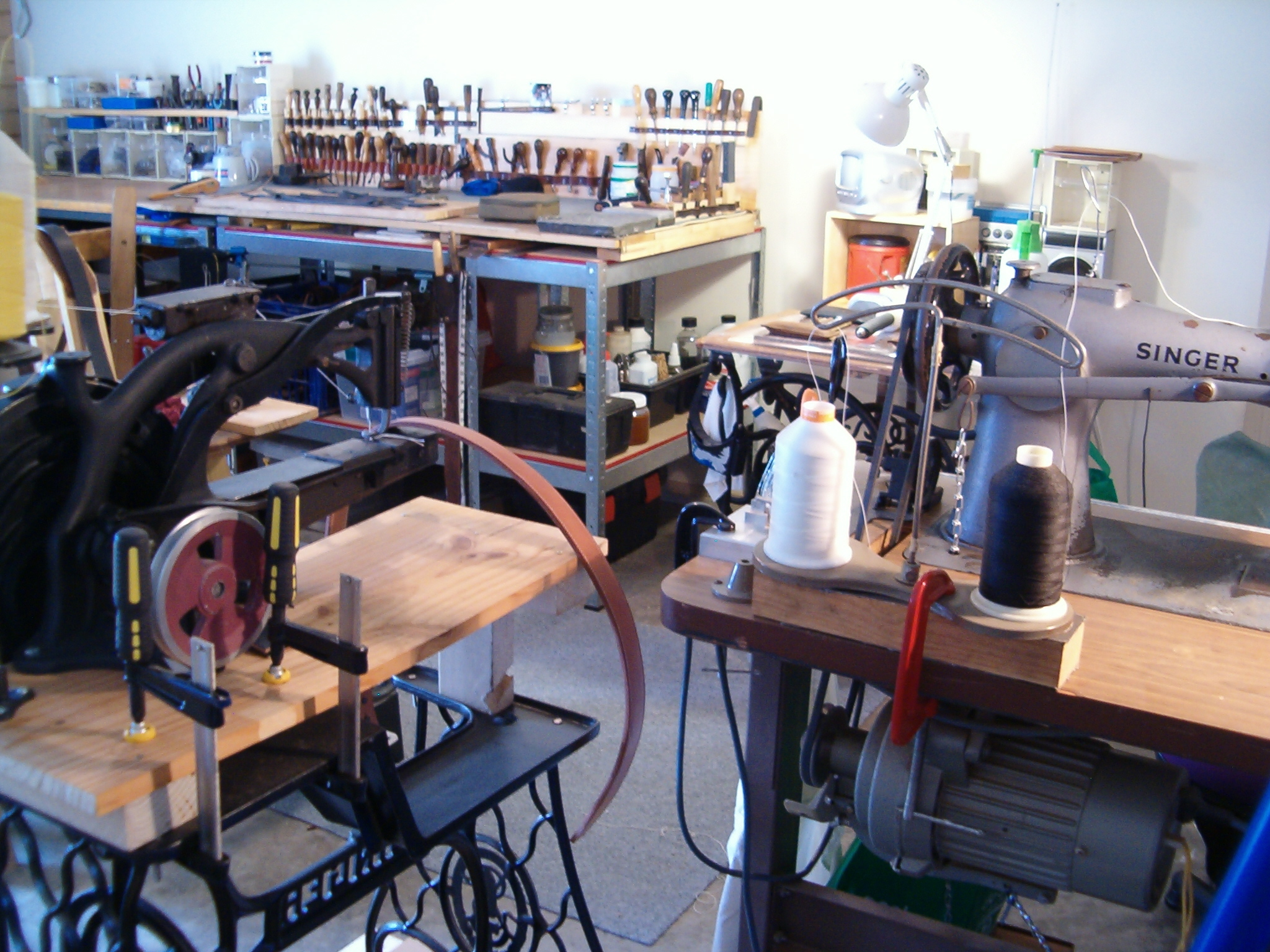

  16. Henry. That is my Jones stitcher. Yeah it kinda is a hodge podge of machines. At the moment it is mounted on my 29K13 boot patcher treadle base and that is on wheels. The actual Jones treadle base has had a new top put on it and because it is so solid has become my stamp bench. With the Jones the thread must feed off the spool from the side, so in this case the spool spins. The top thread then feeds thru the wax pot, around 2 tensioning posts before heading to the needle. Any attempt to feed it off the top and it has a fit. I have tried all sorts like cannabalising thread tension discs of other machines and cranking the discs right up. Barra

  18. The top thread needs to feed from the top of the spool. Of course the attached pic is not a consew but the principal is the same. Can you see the white thread coming off the top of the spool, over the thread guide before it heads to the thread guides that are actually on the machine. Barra
