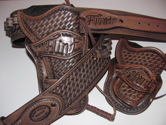

Thank you Mike and JW! Bluesman, thank you and you are correct on the lettering. Just cut with a swivel knife, well, I did also use a "stop" stamp on a few of the ends to clean it up. Best regards, Josh -

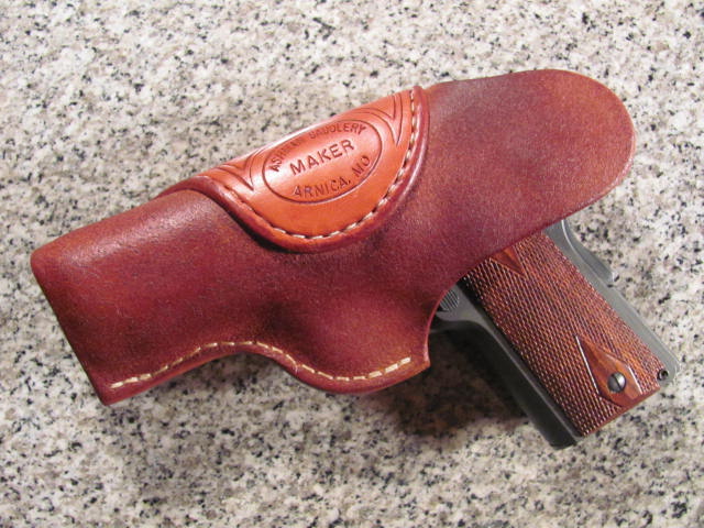

Thank you Madadh. I do have a pattern for the tuckable, but I don't have it with me. I'd be happy to bring it in to work with me tomorrow and send it to you. Just FYI, it'd probably be just as easy for you to make your own, then you can fit any gun you want. I basically just follow the Al Stohlman holster instructions (you can get his book from Tandy) and tweak it a little to get whatever I'm making. For the tuckable I outlined the pistol on a folded piece of paper, added 5/8" to get the main seam ( I usually go with 3/4", but I wanted this quite snug), sketched in the slide cover and top where they looked balanced then sketched in the throat reinforcement/clip cover and done. I used a 14 oz. welt at the main seam when I put it all together, pretty simple really. Anyway, I'm more than happy to send you my pattern. I'll try to get it to you tomorrow. Texas Jack, you sir are correct! I appreciate your input. That holster happened to be for me and if I make another one I'll refrain from wrapping the throat. Best regards, Josh -

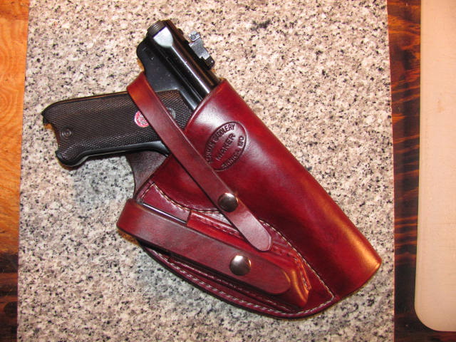

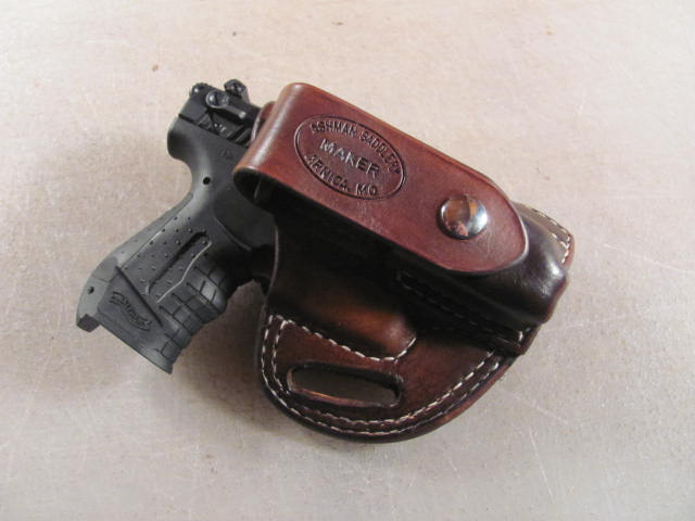

Field holsters with mag pouches for a Walther P22 and Ruger Mark III and a tuckable (is that what other people call them???) for a 3-1/2" 1911 . All made out of 8 oz. HO with Fiebrings Oil Dye mixed with neatsfoot oil and topped with Aussie Wax. Let me know what you think, thanks for looking. Josh

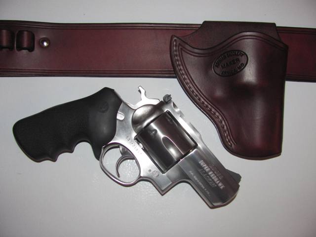

These were made as a surprise birthday present. I had the guns long enough to make paper outlines then I fit the pistols in when they were picked up. The holsters, belt and billets are 11 oz. HO and the bullet loops are 7 oz. HO. They were dyed (stained?) with Fiebrings black liquid antique and finished with Leather Balm w/Atom Wax. Just FYI, if you use LBwAW over liquid antique you'll wipe quite a bit of the stain off and streak it quite a bit in the process. Anyway, I'm mostly happy with how these turned out. Let me know what you think. Thanks for looking, Josh

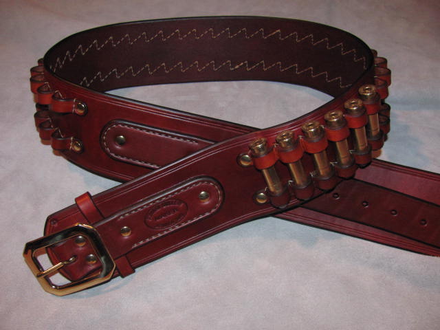

I thought this turned out pretty nice. The main belt and billets are 11 oz. HO and the bullet loops are 7 oz. HO. It's dyed with a mixture of Fiebings British Tan and Dark Brown thinnned with neatsfoot oil. Finished off with some Aussie Wax and a little glycerine saddle soap to shine it up. Let me know what you all think, thanks for looking. Josh
