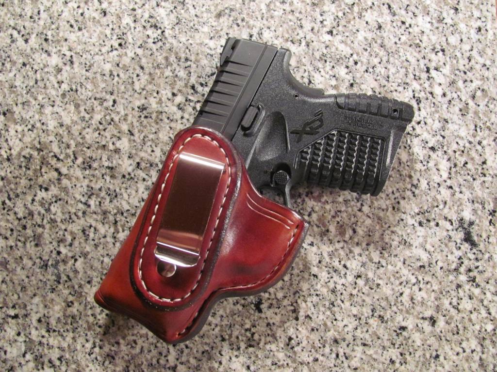

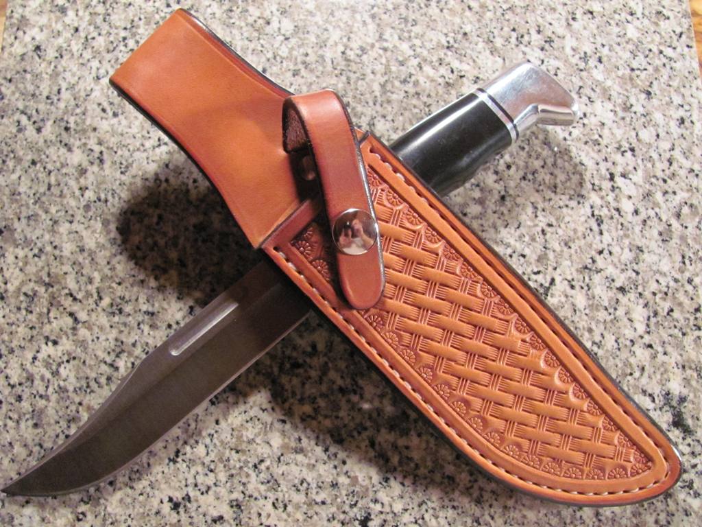

I've been working on a saddle but had to take a week off to knock out a few things that couldn't wait any longer. Since I was putting pics on the computer I figured I'd share these too. Here are a few knife sheathes. The ones for the dagger and skinner were made off of tracings I did while I was out in UT for the Holiday's so no knives to show with them :-( Here are two lefty IWB holsters, same basic thing just for different guns.

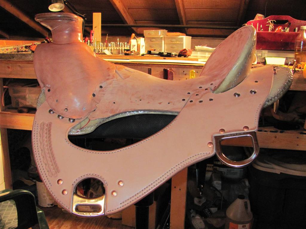

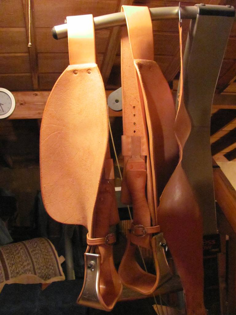

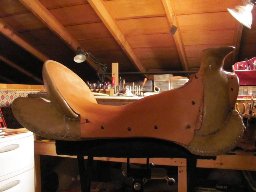

A year and a half after saddle #2 was finished I started #3, here are a few progress pics. I only work leather in the early mornings before my "real" job and a little on the weekends so this represents about 2 weeks worth of work. The saddle is for my wife and I'm hoping to be done by Valentines day, we'll see how that works out. Anyway, it's on a Bowden tree with 14/16 HO. I'll post some more pics when it gets finished. Hope everybody has a good weekend! Josh
