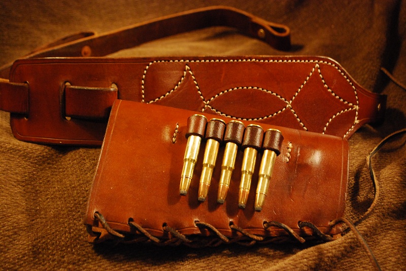

Wanted to try a new border stamp out. I hit two soft spots in the leather tooling these two pieces and they really jump out at me. I hope it isn't as bad for you! I'm still making some stupid mistakes, the biggest is not leaving enough fluff room on my edges leaving the thread uncomfortably close after dressing. One day I'll learn... As always suggestions welcome. The next personal project will be a Plains Style BBQ Gun belt.

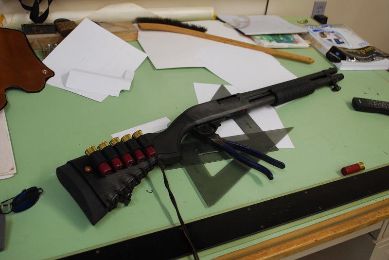

Thank you Guy, I guess I need to try a band for this. I have seen the totally capped ends but frankly even though I understand the molding process I don't have any idea how to go about stitching that. Regarding the shotgun I think the combination of no real 'grip' on the rough side of the leather and the synthetic stock are allowing it a little play. This is why I was considering lining the piece for a little more grab.

Hey everyone, I've tried two of these and haven't been 100% happy with either of them thus far. My two major problems are this: 1) the ammo belt itself even after pulling tight with pliers loosens up almost immediately, and 2) unless laced extremely (almost uncomfortably) tight the cuff itself wants to shift forward. I have no solution for the first issue but was thinking either a rough out or lined cuff would solve the slipping issue? Any help is appreciated!
