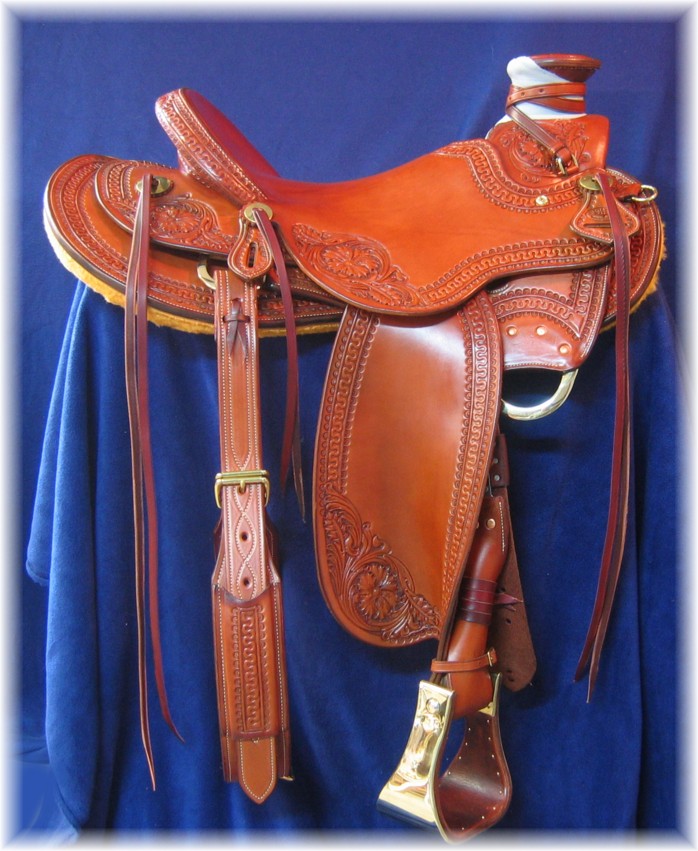

As a matter of fact, I got out the shop vac just before doing the final pics of this saddle. The pics that show the a bit of the shop don't show the mess that is normally piled pretty high when I'm in the middle of a saddle. I try to keep the floor swept up after I carve out a seat because there is a lot of scraps and shavings on the floor. I like to be able to glance around the floor when I come in and spot any kritters like scorpions and the like so I can get out the bug killer. But, seriously, a clean work space makes for a clean project. I try to clean as I go. Thanks Luke, I gave it a good coat of Tan Kote. And thanks to all for the very kind words and compliments. I put this one on "FeeBay" so, we'll see how the not-so bipartisan Democrat Spendulous Package is working so far.

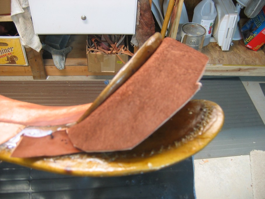

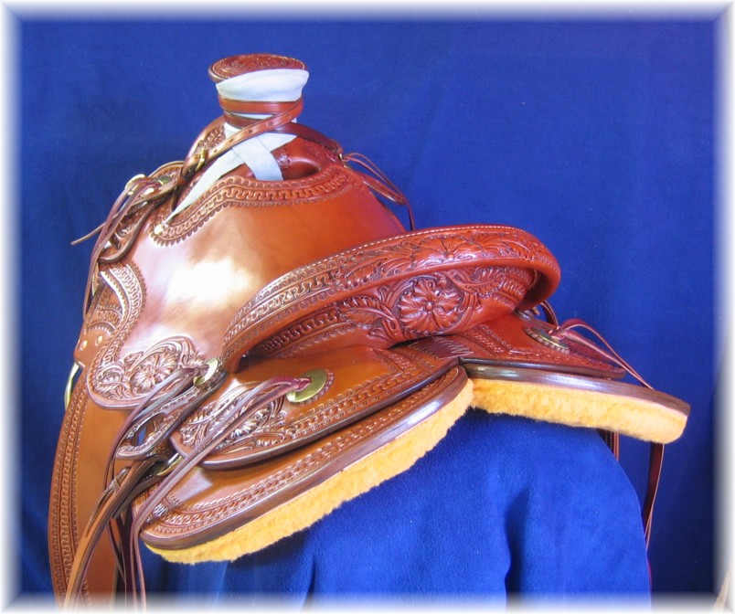

Just to show ya'll that I have actually been doing something besides playing on the Leatherworker forum............. Got all the goodies on this one. Bork hardware, W&C chestnut leather, Weber 4" brass bell stirrups, Weaver shearling wool, built on a Ben Swanke tree, my first from him and I really enjoyed it. What a nice tree! I think I'm hooked. I included some contruction pics to show how I layed this cantle back and the sharper break, though not perfect, the importance of the groundwork became crystal clear on this one.
Excellent work. What did you use for your cantle binding? It matches your seat inlay, so I assume it's not just dyed.
Very nice work. Classic lines. Gotta love that one.
