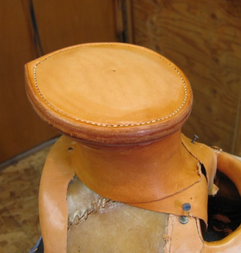

Regards keeping the horn small, try splitting your leather pieces down a bit. The middle, or filler piece, doesn't need to be thick at all. I temper it really well, so it's nice and hard. Then, when you are pressing the edges together with the pliers, try to get the crease line as close to the horn as possible and stitch as close as possible too. You can pound with a hammer on the area of the crease to make it thinner also. After you do your initial fitting of the bottom piece, establishing the location of the fold and stitch line, take it off and pound it down on the flesh side with a hammer. After stitching, cut the excess off as close as you can to the stitches without compromising it and that's about the best you can do about the size, that I've found. As to the fork cover horn hole on a big horn, the only way to do it without a split that I've seen is to cover the horn after coving the fork. If there is a way, I'd sure like to see how it's done.

Jake, I tried it with kinda the same idea. I took the top piece with the wings and made it the bottom piece but I didn't cut the cap off. Of course, it is then reversed to show the grain side. The pattern will have to be worked out with scrap for the particular horn, but you will get the idea after you try it. The wings are cut and skived where they overlap at the back so they lay as smooth as possble, (that's the tough part). But, you leave enough leather to fold out flat all around, including the overlap area in back. There will be a very slight line where it overlaps but that gets covered with your horn wrap later. It's no worse than the line where the horn wings overlap, so I think it's not a problem. I guess you could try to butt together in the back rather than overlap, but you'd still have a line there. Anyhow, from there, you do a full round filler and then your full round cap and stitch 'em all three together. I don't have a pic of the bottom piece pattern with wings to show ya, but I do have one of the finished join.
OK, I see now. Thanks. One question though. Why a donut and not just a regular filler? Does your wing piece go up under the donut? If it's not attached, seems like you could just use a full filler piece and tack it down. Must be something I'm not getting.
