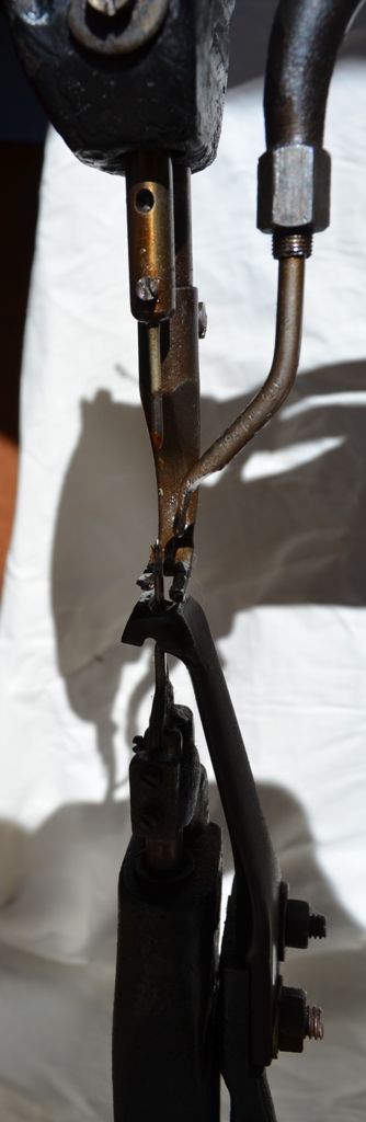

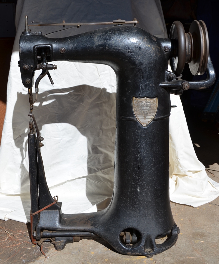

Pretty but the casting looks too light for anything serious.
Hi mate, It is a clutch motor - 1425RPM fitted with a 50mm drive pulley. The original balance wheel had a very small diameter pulley and I have replaced this with a larger diameter one. Upholstery leather is very soft so 5-6mm should not be an issue. I have been testing it with 4-5mm of harder leather. The machine is set up to use DPX16 needles and maximum size on top is a 22g with #138. People sometimes run #207 through these machines but I stick with the more conservative suggestion. Unfortunately the machine may be sold. The buyer has gone quiet but I will give him some more time to contact me. Darren Brosowski 0415 353 748
I have my doubts about it being a true Mitsubishi. It is probably a Chinese built clone of a Mitsubishi.
