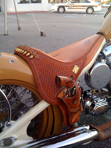

It was sent to me from Florida LOL. I wonder if it was enlarged in HD if we could make out the name on the police car? Blake
I don't know who made this seat but the picture was sent to me by a friend . I thought it was pretty neat and wanted to share it with the group. My compliments to the maker. Blake
