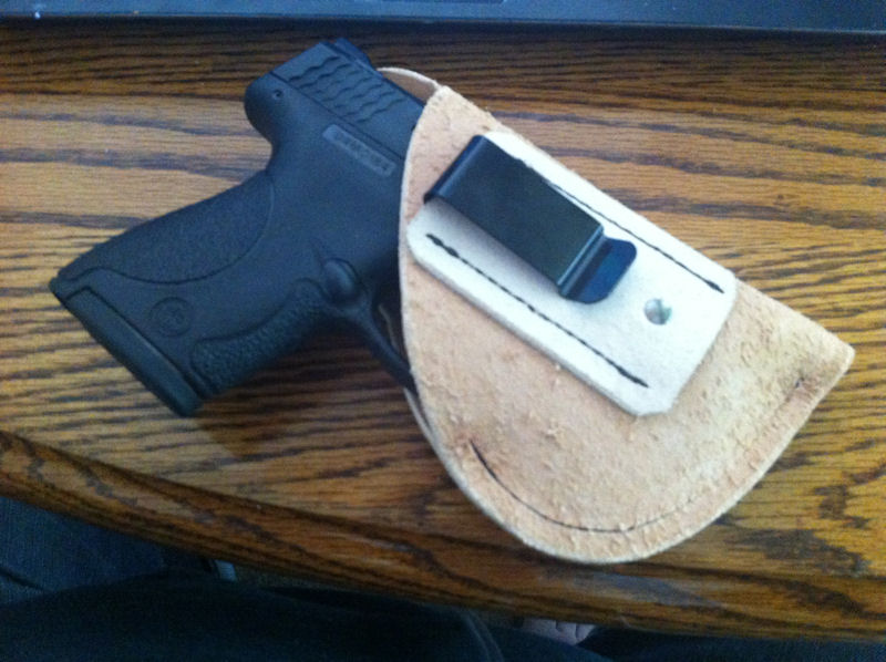

On a personal level I do not see the need for the ability to do a tactical re-holster on a concealed personal defense weapon. At the range my holster is rigid leather with a reenforced throat. I pull the gun and re-holster is several times while at the range. When I carry for PD I do not see my pulling it unless I need to. At that point I really do not have to worry about being able to put it back with one hand. Thank being said I carry this one at 1:00 so its easier to not have it held open. My avenger and my avenger style IWB that I carry at 3:00 does stay open. Its all a matter of taste I guess. Thanks for the info. Michael -

Yep they are similar. I see you used the next size up clip. I had both and just went with the smaller one. Both seem to work well. Thanks for sharing your holster. I like the design. I skipped the reinforcement piece on mine. It stays open pretty well and on an IWB that I carry at 1 oclock I tend to not worry about tactical re-holstering. I will add it if anyone wants one that way. Heck Ill dye it purple with red and green leds for the right price. There are no holsters for the Shield in town so I am hoping to generate some work before the big boys catch up with production. Have you had a chance to shoot the Shield. Its a really nice gun and very accurate for a 3 inch barrel. I have decided to make it my carry weapon when my permit comes through. I am on day 62 or 90 day wait for that. Ive got a M&P 9mm FS, the 9C and now the Shield and I like the shield the best. Michael -

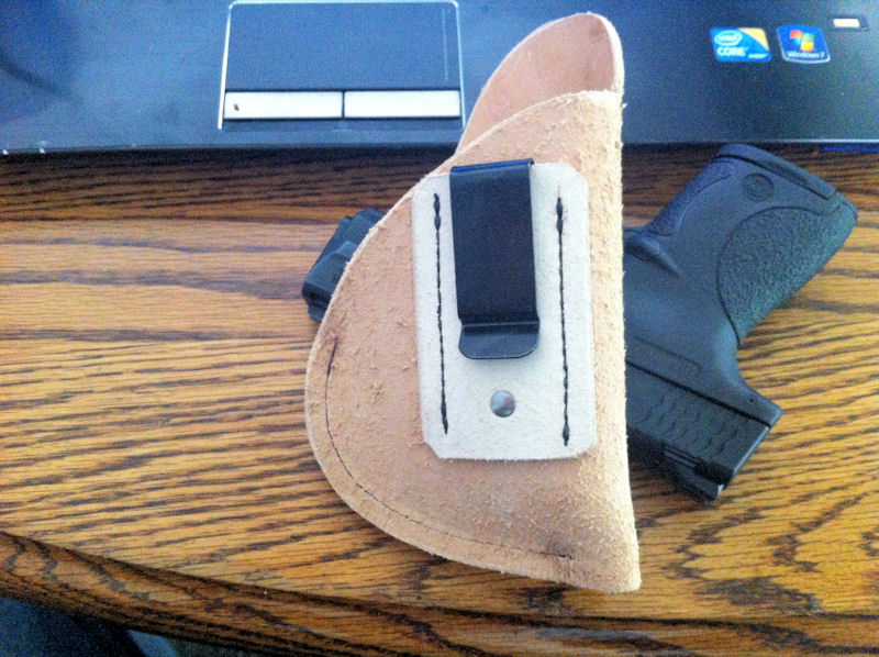

Rick, It's not molded at all. With the rough out and the belt against the holster there is no problem with the retention. The stitch lines are close enough that I can turn the holster upside down and shake it and the weapon stays put. The clip is a great way to hold the holster against the belt. So far the only think I have found is the holster might ride a little too low. It may be just a little to close to the top of the belt to get aq good grip on the gun for removal. Ill try it for another few days and see. If all goes well my CCW should clear in 30 days and then I can give it a real test. Thanks for the comments. Michael. -

68 views and no comments??? Is it that bad? FYI if you make the pattern you need to round the corners on the top piece that holds clip in place. Also the rivet only goes from the clamp to the top piece. It does not extend into the area the pistol sits in. I know its just a draft but someone must have a comment. Ive worn it all day at 1-2 oclock and its really comfortable. Michael (I know its pathetic to beg for comments but its been a slow week ) -

I got one of the new Smith and Wesson M&P Shield 9mm pistols. It is amazing. Shoots great, fantastic trigger but no holsters yet. So I made an IWB for mine. It used a clip to hold it to the belt and is Rough out. This is the first version of the holster. The edges have not been finished. It was done using some stained scrap 8/9 leather. However it is at the point where all it needs is little adjustments to the edges and a finish. I am pretty happy with the current version. I am including several pictures and the pattern in a PDF format. You are free to use the pattern anyway you like. If you make a change Id like to see the change to see how you improved it. You are free to sell any holsters you make with this pattern. Please do not sell the pattern but you are free to give it away. When you print the PDF file please print it at 99%. This way it will print to the correct size. Let me know any questions or comments you have. When critiquing please remember its a first version and has not been edged or had any finish applied. Im going to ]week or two then make another using any changes i think it needs. SHIELD IWB1 pattern.pdf
