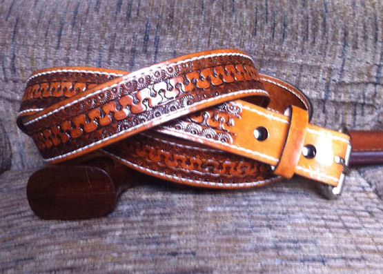

First the belt already exists. Second it was just something I was wondering, one of those questions that if there is no answer its no big deal. I know it would contour at close enough to the same rate as a non-stitched belt that it would not matter. I was just curious about the horizontal stretch. Sometimes I think to much and strange things pop into my head. Thanks both of your for the comments. Michael.
