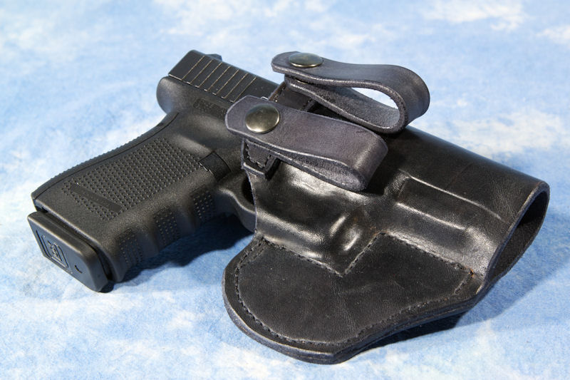

	  Rehab Holstermlapaglia replied to mlapaglia's topic in Gun Holsters, Rifle Slings and Knife Sheathes Thanks everyone for the kind words. Mike.. I thought a long time about that corner.. The Glock 19 trigger guard has a sharp corner at that point. I agree I should have curved it instead. The Boss makes curves so easy Ill have to chalk it up to a bad decision. Ill have to give the glycerine soap a try. Im still using Gum Trag but I'm all for anything that makes it easier. Thanks again, Michael.
	I just spent 9 days in the hospital and then 30 days in bed. This holster was the first thing I did after being out of the shop for 45 days. It has its problems but it is nice to see that after being that sick I can still do something. This was my first IWB and to be honest I used a pattern for a M&P 9C Avenger as my starting point. The edges suck but my strength still isnt to the point that I can do them well since I hand burnish my edges. Its 8/9 HO butt end of a back. Vinagroon for color. Formed on a Glock 19. The extra leather on the side is an experiment to see if it improves the hold in the pants. All in all Im proud of it even if it is only ok and not great. Glad to be back. Thanks Michael
