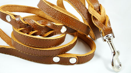

I am hoping someone could tell me how the dog leash in the photo I am posting is made. It appears the color on the back side is a white to cream color, and on the front it's some other color of pink. Is this two layers of leather glued together and sewn, or is leather actually available like this? If it is available, can anyone tell me where I could buy it? The color shown is just something I found on the internet. I'm looking for leather in a variety of colors. Thanks, Steve

I thought I saw a video of this somewhere on the leatherworker forum but it may have been somewhere else. Here is a picture of what I want to do. It's the braiding on the end of this leash. Thanks, Steve
