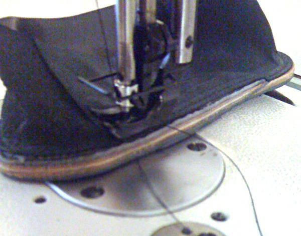

I wasn't really sure where to post this or even what to title it. But this is a technique I use sometimes when I need to transfer a pattern from design to an actual piece of leather. I also use this technique to transfer a tooled design to posterboard, then trace over wet leather. I first layout the design. I use my computer to draw almost everything I do. Print in a pretty thick line. Tape face down to posterboard. Burnish over the lines. I use a pencil so I can see what I've covered. Remove design. You should have a decent line on the posterboard. Cut out. Trace to whatever skin you're going to use. In this case, shark. Ready to sew down.

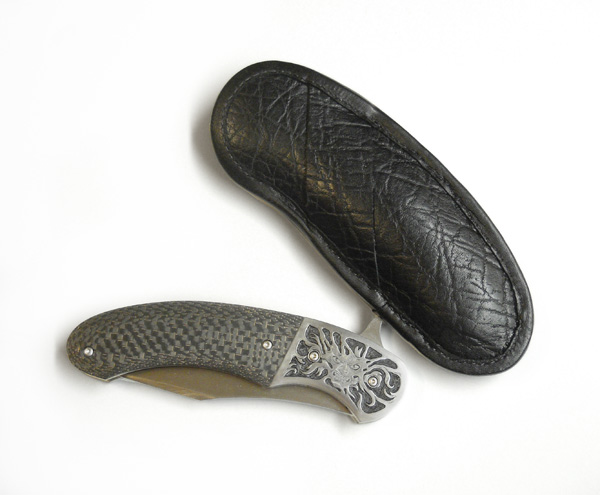

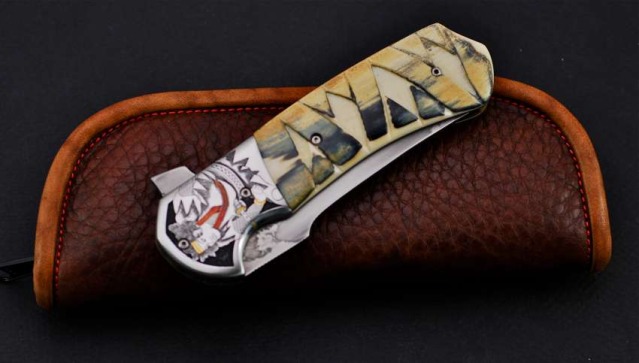

Thanks! Ya, I was actually thinking it looked like a sleeping bag. Thank you! The veg-tan is about a 4-5 oz. The shark is about the same thickness, and the elephant is a little thinner. The ole' Juki plowed right through all the layers though. Thank you! The knife is one that one of my dealers sent to me to have the sheath made. It is a Tom Ferry knife. Hand engraved bolsters, and lightning strike carbon fiber scales. It is a cool knife. KK -
One shark, one elephant, two cows. Front is shark with cowhide overlay. Back is elephant with stealth elephant belt loop. Interior is veg-tan cow. Bound in cow.

Not a dumb question. Fancy knives. This one is a custom colaboration between Mike Burch and Jody Muller. Awesome custom knife makers. -

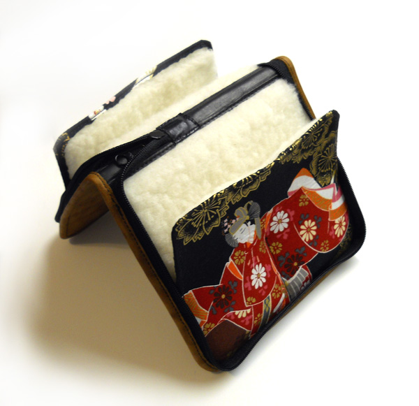

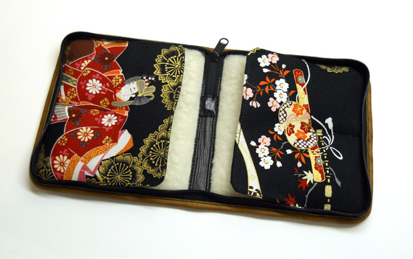

Here are a couple multi-knife storage cases. I'm calling this one the 4Banger. Brown lambskin, asian themed lining. The mighty 'V8' Black goat, black n silver asian brocaide lining. With baby brother Family portrait. -

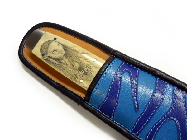

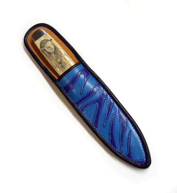

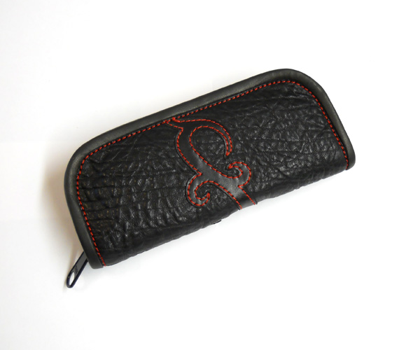

Here are a few single knife cases. Merino sheep with cowhide overlay. Bound in cowhide. KKL logo lining. Gator embossed cowhide, bound in cowhide. Blue bamboo asian brocade lining. Brown Cowhide, asian themed cotton lining Purple lizard skin, bound in cowhid, green contrast stitching. KKL logo lining.
