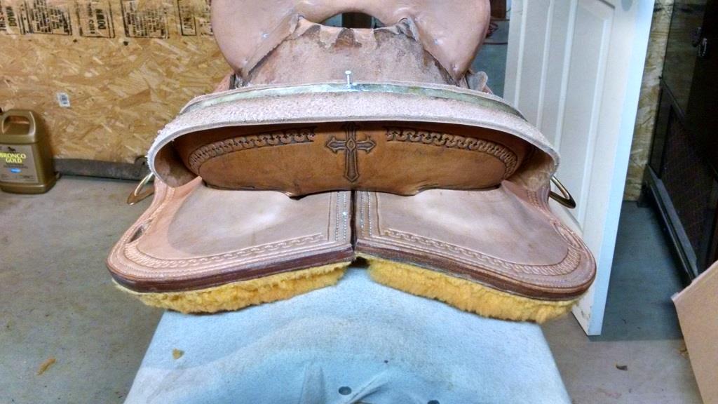

  10. I just finished this Will James that I started last July. Now I feel bad for asking Goldshot why his saddle took so long. This is my third saddle and I have tried to do something different on each one so I am learning something new. Lacing the swell cover was one of the new tasks. It’s a 15 inch seat on a Quality Mfg. tree. It’s Hermann Oak leather from Panhandle in Amarillo. Everything is hand sewn, but I have been looking for a machine. Some of my struggles along the way were documented in these threads and a couple others. Rigging Plates and Skirts: http://leatherworker.net/forum/index.php?showtopic=58791 I really struggled with this after I cut my skirts a little shallower than I wanted. I was ready to order more leather and redo them, but I got a lot of good advice for keeping them. I did change the rear rigging style which I think was a good decision. The original dees would have less movement than these. Plus I already had these dees that I didn’t use on another project. The rigging may be more prominent than some would want, but all in all I like the way it looks. Cheyenne Roll: http://leatherworker.net/forum/index.php?showtopic=57986 This was my first Cheyenne roll though I did finish the one on my wife’s barrel saddle before I finished this one. With The roll and cantle binding this one was five pieces of leather whereas hers was only four (the cantle filler wasn’t part of the roll). I think I like four better, but sewing this went faster than I anticipated. My daughter is coming home from college for the weekend, so we are going riding tomorrow. Critiques are welcome and expected. Number 4 may be a ways down the line, but I want to learn. Thanks, Randy

  13. I need some ideas/advice on attaching my breast collar dees. They can't go under the seat. Should I do something like this or incorporate them into my latigo/cinch holders? This is my last piece before oiling and assembly. Except maybe rubbing edges a little more. Thanks, Randy
