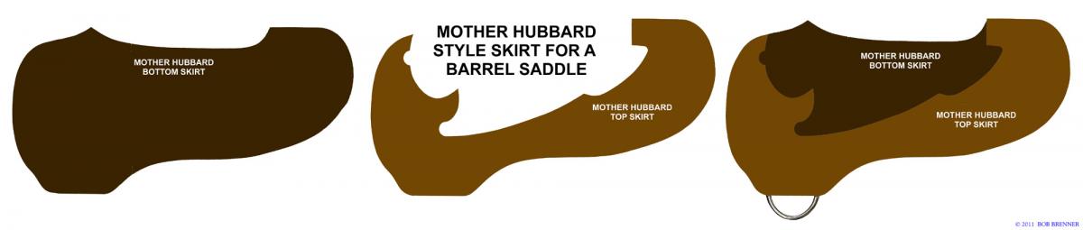

  11. Ron, It is probably hard to judge from photos, but if you put this one and the first side by side any sane person would pick this one. It's definitely a learning process and I still have a long way to go, but it's been a fun journey so far. Bob, I think it would be tough to get another half pound out of it and still have a decent saddle. I chose the Mother Hubbard style skirts/rigging because I thought it would be lighter. Given another chance, I would use rear jockeys. I think they would make the back look cleaner and be easier to build. Oltoot, I knew you were going to comment on the rivets and I don't doubt you for a second. In my defense, they aren't domed too much. I just tried to curl the edges some, so there is still a fairly flat surface. It may be a weak argument, but with the projected use and my young wife's age those rivets will be someone else's problem. I did plug around (probably 1.5" or so) and inside the rigging hardware, so that should wear fine. Thanks for all the comments. When it warms up some I will cinch it on a horse. Randy

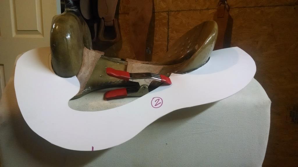

  22. Here's the status on my barrel saddle. There are certainly some mistakes, but most (as far as I know)seem fairly minor at this stage. I plan to fit the seat over the Thanksgiving break and welcome any input. I struggled with this on my first saddle and ended up doing it twice. So I am looking for some improvement. I think I fully understand the procedures of Jeremiah Watt and Harry Adams. However both of them are fitting on a Wade tree. Any tips for fitting around these swells? I really feel like my skirts were blocked good, but the top side of the bars are still more visible than I want. I am not sure I can do anything about this now, but tips for future efforts would be valuable. The seat will be rough out. Once the seat is fit and the cantle binding stitched, I plan to tool the swells and add the meandering cross border on the cantle binding. Then I will antique the swells, cantle binding and skirts. Once the skirts are finished, I can lace and install them. I like the way this saddle is coming together. It's been much easy than the first which makes it more fun and hobbies are supposed to be fun and relaxing. Any and all suggestions are welcome (even if I am not smart enough to use them). Happy Thanksgiving to everyone, Randy

  24. Keith, Thanks for the comments. I see what you mean about the seat jockey. That's my fourth version and it looks better than the first three. I didn't think it was egg shaped until I put it in place. I was actually trying to focus on how the three pieces go together. Point well taken on the rigging and the depth of the seat jockey. I am going to look at a lot of saddles over the next week and hopefully find the look I want. My fear it's that the saddle will end up looking long and skinny. However, that's the way the skirts are cut. I really appreciate the time you took to provide feedback. Randy
  25. Slowing down, breathing, and not cutting leather. I spent most of Friday cutting up beer cartons and making patterns. The attached pictures indicate where I stopped. I needed more beer cartons and decided that didn't go with cutting things. I should note that I am thinking about shortening my skirts about an inch in the back, but I am not cutting them yet. The rear dee is kind of high, but the rivets would not be on the tree. I am also thinking about cutting the skirts along the stitch line where the rear dee is located. I am not completely satisfied with the front rigging. The bottom of the plate is 5.75 inches from the tree bar and the center of the slot is about 5.25 inches down. Earlier suggestions (not on this thread) were closer to 6.5 inches. This means it should be dropped about an inch. My next concern is the seat jockey only partially covering the rigging plate at the front of the rear dee. The seat jockey could probably altered some to cover this or I may move the dee forward about a half inch. It was good experience even though I wanted to cut leather. It will be at least a week before I get back to this, so I have some time to 'stew' on it for a while. Any comments about flow, form, etc. are welcome. I really appreciate all the experience that is freely shared. Randy
